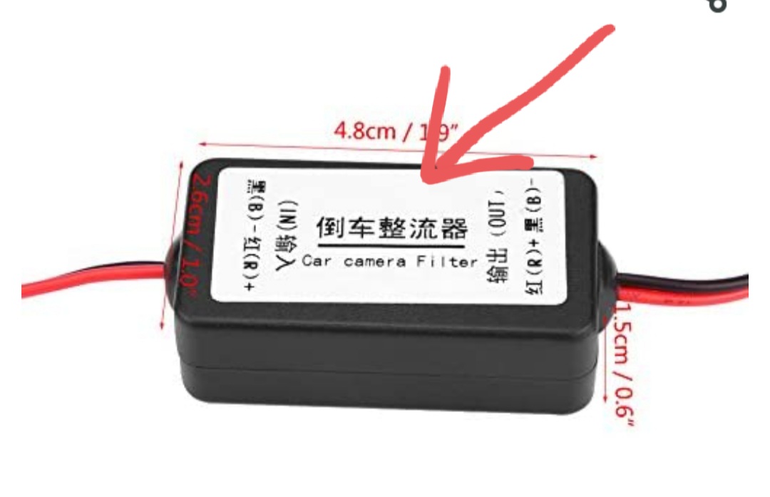

Nope it's all aftermarket - it has a 4.3 screen and the dealer claimed it cannot be activated for an OEM rear camera without a swap of the screen and stuff. So I didn't want to deal with that extra hassle - just an aftermarket camera and screen triggered and powered by the reverse light. Apparently voltage is a common issue on these, so hopefully the above will work.
What's that say? ?
Hope this works for you. Looks like it's the same as when you install aftermarket trailer lights. I'm curious now because I was looking at also buying an aftermarket backup camera and was told it would connect directly to the reverse lights.
18 hours ago, Armando G said:
What's that say? ?
The closest translation is "Reversing rectifier". I'm assuming it's just the literal meaning of the product name.
