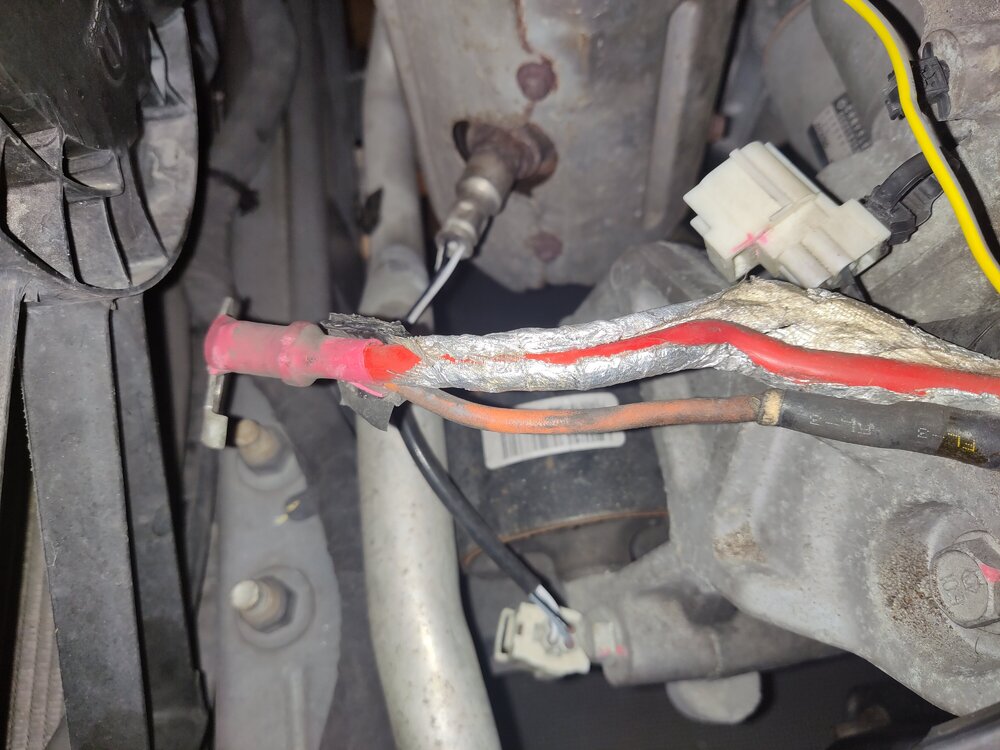

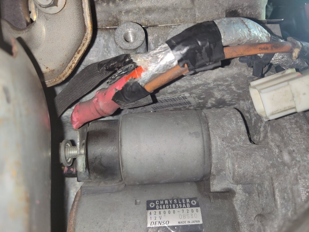

Dean H Posted May 3, 2025 Report Share Posted May 3, 2025 (edited) Something to be aware of- On the 3.6, there is the 12v battery feed to the starter from the tipm stud. Down on the the starter stud connection a cable splits off that connector. This is the battery feed to the alternator. In my picture the starter cable is the top red one covered in foil. The dirty orange one below it goes to a fusible link then to the alternator. I eliminated this mess when I upgraded to 2 gauge cables. Edited May 3, 2025 by Dean H Quote Link to comment Share on other sites More sharing options...
Locosiete Posted May 3, 2025 Report Share Posted May 3, 2025 (edited) 4 minutes ago, Dean H said: Something to be aware of- On the 3.6, there is the 12v battery feed to the starter from the tipm stud. Down on the the starter stud connection a cable splits off that connector. This is the battery feed to the alternator. In my picture the starter cable is the top red one covered in foil. The dirty orange one below it goes to a fusible link then to the alternator. I eliminated this mess when I upgraded to 2 gauge cables. Hmmm... I'm curious if i left mine on. I have 2 runs of 1/0 power wire from alternator. Been a few years since I did it and can't remember if I replaced or not Edited May 3, 2025 by Locosiete Quote Link to comment Share on other sites More sharing options...
