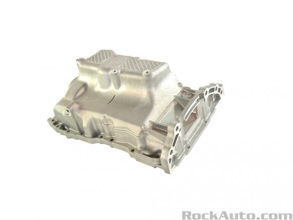

Super weird question: Does anyone know if the one-piece aluminum Pacifica oil pan is a drop-in replacement on the Journey 3.6? Only issue I can see is if they changed the oil pickup as well.
Let me explain: I'm having some oil temp issues towing. Started asking around on the Durango, RAM, and Jeep forums, and turns out its an issue with the 3.6. The coolant-based oil cooler just can't keep up when the ambient air temp is 85+ and the oil temp sllloooowwwlly creeps up to about 250. Which honestly isn't terrible for full synthetic. The issue is now with your base temp on the flats @ 250, then you hit the hill your in trouble.
So one solution is to go with a larger all aluminum oil pan, which they started using on the revamped 3.6 in the Pacifica. Unfortunately due to the plastic canless oil filter system, the typical $200 oil cooler fix won't work, so this is the next best bet.

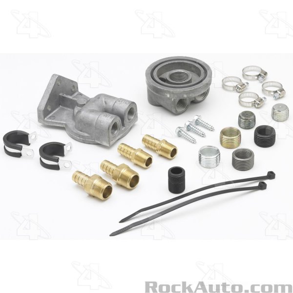

You would  have to add t connections on existing coolant supply and return lines on the vehicle, then feed into the ports on the external filter housing in pic. Some cars are build like this from factory. Quite a bit of work to ad on.

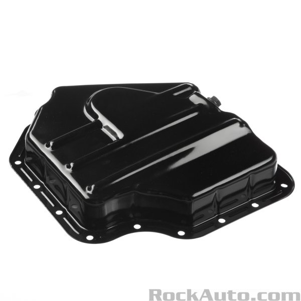

Not many cooling fins on the Pacifica oil pan. Some pans like one in pic from a Hyundai have tons.

The newer pentastar 3.6 has a lot of non compatible parts I have read. The new aluminum pan will not fit it sounds like.

A higher volume, two-stage oil pump is mounted to the lower front of the block and driven by a separate chain. As before, the new pump is electronically controlled for two stages of operation. The current and new pumps are not interchangeable.
The oil is pumped from a one-piece aluminum oil pan. The pan acts as an oil- cooler and adds strength to the bottom end of the engine. Trail-rated vehicles still use a two-piece aluminum and steel oil pan.
