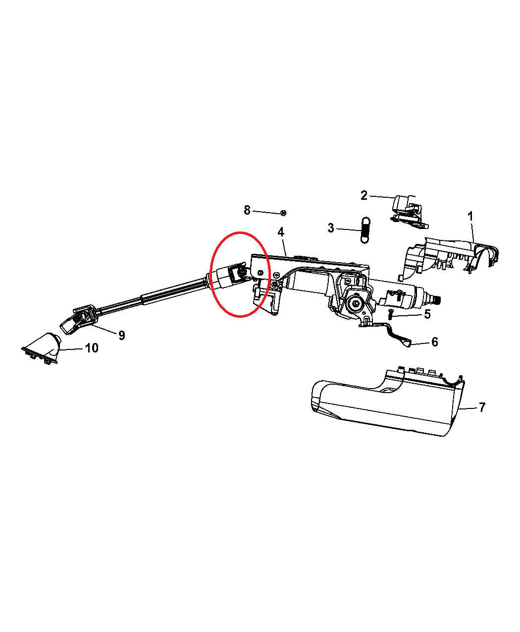

The noise itself is high up in the steering, and can be felt in the wheel itself. I grabbed the bottom of the steering column and shook it around but it was on tight, so i'm wondering if its at the joint higher up, as seen in this image.

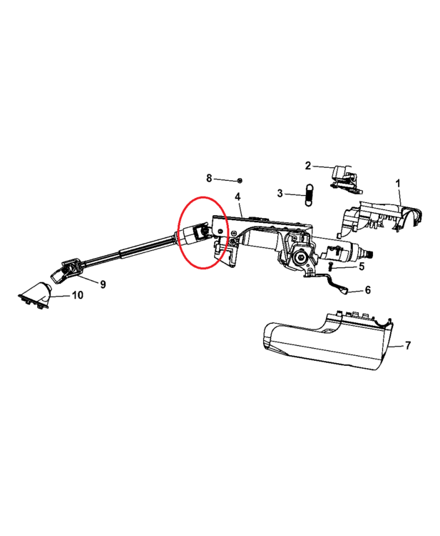

I changed my sway bar links, as well as my stabilizer bar bushings so that rules those out. But again this noise can be pinpointed right around the circled area in the pic. Wondering if there's any bolts holding the top portion of the steering column in place, that loosened up?
The shaft with both universals is called the intermediate shaft I believe.
I had to replace it on on my F150 at 200k miles. Needle bearing may have failed on upper universal, should not see significant play when steering is moved back and forth with car off. Pull back carpet padding at floor around shaft and look at amount of play in lower joint and compare to play in upper joint (asumming same style joint).
Its not a good thing that Rockauto lists the steering column assembly for this vehicle. They usually stick to moving items with demand.
Intermediate shaft should be sold separate as a dealer item only,  probably $300 ish with taxes,  hope I’m wrong.

Steering bolts probably installed with loctite. So I doubt it.
If it is intermediate shaft need to be careful of clock spring wire for airbags.
Seat belt wrapped through steering wheel so no turning more than 30 degrees during shaft change.
Not that difficult a job normally.

The steering column from Rock is so pricy because it has the whole intermediate shaft with it.
Here is just upper universal by itself, cheaper than I thought.
https://parts-catalog.moparrepairconnection.ca/catalog-2/itemdetail/mopar-parts/55351444ad

My F150 steering shaft had no rattle but huge amounts of play In it. It was obvious the universals has too much play, at 200k miles.
The shafts are designed in an accident to come apart and not skewer the driver. You have a few options to narrow things down.
Paint mark universal and rack mounting shaft; then remove the shaft from the rack and see if there is play or clicking when the rack is moved full lock to lock, left to right.  It’s possible sound is being transmitted into cabin from bad hydraulic rack unit.
Test dash universal by removing shaft and flexing by hand checking for noises. Steering wheel can’t be moved more than approx 40 degrees without possibly affecting clockspring wire that triggers airbags. Unhook battery and be careful.
