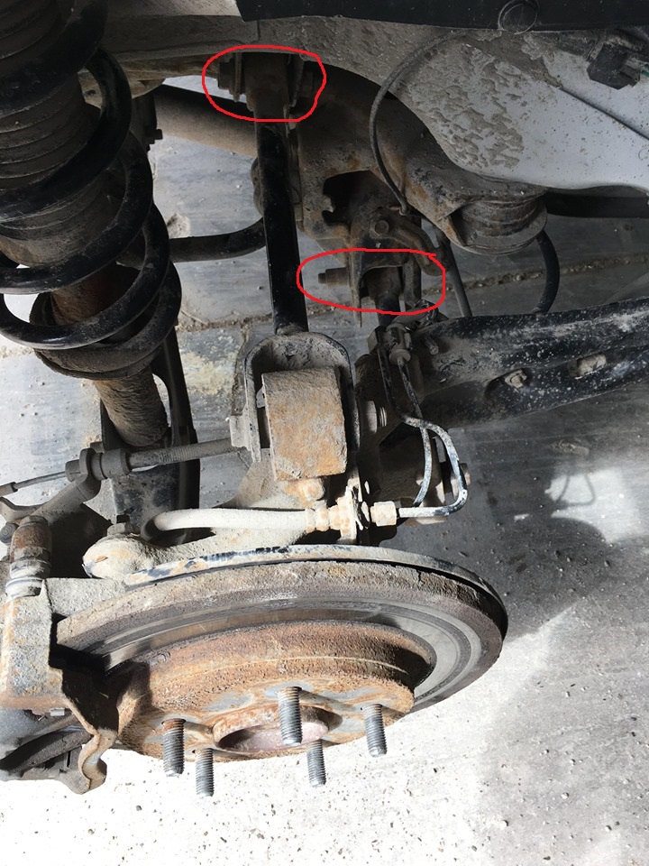

identify these parts please
assuming that is the rear upper trailing arm i had mine OEM which is NON adjustable replaced with an after market one which can be adjusted..Moog RK100119 Control Arm price from amazon is about 70 plus tax the other one i assume is the lower one
Looks like rear forward lateral arm.
https://www.rockauto.com/en/moreinfo.php?pk=7525384&cc=1447563&jsn=14&jsn=14
And rear upper control arm, adjustable is what people are recommending costs a bit more, $60 plus shipping.
https://www.rockauto.com/en/moreinfo.php?pk=8439460&cc=1447563&jsn=35&jsn=35
Plus the upper $7 bushing .
https://www.rockauto.com/en/moreinfo.php?pk=8438860&cc=1447563&jsn=462
Edited by John/Horace
would these be bad enough to cause bad rear tire wear? ive looked around thoroughly and doesn't seem like nothing else is really bad.. Could use new struts! When your behind the car and your looking at the car the rear wheels face inward like this   /     \    instead of like this   l    l
the upper trailing control arm is what was causing my rear tires to wear on the inside of the tires.... i kept having problems with the OEM part  as it is non adjustable, that is why i went aftermarket for the adjustable one since then no problems, i had them do both sides as well, and of courser you then ten have to have a 4 wheel alignment done....................
