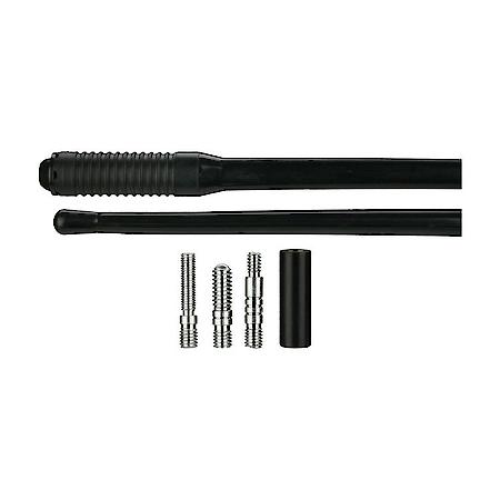

Dejourknee Posted September 2, 2018 Author Report Share Posted September 2, 2018 (edited) Basically I have this antenna and none of these adapters fit. I took the closest one and used the store display. The thing that looks like a black cylinder at the bottom is actually 2 additional extensions that don't fit either. . Just thought I would post this to let anyone else who stumbles on this, that if you see this antenna mast out there, none of these adapters fit a 2014 Journey SXT antenna base. (This is made by Metra, and while it looks like two pieces, it is one.) Edited September 2, 2018 by Dejourknee Added a return to make text wrap image better. Quote Link to comment Share on other sites More sharing options...

Neto Posted September 8, 2018 Report Share Posted September 8, 2018 Mine is a 2009, so not sure if it will be the same. There is a Do-It-Best hardware a quarter mile from my place, and since it's raining today, it's not hot. So I walked up. Metric thread. M5 x 0.8 on the 2009 Journey. OhareFred 1 Quote Link to comment Share on other sites More sharing options...

Olly Posted June 29, 2024 Report Share Posted June 29, 2024 I know that this topic is pretty old, but perhaps the information might be useful for people like me, who was looking for an antenna replacement for my Fiat Freemont 2014 by googling the net. I figured out that the antenna thread size is M6x0.75. Summer Solstice 1 Quote Link to comment Share on other sites More sharing options...
