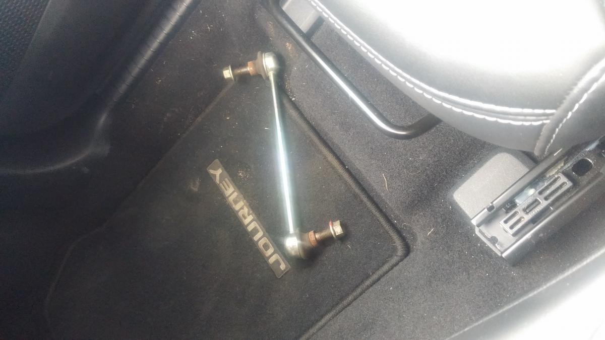

However I picked my car up to bring home until the parts arrive and found this. Was told its ok to drive for now. Man,,, my stories with this car just do not end.
Hahahahahahahaa
Classic dodge quality
7400 miles and parts are falling off

I do believe that is indicative of an incompetent dealer more so than parts falling off the vehicle. My first Journey went to 80,000 miles and I never had parts fall off of it. My current one is at 45,000 and no parts have fallen off of it. Not to say they won't, but I don't believe his issue has anything to do with "Dodge quality".
