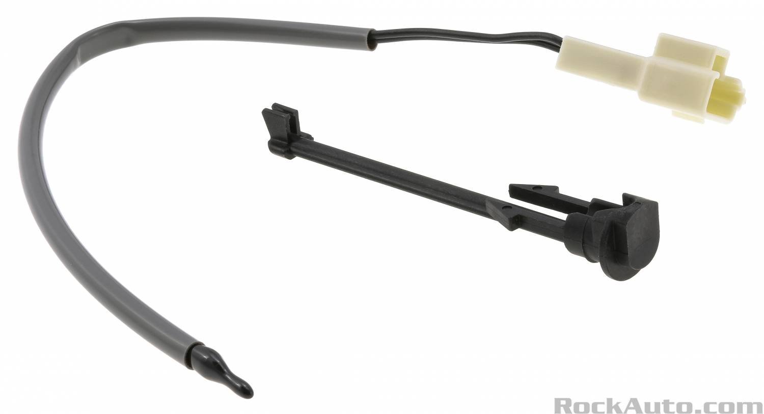

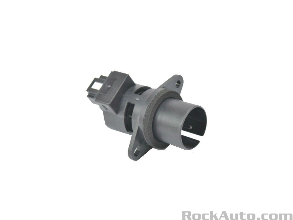

Yeah scanning for codes is the best start. My wild guess would be cabin air temp sensor( 55111178AD) or heater core temp (long wire style probe harness) sensor, neither are super pricy, although access might be crappy. You have parts car you can pull from still, so if ATC that would help.
Did this journey have the heater core swapped out ? If so probe could have been disturbed.
MR_55111178AD_Ang.thumb.jpg.517633f7e1b29bbd425a248f1843e2bd.jpg5S17045.thumb.jpg.82268277f983e122d64e009d23173a9f.jpg
