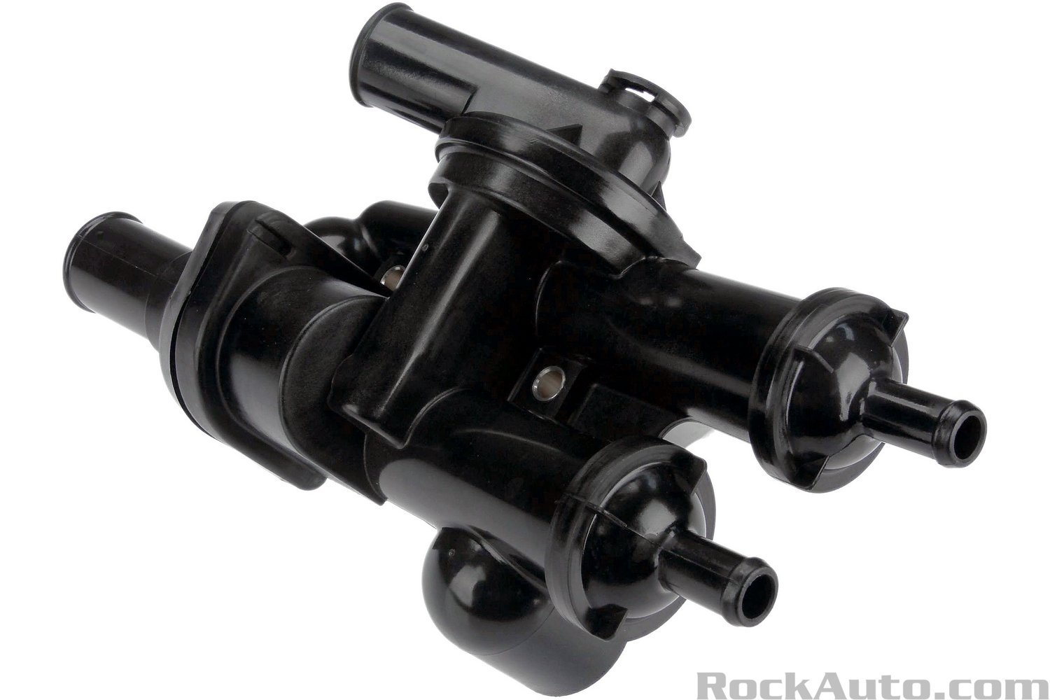

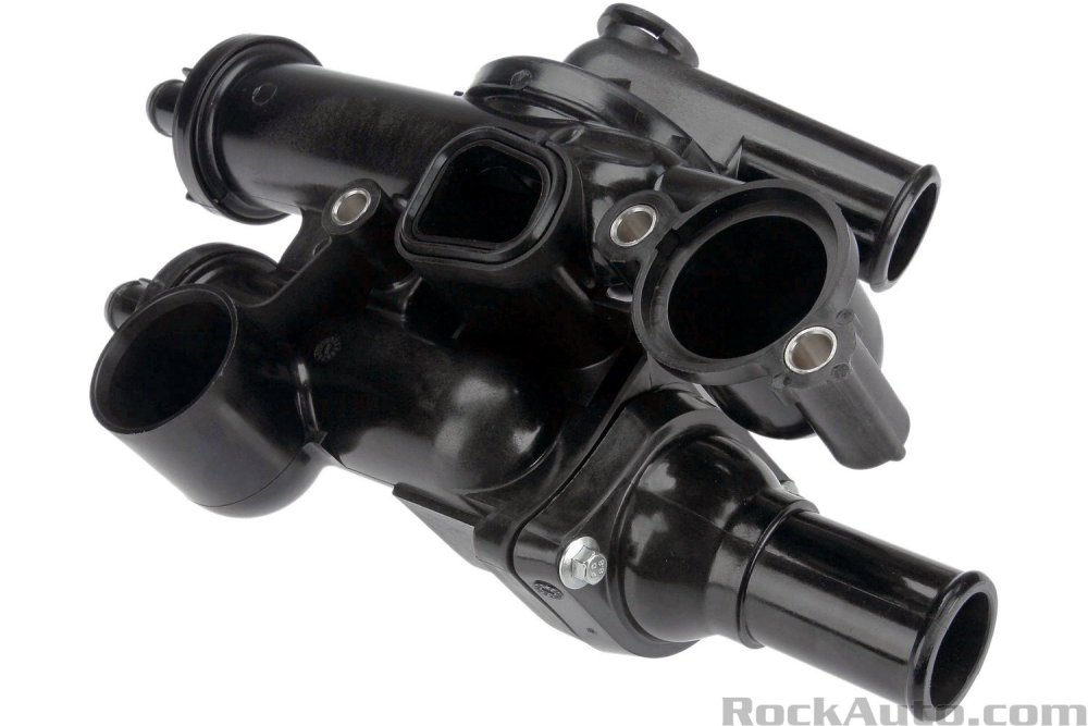

My daughter in laws 2.4 has had several glycol drips that had to be fixed. The plastic manifold on side of engine is a common issue. Gates has an OEM one that comes with new thermostat for cabin heat, and a few o rings. Not as well made as the more expensive OEM unit. If warranty try to make them use OEM.
A drip can evaporate and not leave much evidence, will eventually leave organge-ish stain that can be seen by a motivated shop. Temp sensor oring  on coolant manifold was last drip I fixed on a 2.4. A small drip will drop  level over a few days but not cause overheating. Pics of manifold. Head gasket leak is undrivable overheating, so not likely your problem.
CY0714523.thumb.jpg.c3bec9038470871b312f4174fd2ac320.jpgCY0714523_1.thumb.jpg.24d5e09e0e01ea7841d11f84339b3a9d.jpg

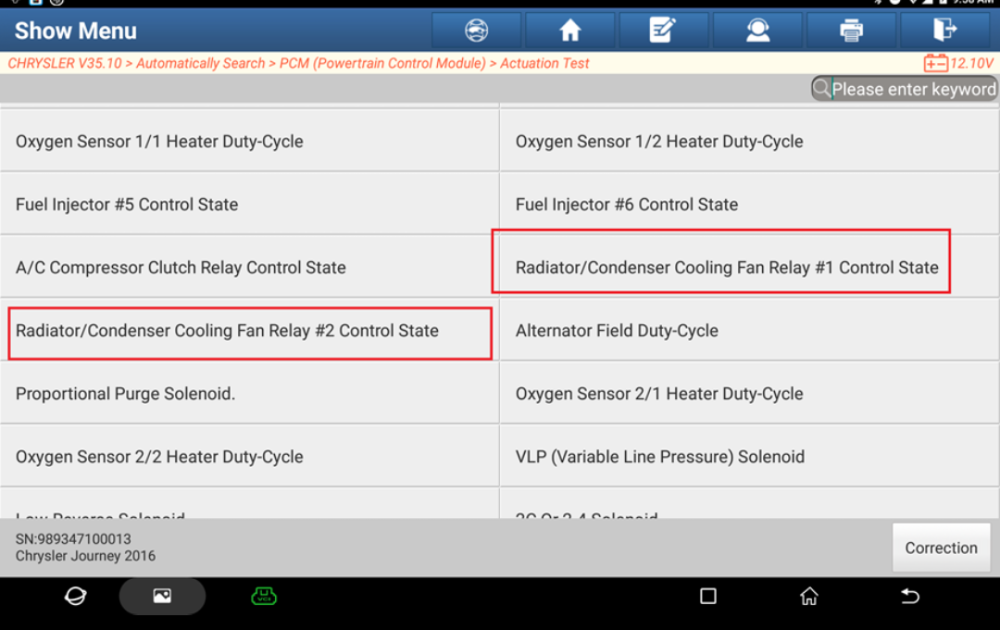

I would check to see if the electric radiator fan is working correctly.
If you can find someone with a bi-directional code scanner.
It can test the radiator fan high speed and low speeds.
If not, check does the radiator fan run when you turn the Max AC on?

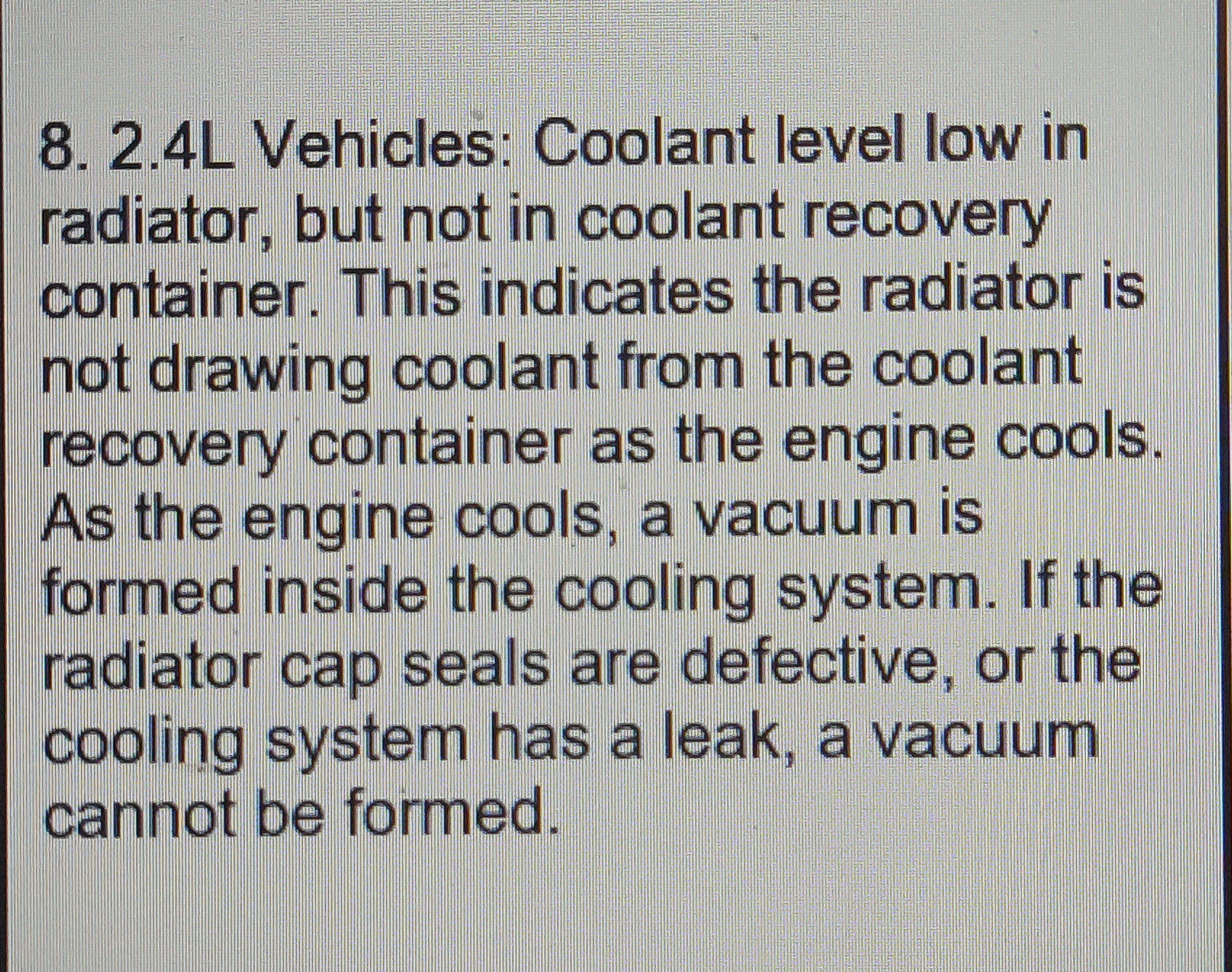

Replace the radiator cap.
(Engine cold).
Already did that, and we saw a little improvement. But still going low a little bit, not as much as it use to.
Awesome, Ill ask around asap and post back.
