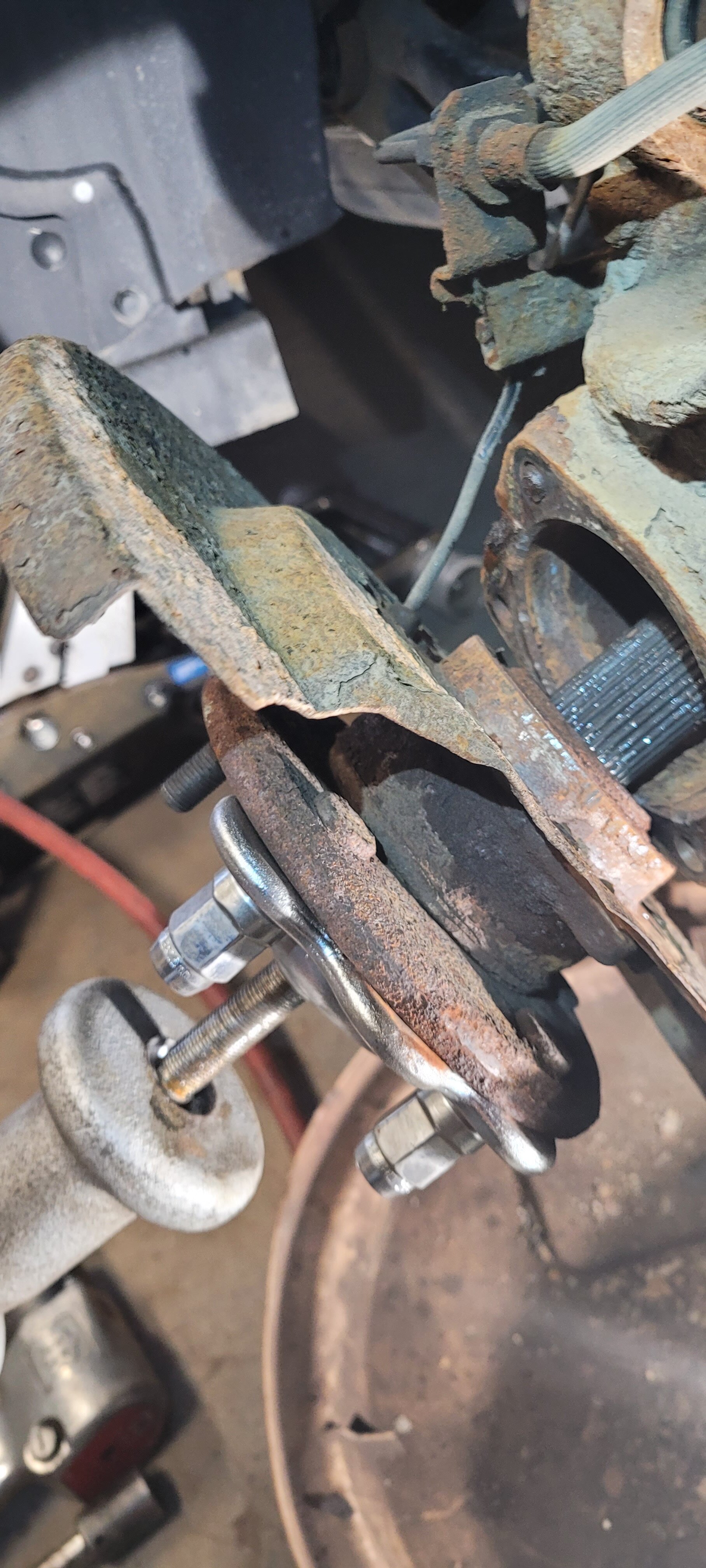

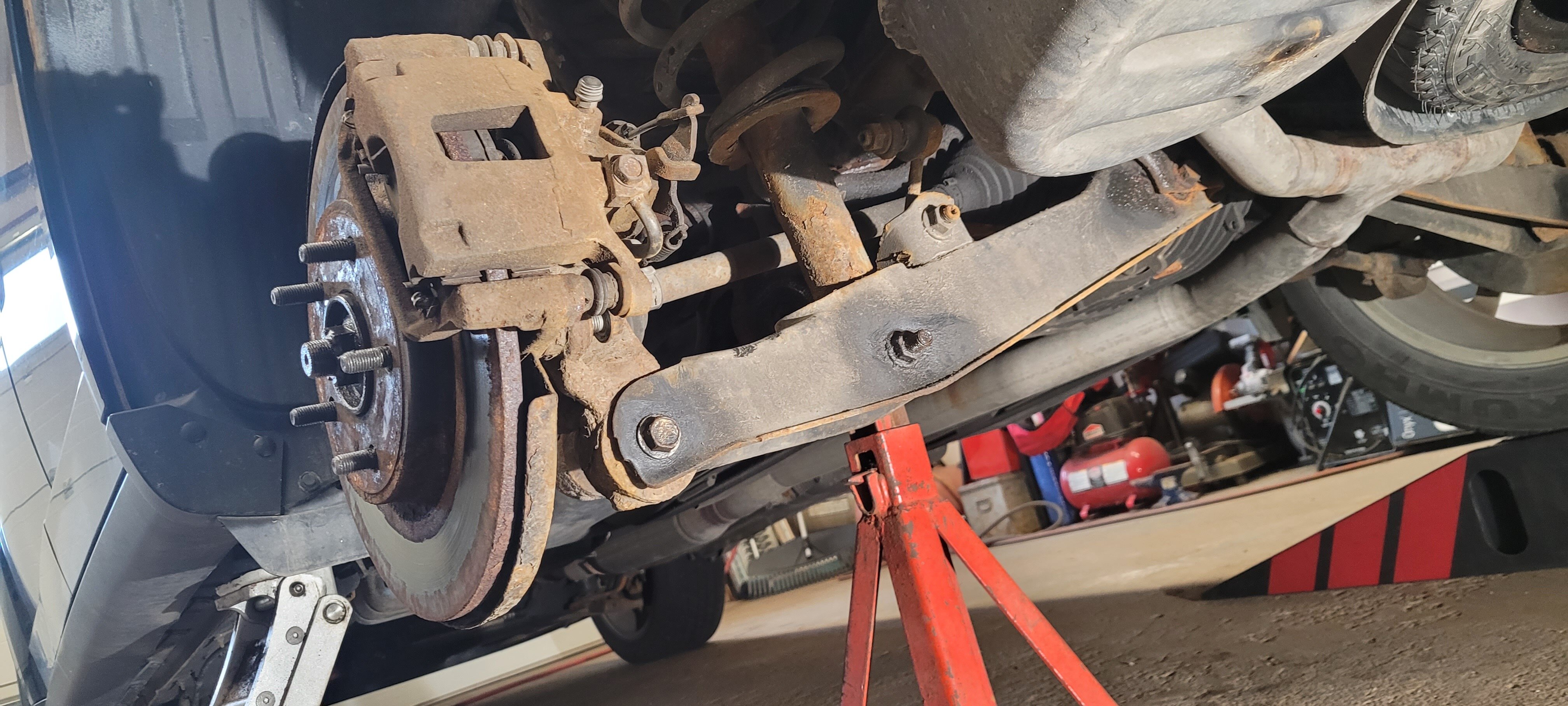

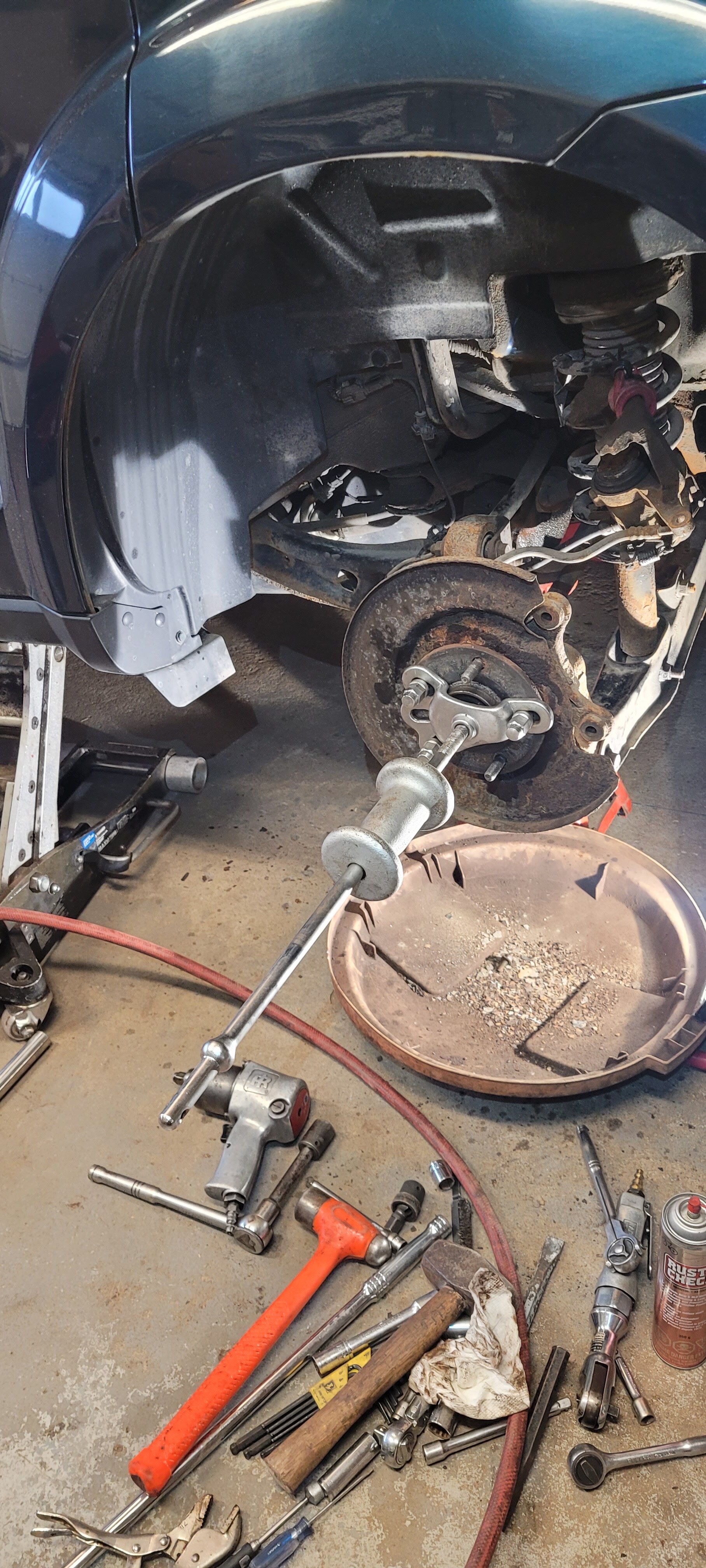

John/Horace Posted April 27 Report Share Posted April 27 In the salt belt, stuff like wheel bearings can be a bit of a bear. Even a Journey that was rust check sprayed 3-4 times like this one. If you are changing a loud bearing hub on an awd model. You can leave c/v shaft in place fairly easily if you have access to a sliding hammer. If diff lip seals aren’t leaking it’s easier/faster to not disturb things. Mine were already changed few years ago. Original bearing had 250k kms or 155k miles, not bad really for the crappy roads vehicle was driven on. 5rebel9 1 Quote Link to comment Share on other sites More sharing options...
