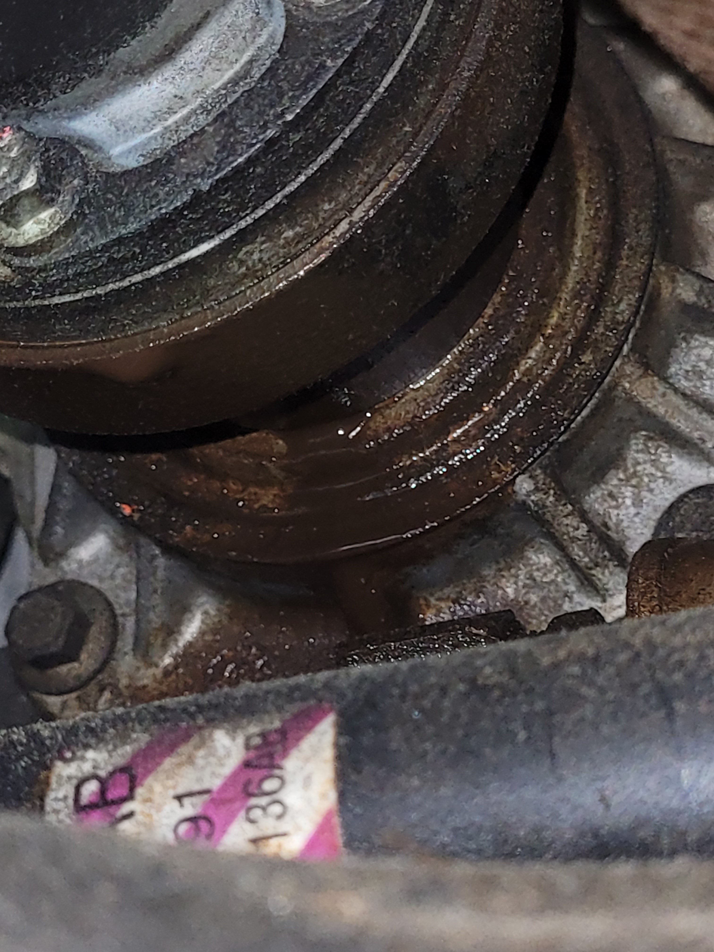

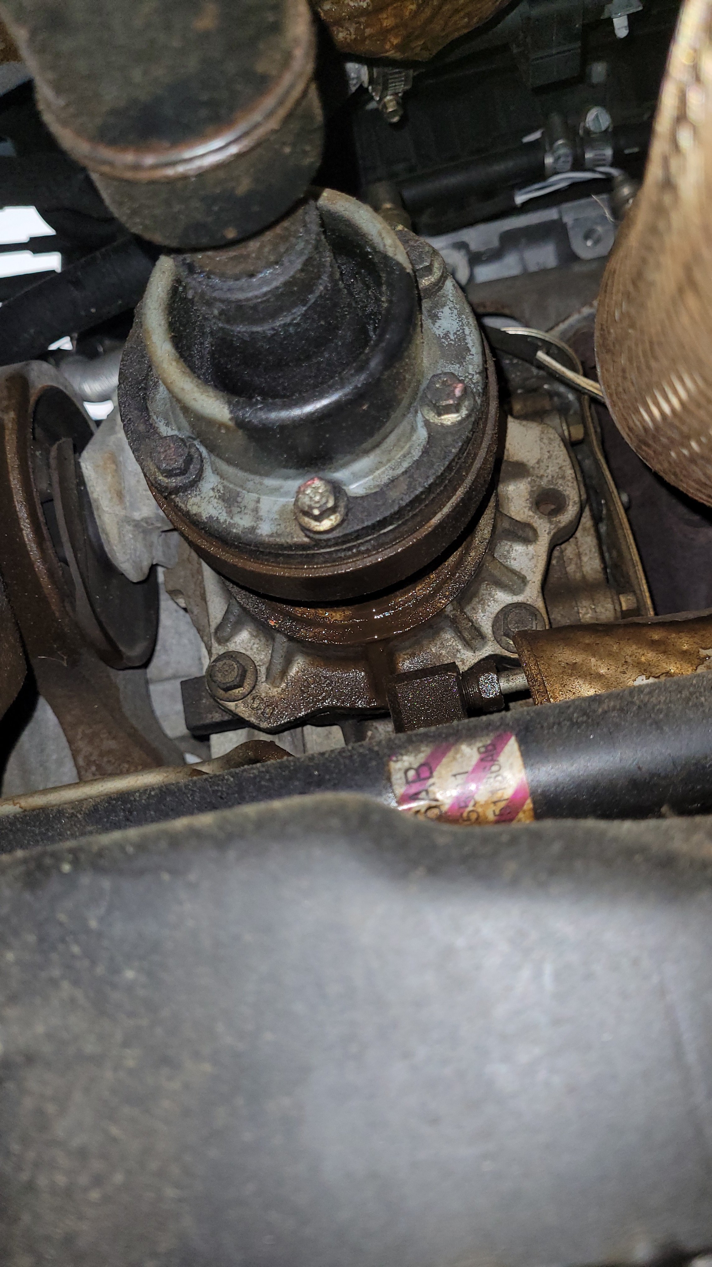

I have a 2009 dodge journey 3.5 Awd and i have been smelling gear oil.  So i crawl underneath and noticed that i have a leak. I can also wiggle it it has a lot of play. Can someone tell me if i need a new transer case or if a certain part needs to be replaced 20220501_135715.mp4
i would assume there is a pressed in seal there where the shaft goes in the case. most garages ( transmission shops or dealership, or even part stores ) or would be able to tell you that for sure, good luck i am sure someone with more advice will chime in soon with better info
Looks like output shaft lip seal is leaking.  First thing is to figure out if you have enough oil in ptu unit to keep driving temporarily until it’s fixed.

It’s obviously leaking from the seal, no video needed. The rubber can get old and brittle,  metal shavings and dirt can get into seal and wear it out
Don’t drive it until oil level is known, might get away with a seal if lucky.  If it’s fixed right away.

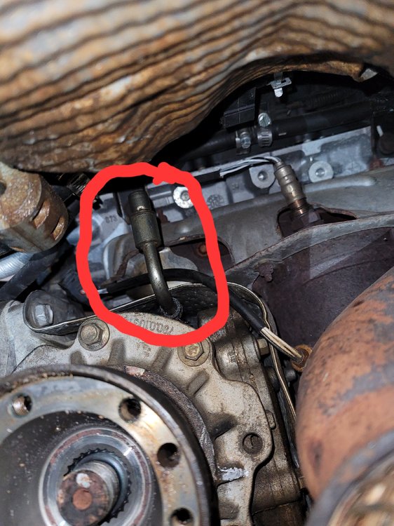

Vent is a black rubber hose with a plastic air vent cap on the end. Vent has a clip at top holding it to a metal bracket.
Can use a big syringe to force in oil through the 1/4” rubber vent hose that feeds into the ptu. There are posts on site describing how to do it on a 3.6 engine set up. The 3.5 should be similar.

Also, i dont know if the video uploaded but my driveshaft has play right where it is leaking. So with replacing the seal will it fix the play issue or will i need a complete driveshaft?
I can’t get clip to play on android or Apple.  Lip seal won’t fix play. Drive Shaft has to come off to install new seal, you will see if play is just in the shaft or in the ptu output shaft.
If it’s in the ptu output shaft, the bearings inside will need replacing. Lack of oil could have accelerated the wear.

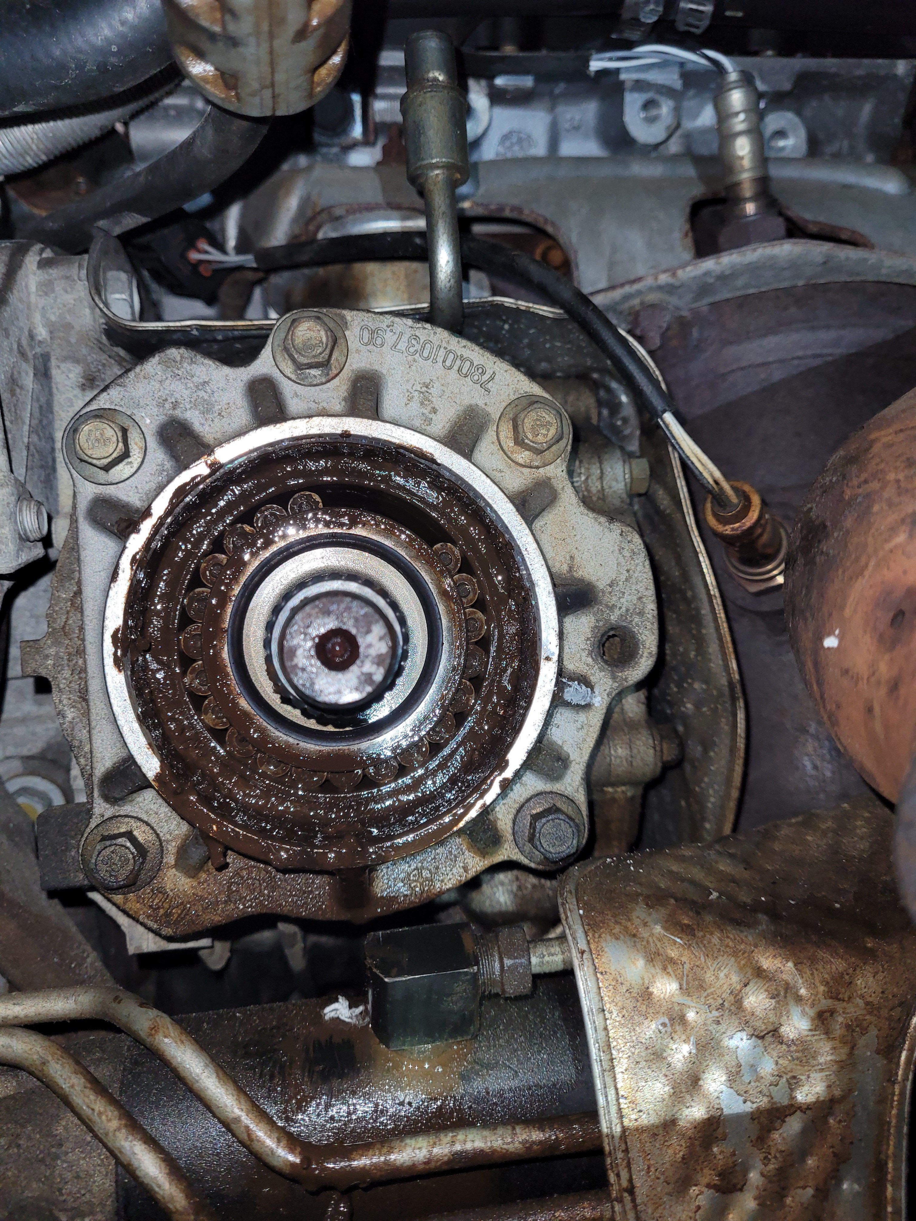

Well it looks like the play is in my ptu shaft.  I got the nut loose but cant seem to remove the cover to get to the seal. Also i still have found the drain plug. As far as the vent tube. I think mines is metal ?

Is it possible to just replace the bearings ?  I see there is bolts all around the shaft. Or is this ptu considered fried! ?‍?
looks like some of the bearings are missing as well
Ouch, it was run pretty much dry, some of the rollers are missing on that bearing in pic.  I’ll look for an exploded diagram, the problem is there are probably  several other bearings also damaged.
People usually source a used unit because it’s cheaper than rebuilding the old one.  Need to find out if 3.6 and 3.5 use the same ptu if you go with a used unit. Transmission shops do these kind of repairs. Very crappy news unfortunately.

The rollers is why i had play. Before i took it apart.  The driveshaft is fine.
My next step is to decide to keep it or just find a used ptu to replace it. I just know its going to be expensive ?
