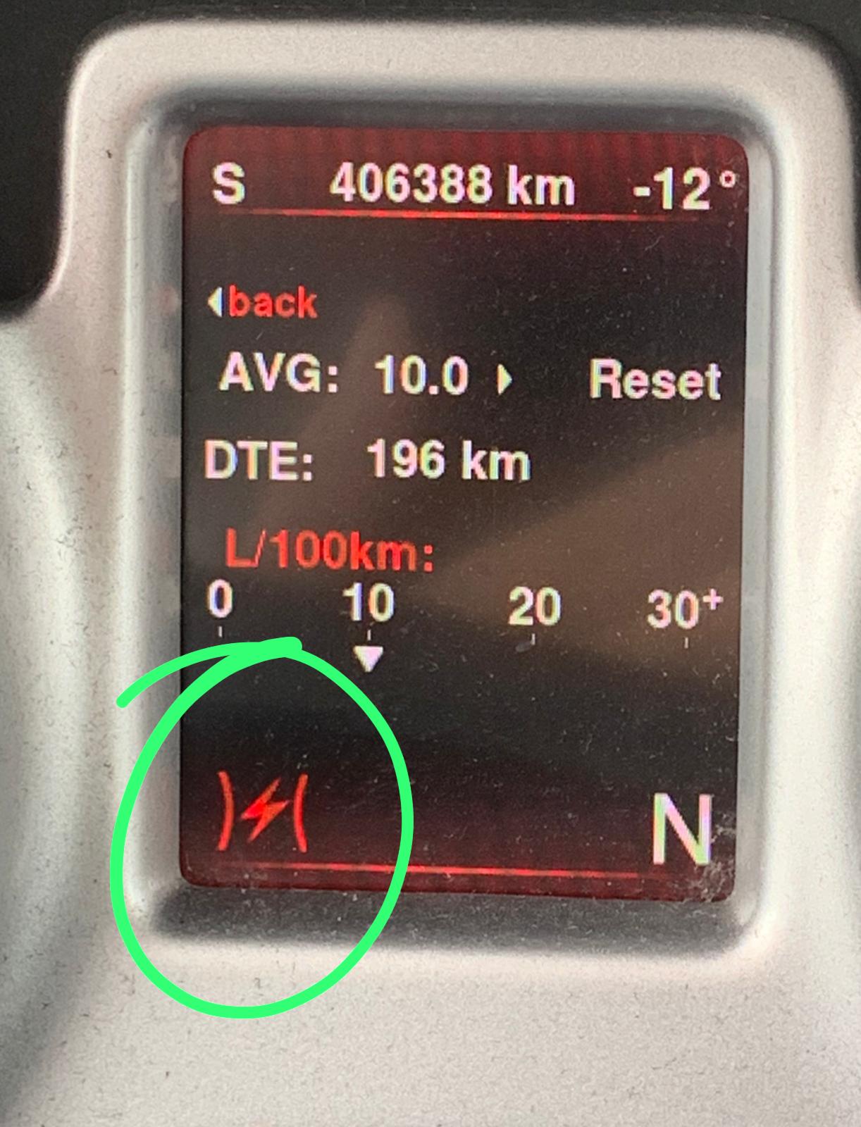

Hello, am new to the forums and require some help.. I have a 2015 Dodge Journey SXT 3.6 engine, my heater only heat while the car is idle but when I’m driving, it blows cold air, any idea what could be causing this to happen?
And sometimes it shows this electric symbol on my dash - see picture below B4F293FF-F8A8-4DB4-81FF-733D1FBF7AC5.thumb.jpeg.4554570cf5780b116f0eac728243663a.jpeg, not sure if that’s related.
thanks

Speedo  shows 406000 kilometres, just broken in now. I answered other post on lightning symbol.
