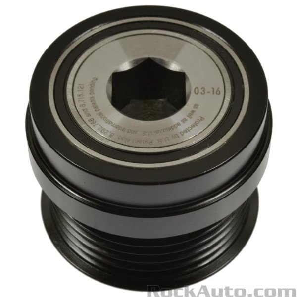

It's available, but takes special tools to R&R and alt has to be removed from the engine to do it. Also for the cost/labor. Would be better off getting a good reman alternator which will come with new pulley. We have similar personal backgrounds and I would suggest the whole unit if you have around 80k miles on it.
Thanks for the advice, Special tools are not an issue for me but the time to pull the alternator just to change a pulley would have me leaning to replacing the whole unit considering the Journey has 105,000 on it. Now the issue is finding a good reman, there are so many crappy ones out there and a lifetime warranty doesn't help if it needs constant replacement. I like to do thing once and have it go a while before repeating the process.

https://www.rockauto.com/en/catalog/dodge,2014,journey,3.6l+v6,3300354,electrical,alternator+/+generator+pulley,2448

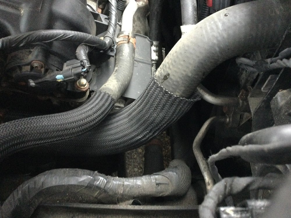

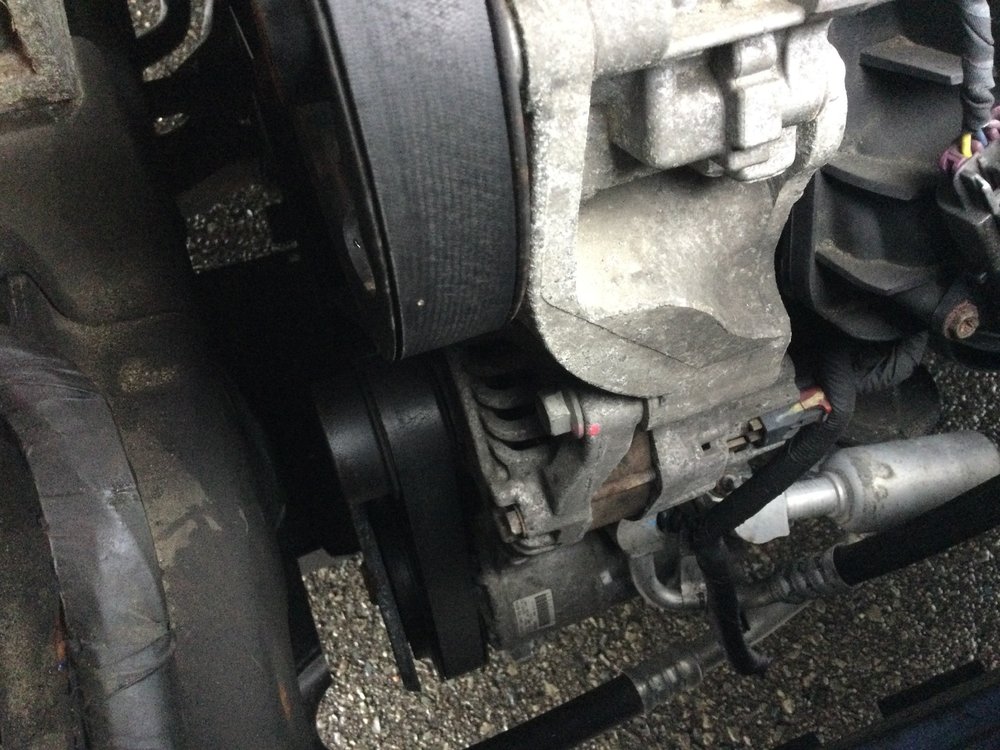

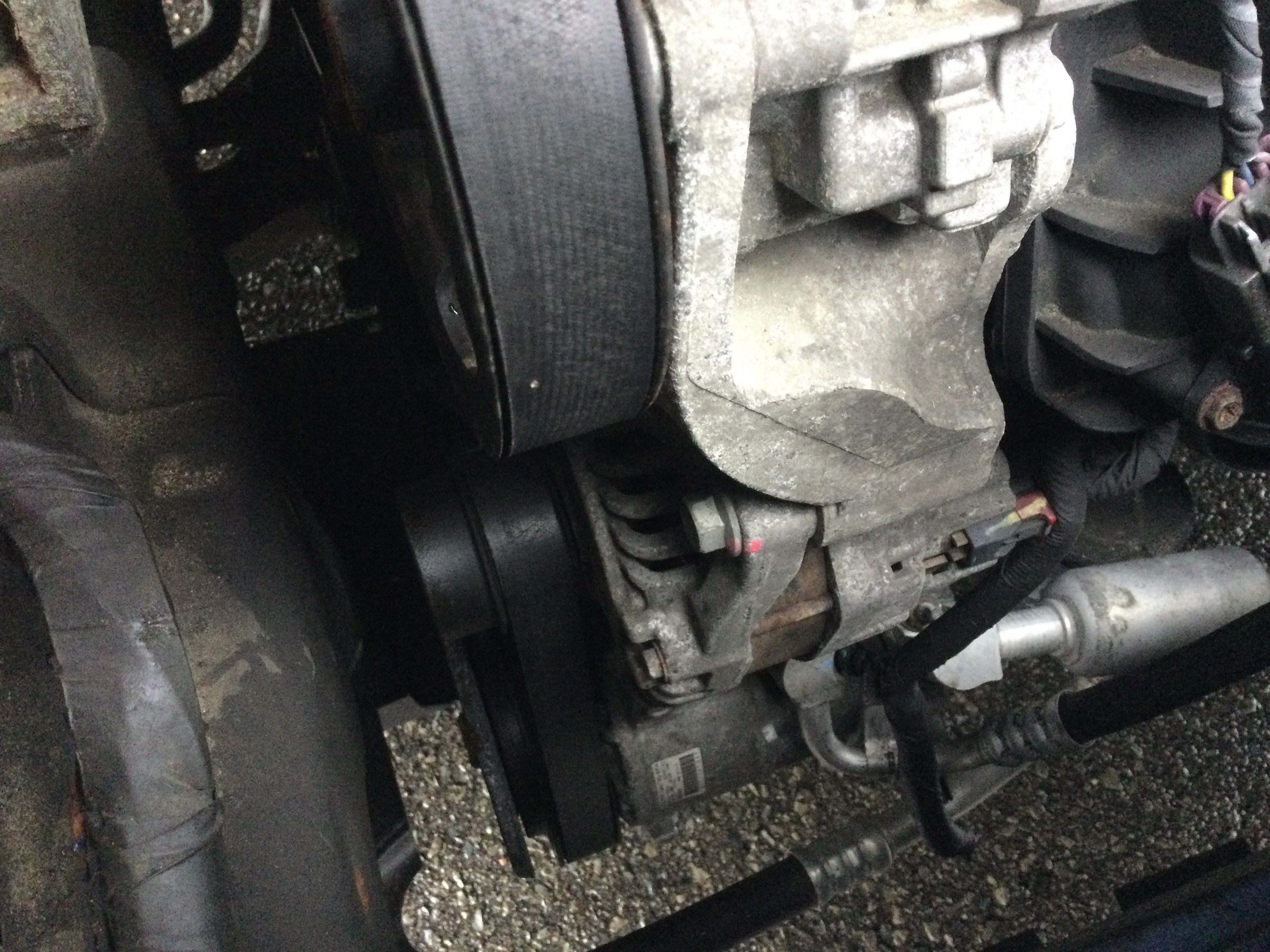

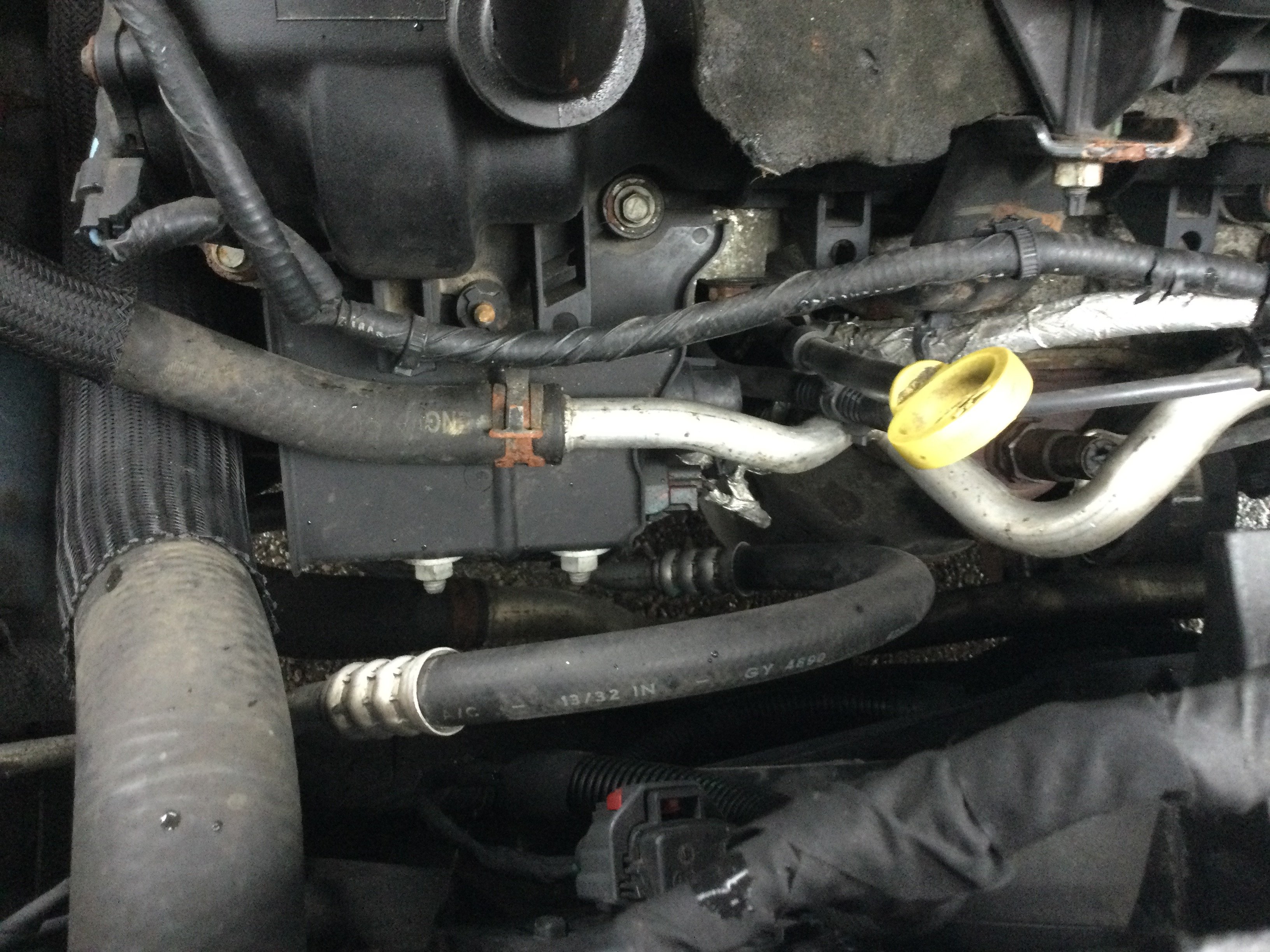

The factory alt is Denso brand. A very good manufacturer of car components.  Some dealers stock reman units at competitive price. Maybe parts store with tool loan it program will have the removal kit. It’s around $100 ish for whole thing on Rock for a Gates set. Removing alt is not a difficult job really, around an hour when I changed it on my wife’s 3.6 engine. Have to dump glycol to get hose out of the way. Removing pulley in place doable but awkward. My 2 cents.
Here is wife’s 3.6 engine, the alt has the plastic cover held on top top studs with two nuts. That cover was added on all models by FCA in 2015 I believe. Prevents oil or glycol from contaminating alt assembly. Alt will only come out through bottom easily.  But clutch pulley is not against frame rail, so changing just pulley I think would be a lot easier than the 2.4 engine. On 2.4 if the engine mounts were partly removed and engine raised from below, you could do the pulley with alt still mounted in place.  On both alternator changes I think it’s easiest to remove the closest surpentine belt  idler pulley for more room.
