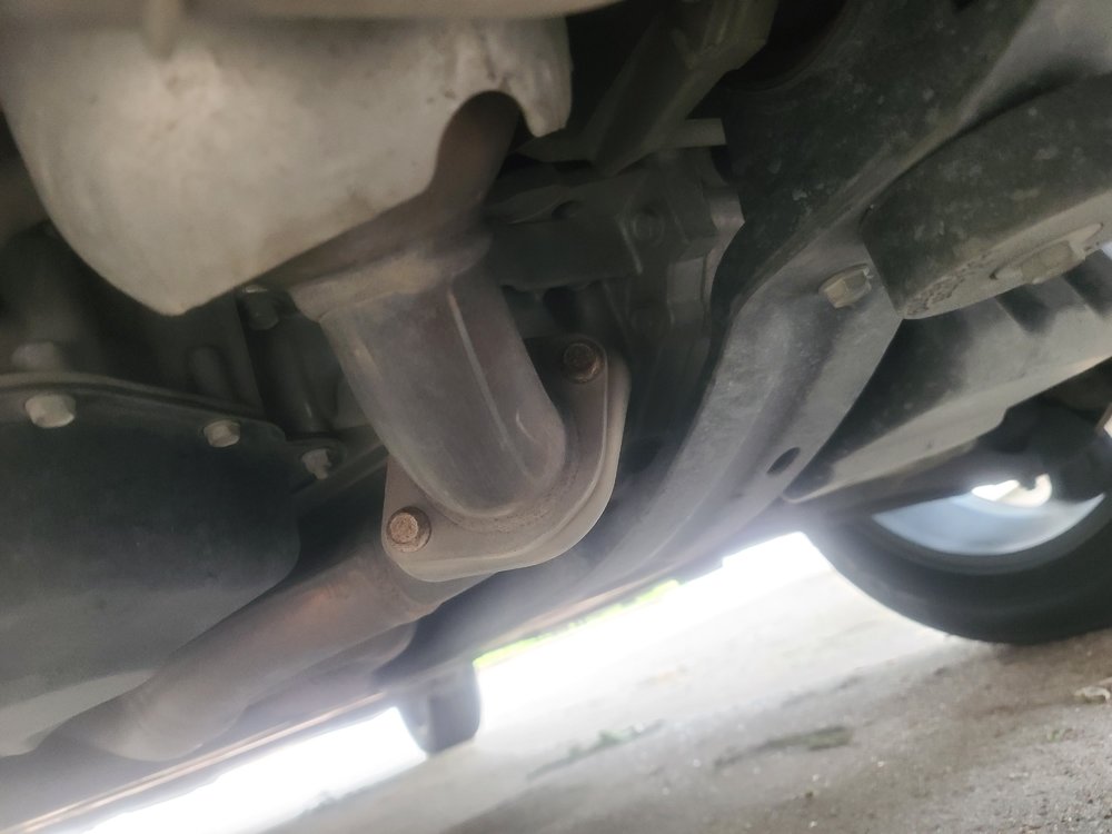

I think it is strange that it doesn't make the noise when I'm in reverse.   Also I noticed the attached piece is not lined up evenly and there is a space between the 2.  I try to stay in tune with my vehicles.
I think your referring to the upstream catalytic converter in picture. It’s bolted to cylinder head on one end, exhaust manifold is integrated into the head. Either heat shield or flange bolts could have come loose. Normal slight movement of engine makes parts bang together. Warranty should cover it
