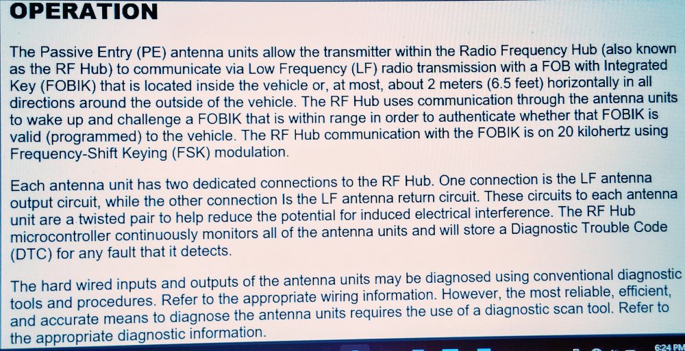

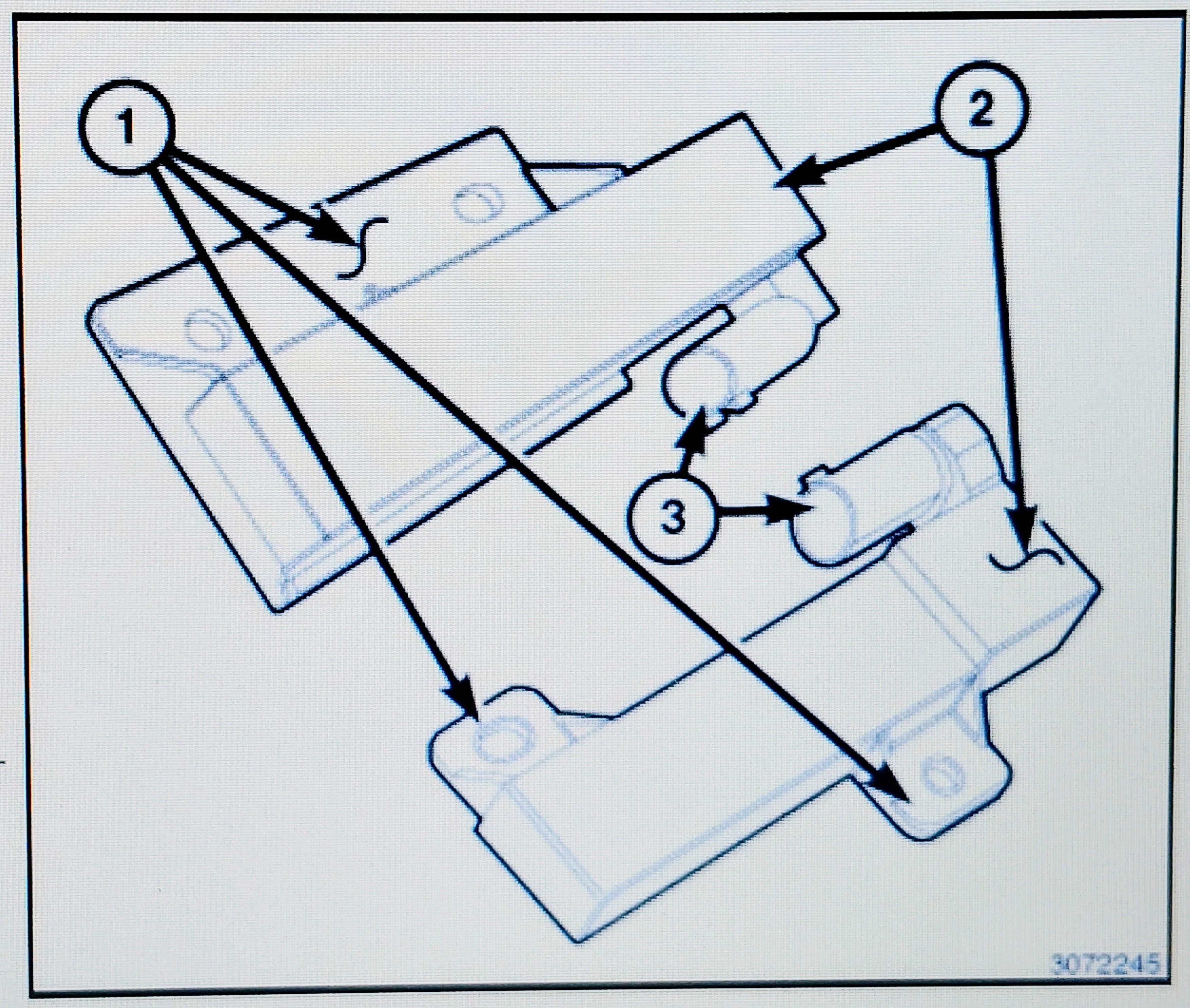

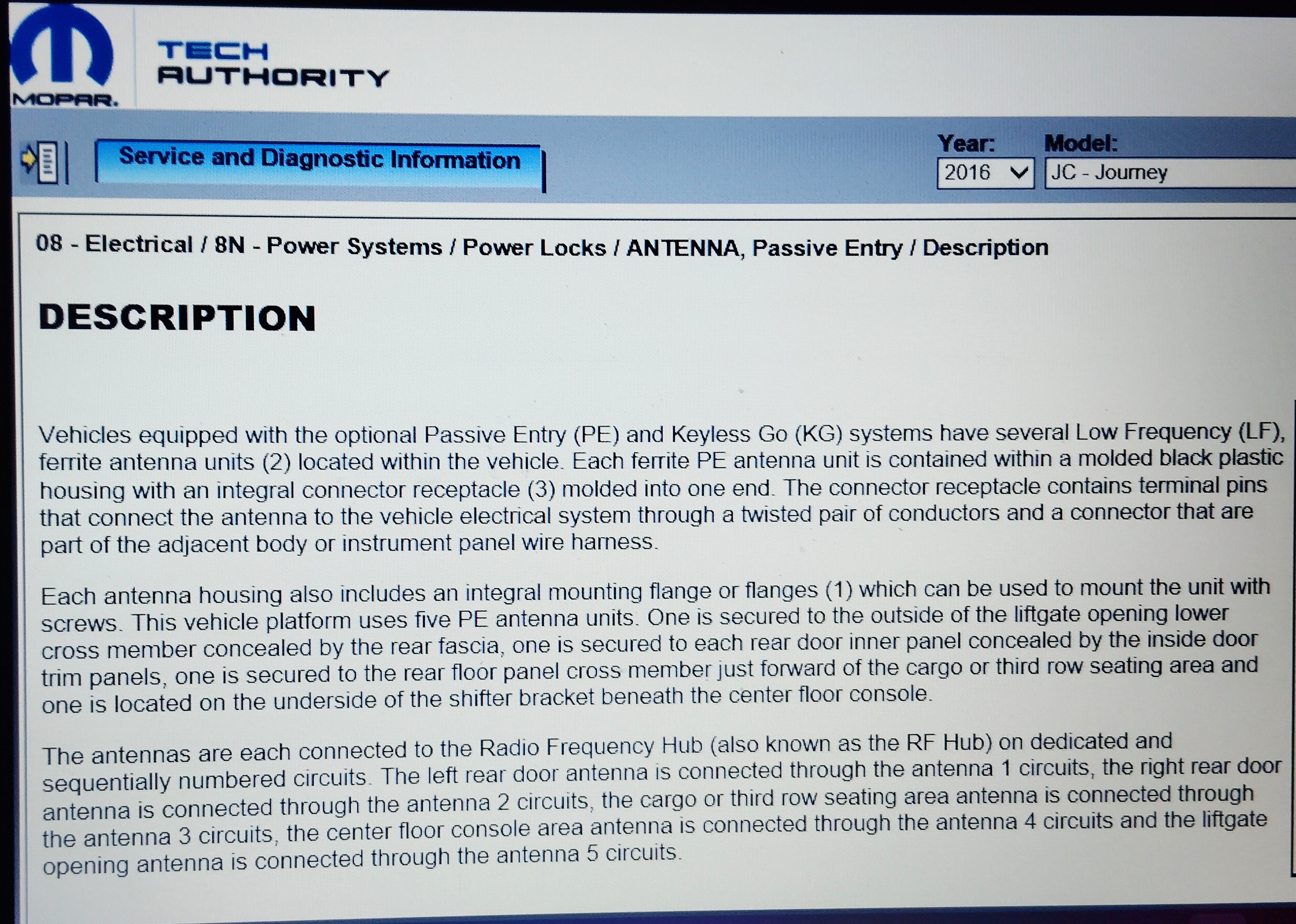

Dean H Posted August 23, 2025 Report Share Posted August 23, 2025 (edited) This the location and the operation specs of the antennas on the 2016 DJ. Edited August 23, 2025 by Dean H Quote Link to comment Share on other sites More sharing options...
