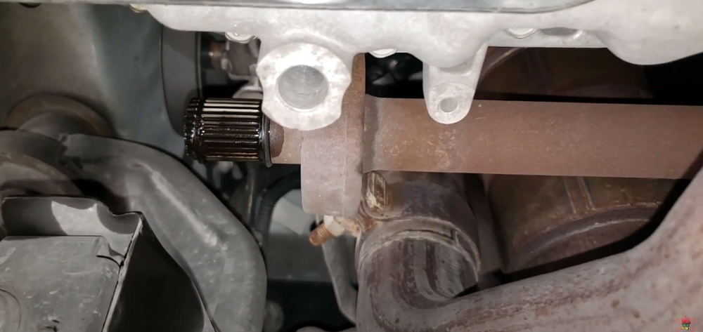

Would a cv axle or even an intermediate shaft vibration come and go though? Again it seems to go away/get better while driving it. If I lived in town I probably would never notice it because the vehicle would have a chance to warm up by the time I got to the hwy. But I live on the hwy so I'm going 0 - 100 km/hr from my house to my work. And on brand new pavement so I notice it a lot more now. How would I diagnose that? Remove the cv axle, then grab the intermediate shaft and try to wiggle it side to side? I believe this is the part here eh?
The "carrier bearing" of that shaft (just in from the splined end) is a common weak point on all the various models that share the same drivetrain(the vans, Avenger,200,sebring). You should be able to move the shaft around and "feel" see movement from the shaft IF it's bad. Otherwise, the front motor mount is very known for going bad on these same vehicles mentioned for same kind of symptoms you post of.

Wouldn't it vibrate all the time, if it were an axle/intermediate shaft?
Not necessarily. depends more on torque loading conditions of driving to feel it as you describe. You've been given much the same opinion by 2 different members...try doing the checks and don't overthink the situation.

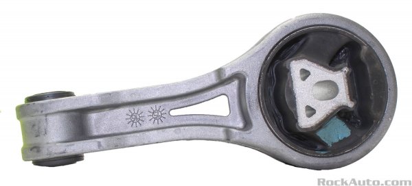

Rear mount is only one that’s cheap, it’s really a roll stop more than a mount.
Look if rubber has separated from the metal casting. Your milage is kinda low for a mount, but it’s possible.
https://www.rockauto.com/en/moreinfo.php?pk=10195836&cc=1502335&jsn=680&jsn=680
That mount is for the 2.4L engine. I priced out the 3 engine mounts and 1 transmission mount, and it would come up to about $230 shipped. The side mounts I can do myself. The front and rear I may get my mechanic to do. From what I'm hearing, it's the front and rear engine mounts that are changed often on this suv
When mounts are bad you can usually see too much movement. The rubber flex has torn away from the metal bracket part of mount.
Try to get your hands on the new part some where where you can get an idea of approx how much play there is when in normal condition.
