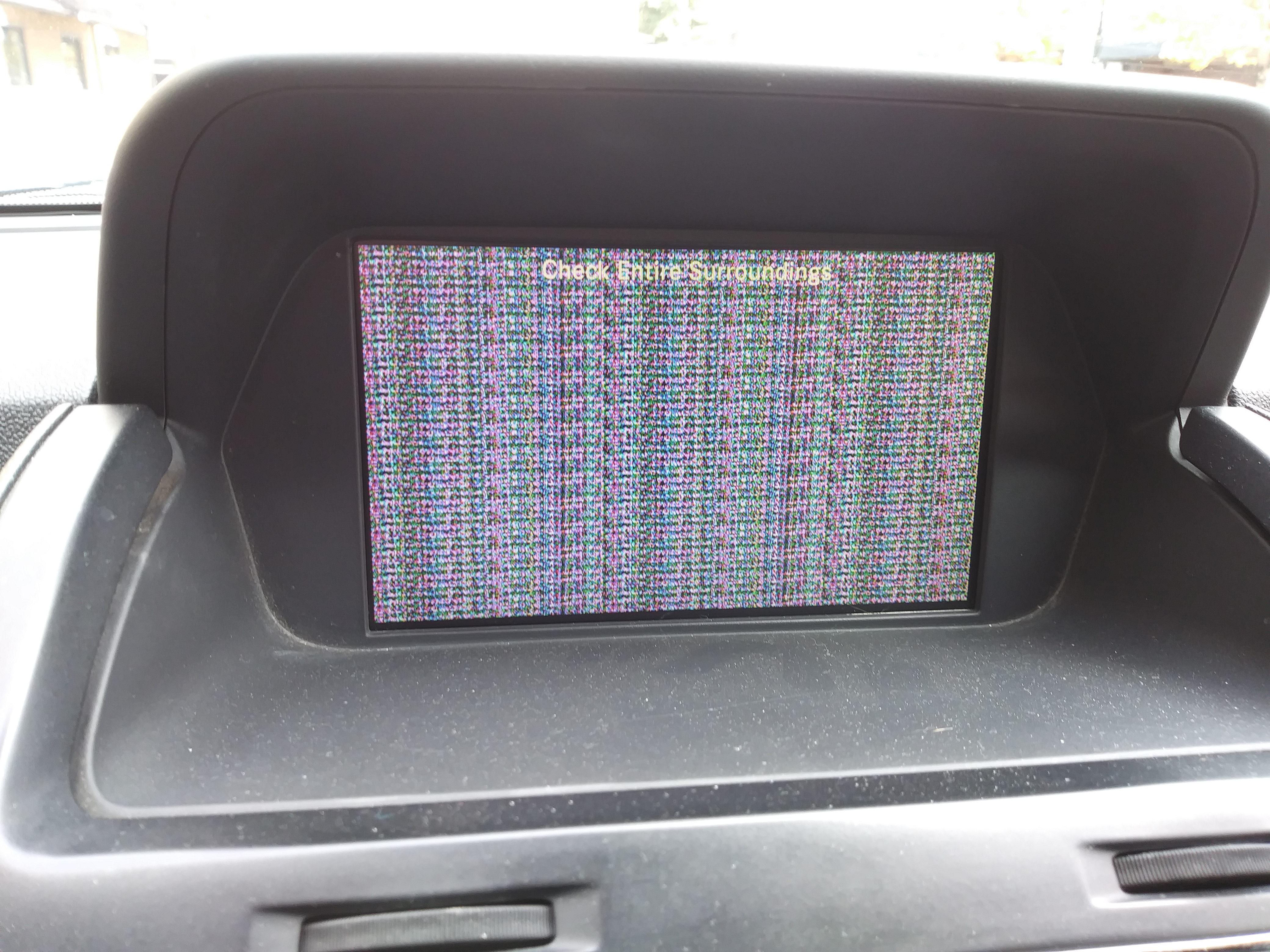

William Burke Posted November 4, 2019 Author Report Share Posted November 4, 2019 The rebuilt TIPM works great, just required a little programming! Quote Link to comment Share on other sites More sharing options...
2late4u Posted November 4, 2019 Report Share Posted November 4, 2019 what was your problem and symptoms that the TIPM was able to fix? Quote Link to comment Share on other sites More sharing options...
William Burke Posted November 4, 2019 Author Report Share Posted November 4, 2019 Drivers side door did not activate dome lights, door locks, back up cam was acting up with sometimes worked, sometimes scrambled image. 2late4u 1 Quote Link to comment Share on other sites More sharing options...
