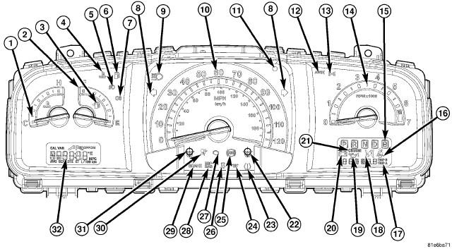

Yes that thumbnail looks the same. I have uploaded my dash
According to what it looks like to me, pushing button 31 (from my posted pic) is supposed to change the display which is 32, and bring up setting or units and should allow you to change it there. I am having a hard time confirming the exact sequence though. I would try pushing the button until you get to the one you want to change then push and hold in until it changes. Or push and hold it in until it changes and then push it without holding until it changes it to what you want. I am sorry for not being more exact but I do not have access to the manuals for the vehicles over there. I normally don't try and answer these types of questions when I am not sure but I figure its worth a shot since it sounds like you cannot get the answer anywhere else.

I see you have a 2009 SXT as I do (Canadian model here), to set the temperature from Celsius to Fahrenheit and vice versa press the left button in the dash below the speedometer #31 in the above diagram, whatever readout you are displaying will change to one temperature or the other by holding the button down until it changes then release, as you have noted all readouts will change to the new setting, metric all readings in metric, Fahrenheit all readings in U.S measurements.
