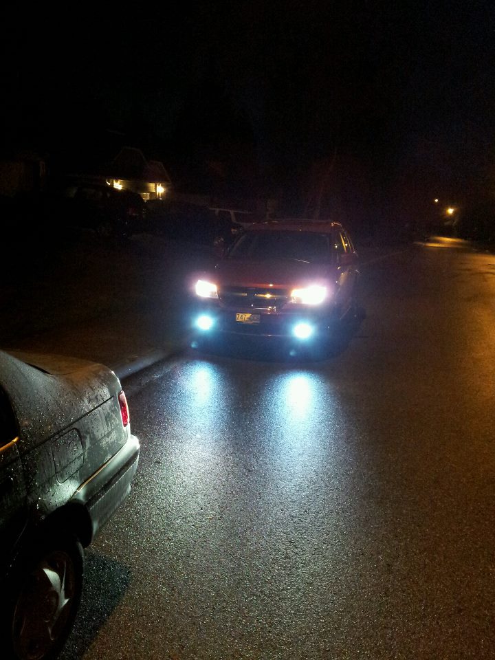

Hi everyone, I just installed some LED fog light bulbs to replace my incandescent ones in my 2010 Journey SXT. I got them on ebay for $2.50 each, and just thought I would share with everyone the results, and where to get them.
Headlights: Low beams - 9006 Super white 55w incandescents (Ebay, $5.50 for pair)
High beams: (not pictured) 9005 super white 65w incandescents (Ebay, $8.00 for pair)
Fog lights: 18 SMD LED super whites.
I don't want to be spamming links, but just go to ebay and search. I was pretty impressed for the couple of bucks I spent.
post-2725-0-63042900-1333126787_thumb.jp
I took a gamble after a lot of misinformation regarding these bulbs and sizes and different ones, but the ones I put in were H16 bulbs. They initially didn't want to fit, after a little fiddling, I took an exacto knife and shaved down a bit of the plastic guides on the plastic housing on the bulb itself... went right in no problem.
