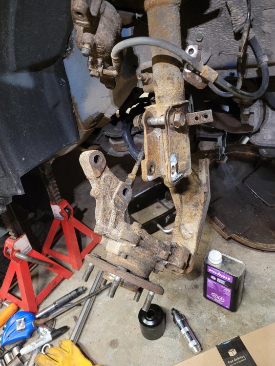

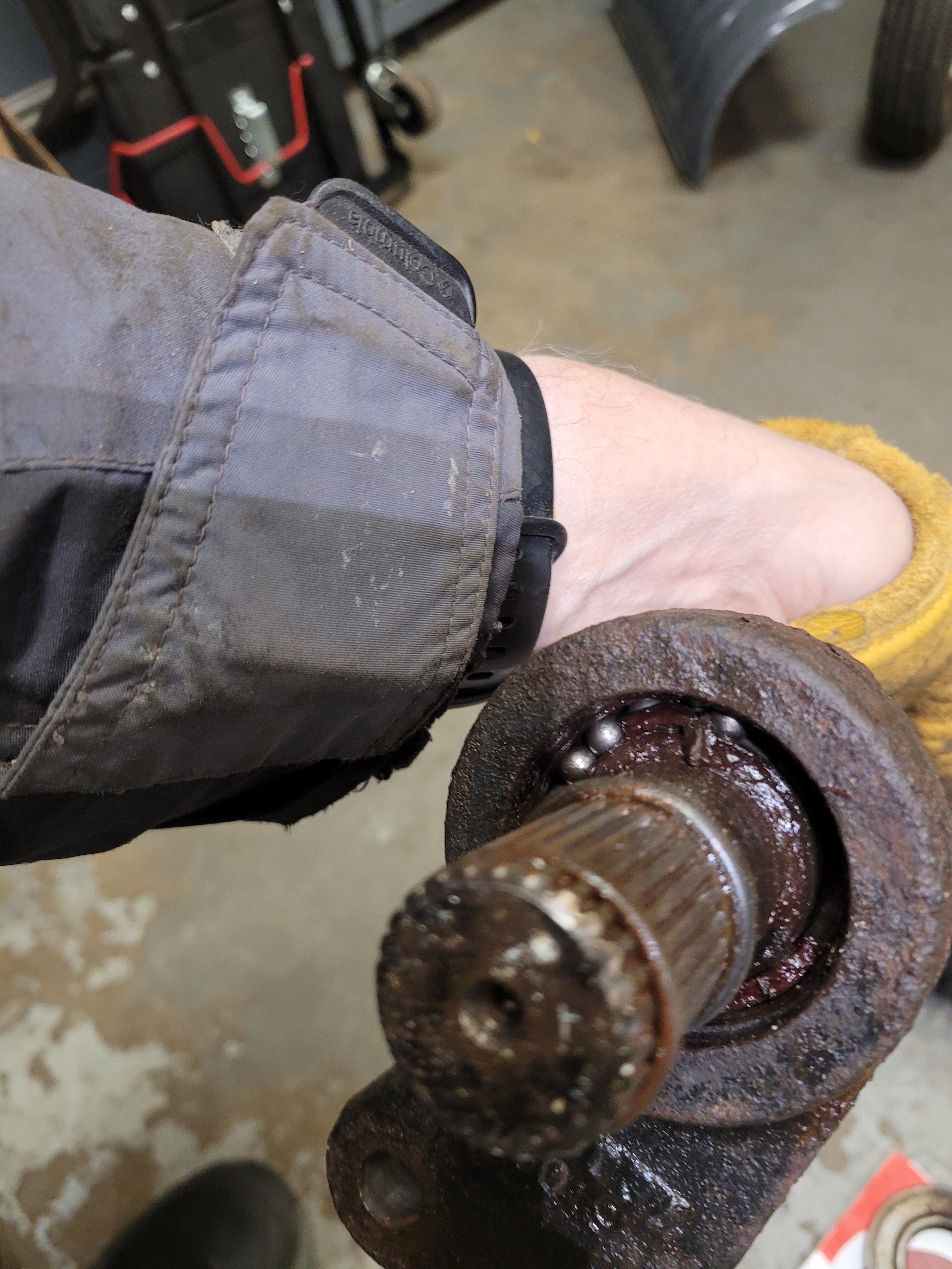

Was doing an oil change, noticed passenger side intermediate shaft bearing was looking bad.  Side Seal was flopping around and a few ball bearings were missing. Also transmission output oil seal was starting to drip fluid. Around 175k miles, so not unexpected.
Dealer had the output seal in stock, but shaft was on back order...and very pricy. Heavy item for shipping so rockauto not a great option, local part store had one in stock.
Shaft came out ok, but knocking in output seal squarely not easy. Had a small drip after assembly was finished. Tapped seal in farther and added bead of gray rtv around perimeter; let in dry 24 hrs. Seems ok now.  On a hoist it would be easier to do this repair.
