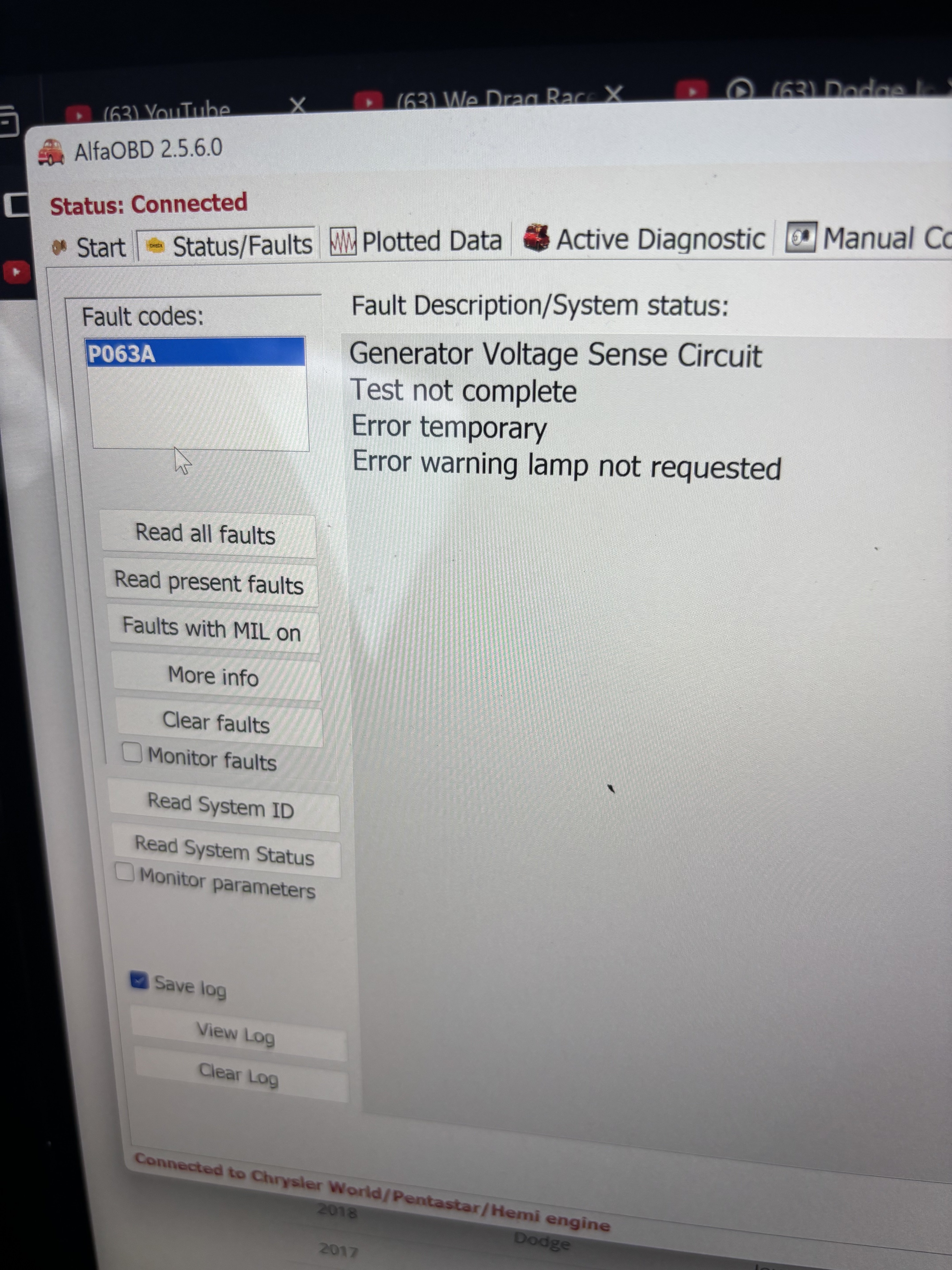

 Thanks for the reply! I will get the battery and alternator checked. I have attached the fault codes from AlfaOBD. Its when i scanned the steering column control module, it gives me the C212AIMG_9214.thumb.jpeg.4e94ddd6eb6300ae7a8e3e77904ddb2d.jpegIMG_9213.thumb.jpeg.4f585d173b63e4096e1a52ad08fa5629.jpeg

So i got the battery and alternator checked at my local part source store. Both are good and working as they should. Also checked all ground connections, they are all clean and free of corrosion. Not sure what the issue is then. Contemplating of just sticking a piece of electrical over the light and call it a day lol.

So, fixed the battery light issue. Alternator was bad. Pulled one out of a journey at the local scrap yard. Paid 50 CAD for it. Battery light issue gone now.
However, Trac Control and ABS still on at cold start. After 30 mins of hwy driving, it goes away after i cycle through the ignition. The traction control alone will sometimes appear on idle but none of ABS or trac control light will turn on while driving at hwy speed.
