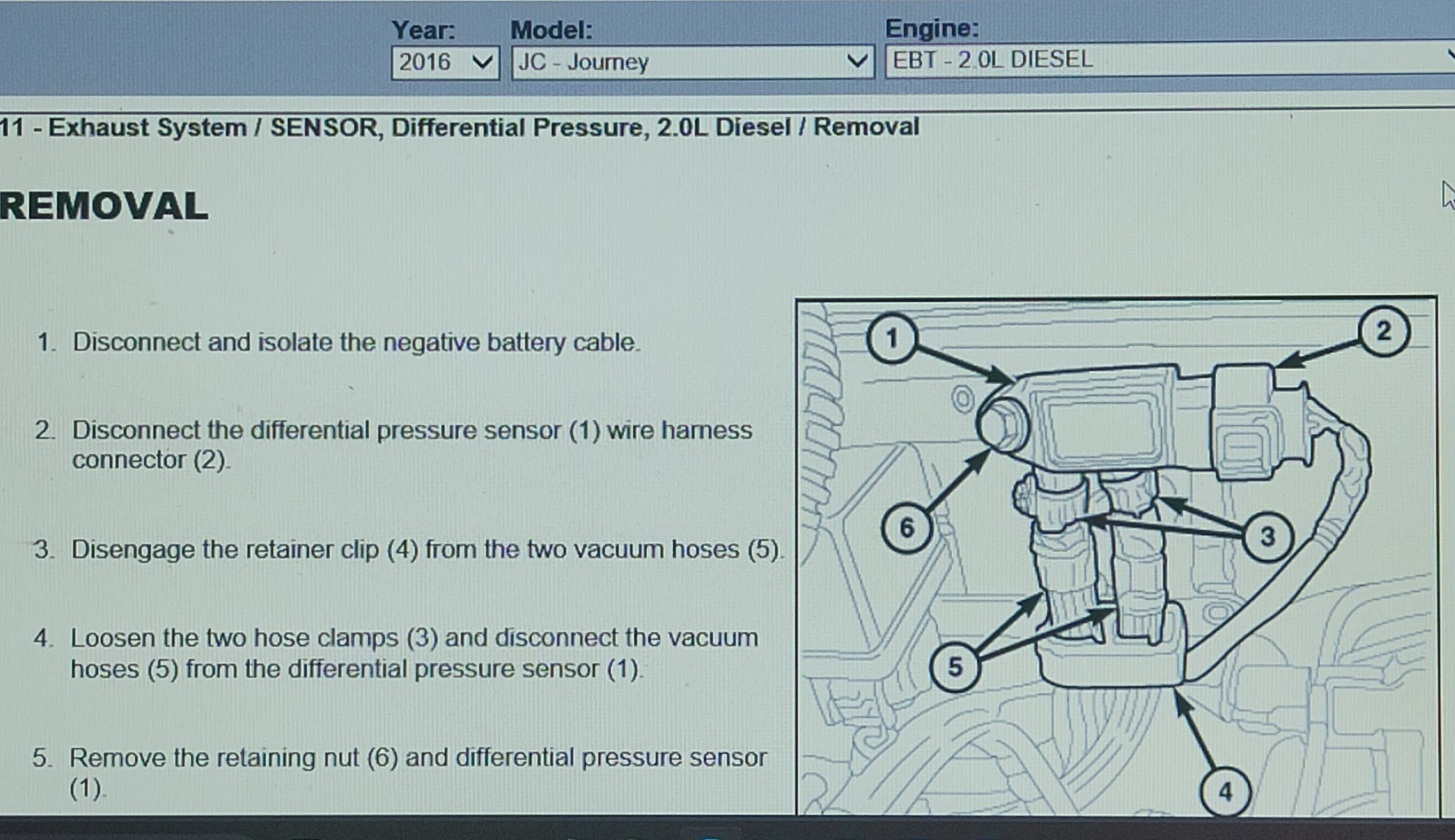

StirlingQR Posted May 19, 2025 Report Share Posted May 19, 2025 Hello, This may be VERY trivial, however, I have a fault code P2002 (and yes, I have seen the other posts about this code and what is working for those guys is NOT working for me). Short of replacing the DPF, I need to clean it so I got myself a professional cleaner that requires me to spray directly in through the DPF Temperature Pressure Sensor. I CANNOT LOCATE THIS. Trying to look in the engine (not much to be seen behind the engine bay). Descriptions about the location is not helping. Anyone able to help me please? I really need to get this thing cleaned and out of limp mode. Thanks! Quote Link to comment Share on other sites More sharing options...

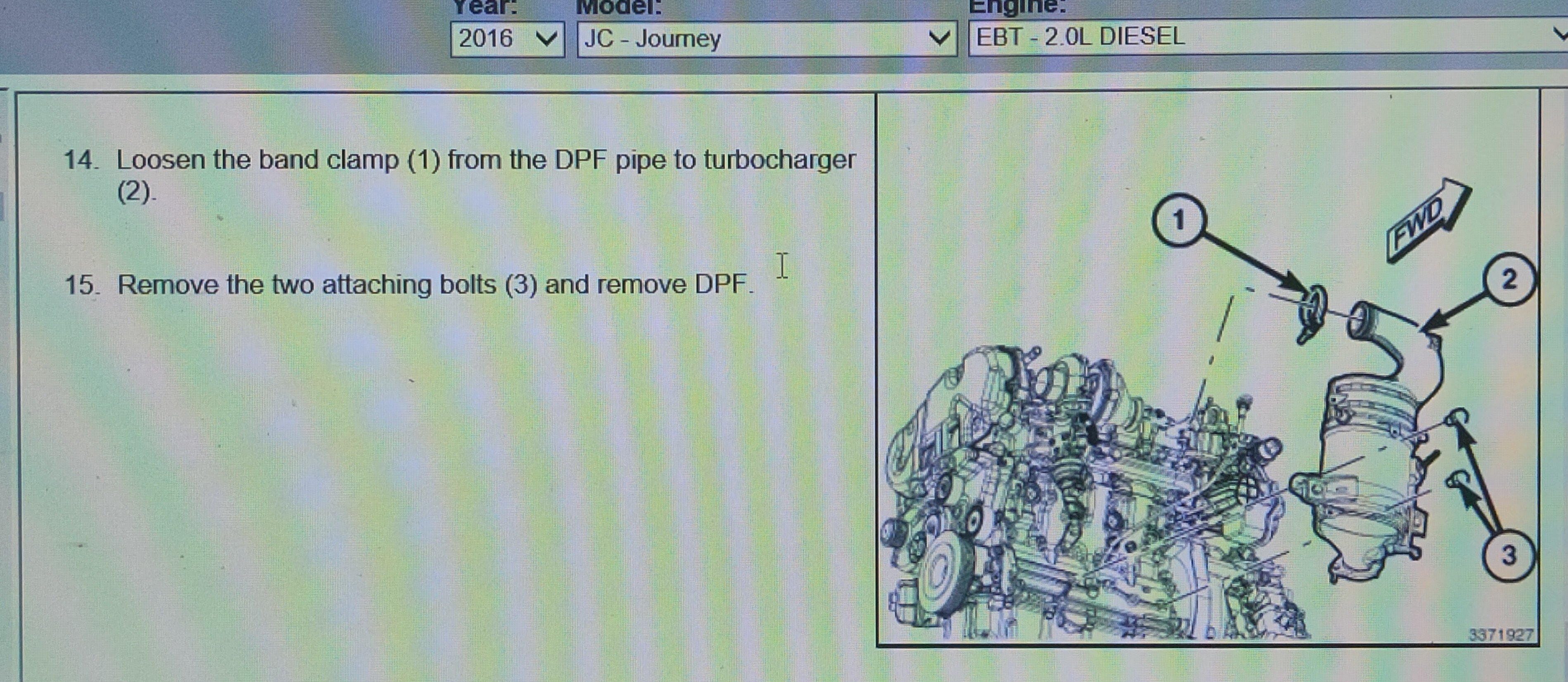

Dean H Posted May 19, 2025 Report Share Posted May 19, 2025 Sensor picture Quote Link to comment Share on other sites More sharing options...

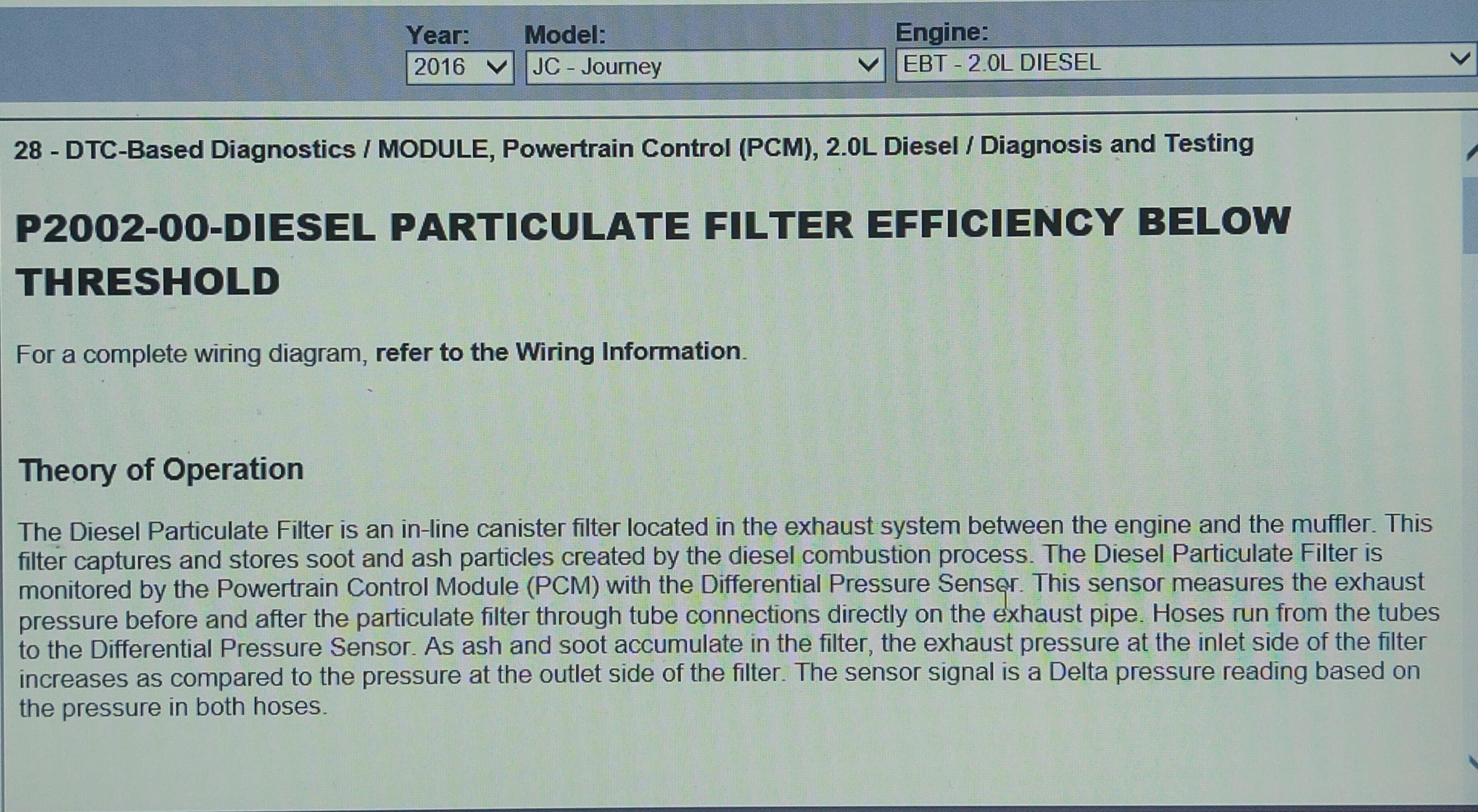

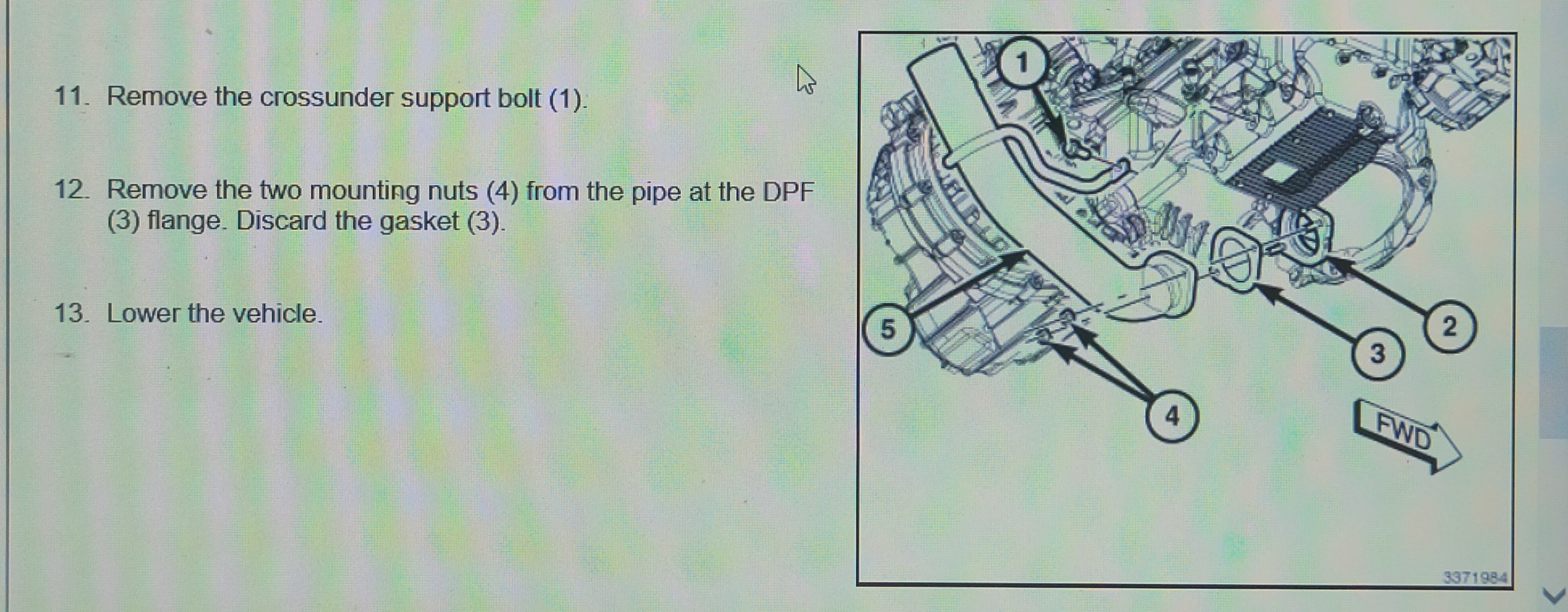

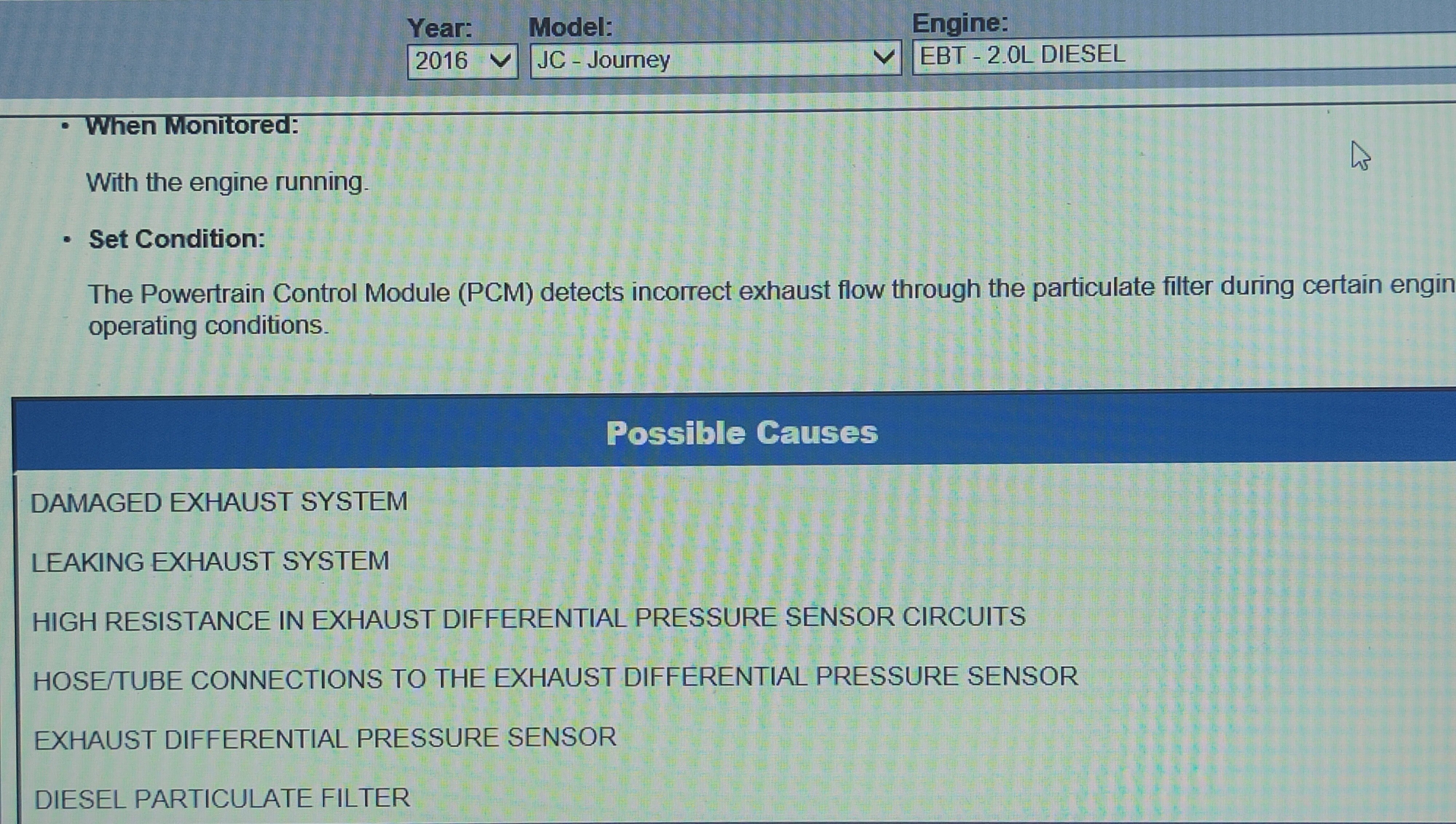

Dean H Posted May 19, 2025 Report Share Posted May 19, 2025 (edited) Here is the DP filter removal chart. Continues below. Edited May 19, 2025 by Dean H 2late4u 1 Quote Link to comment Share on other sites More sharing options...

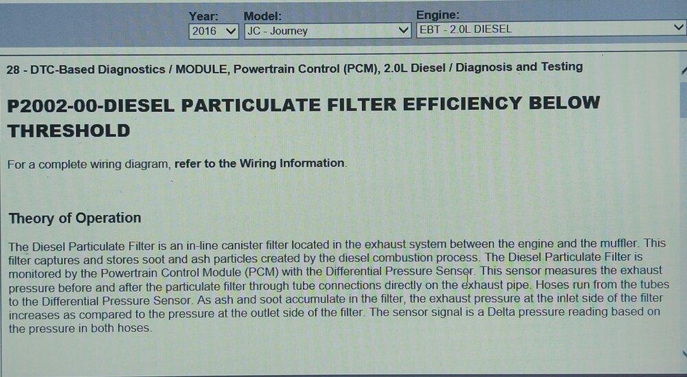

Dean H Posted May 19, 2025 Report Share Posted May 19, 2025 Quote Link to comment Share on other sites More sharing options...
