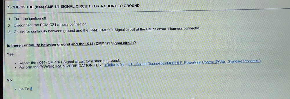

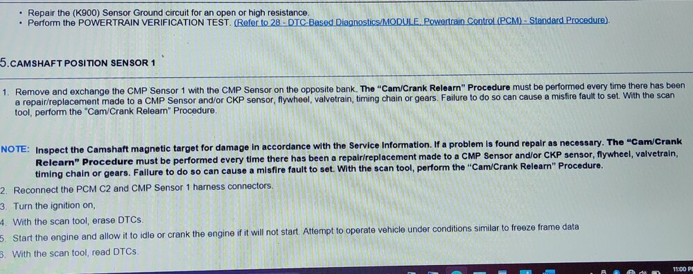

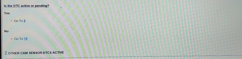

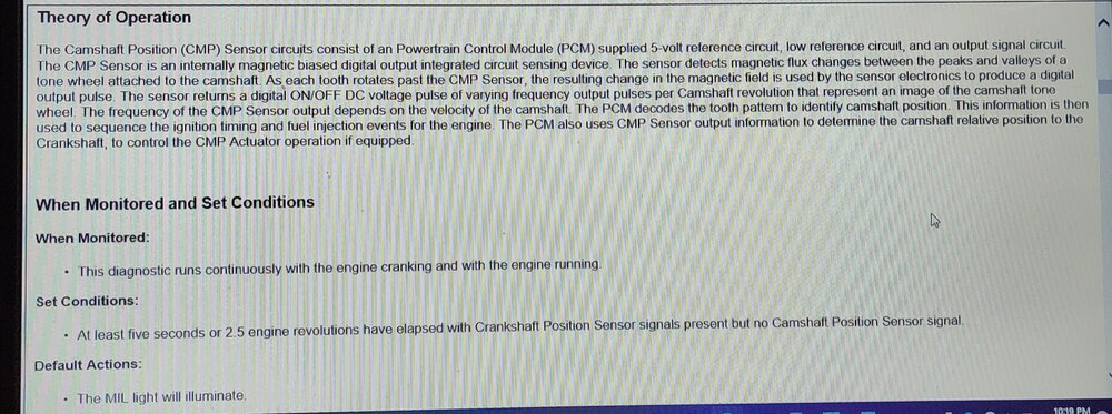

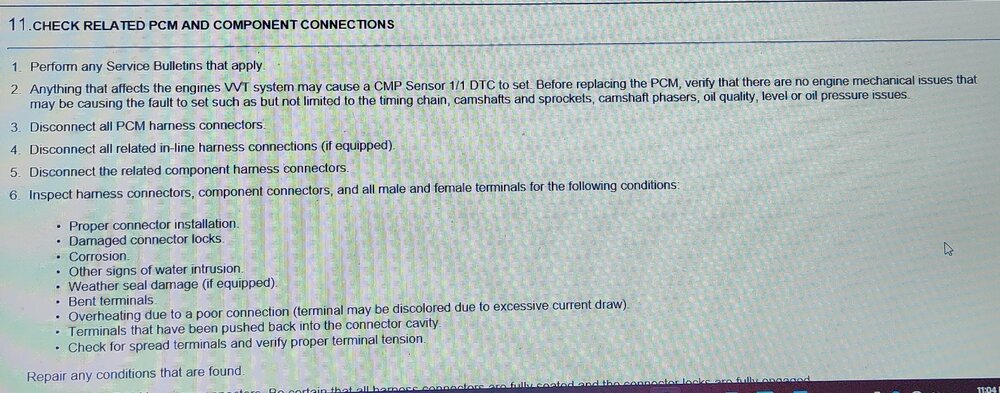

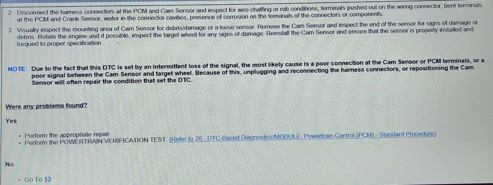

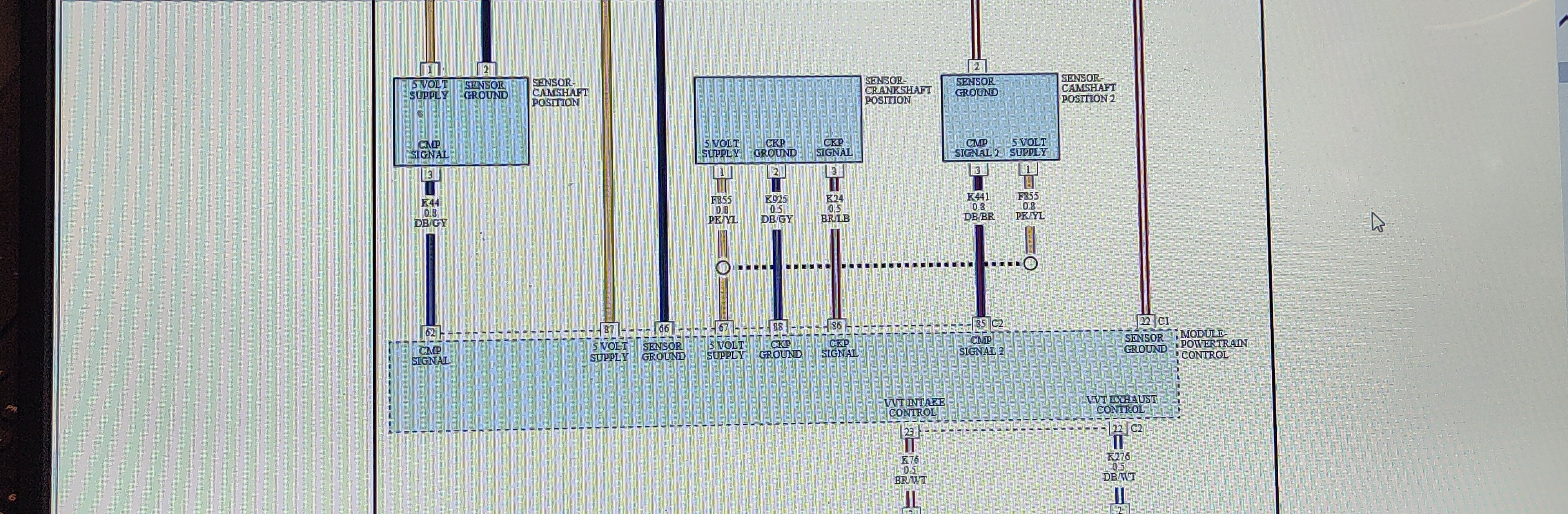

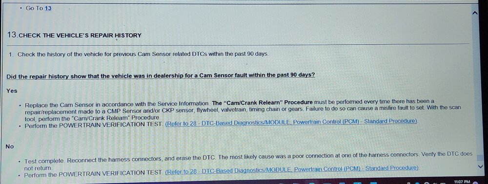

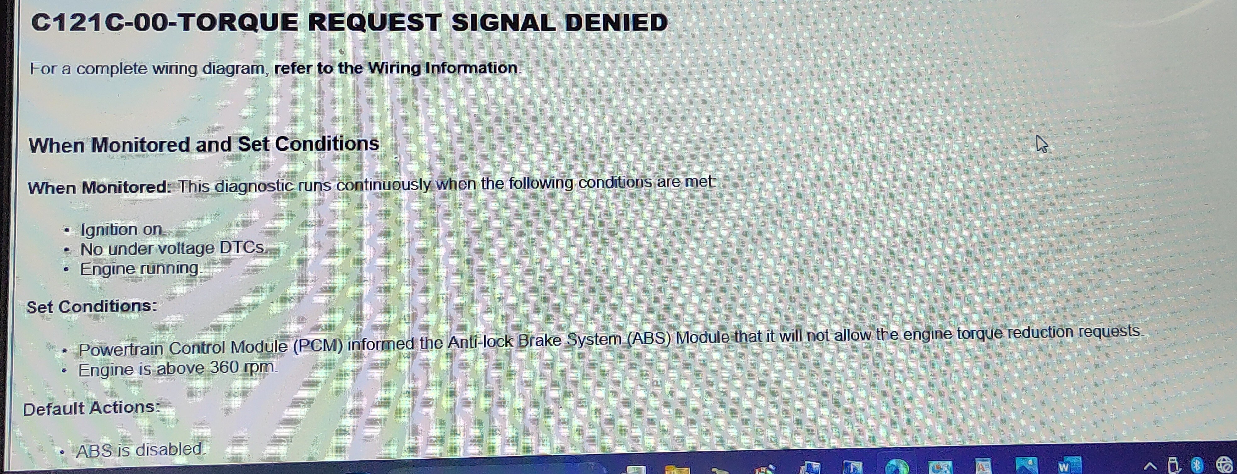

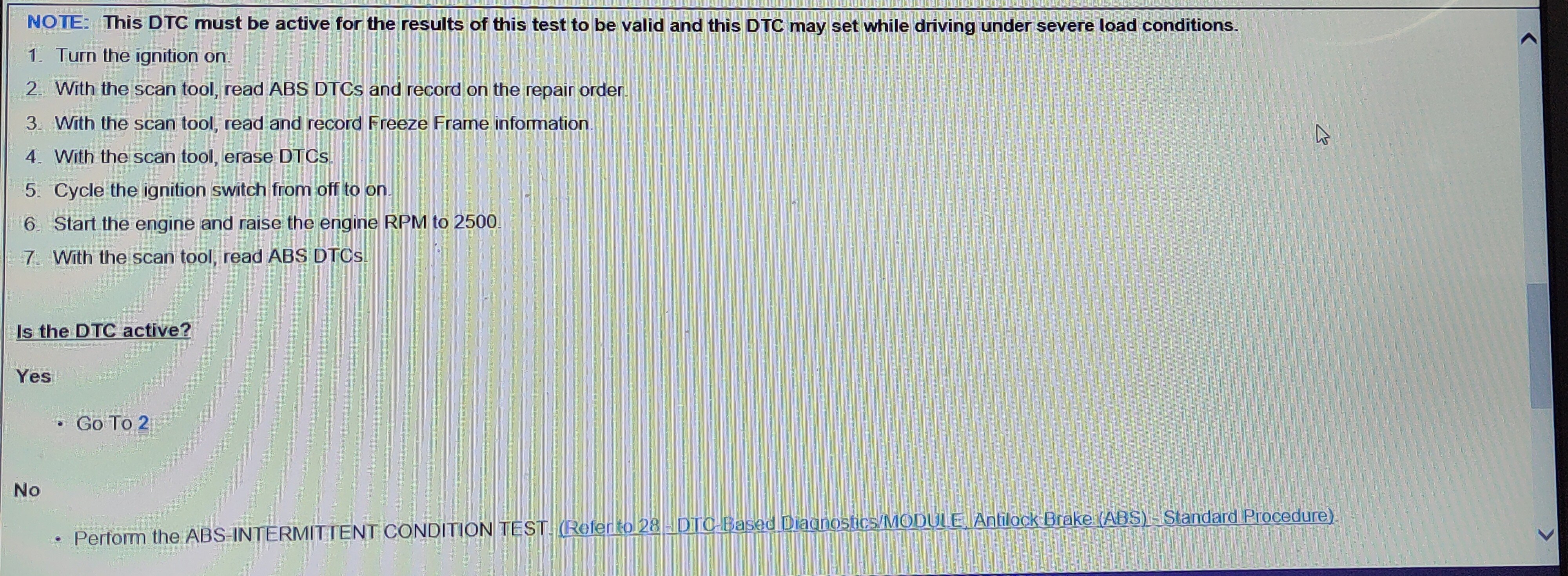

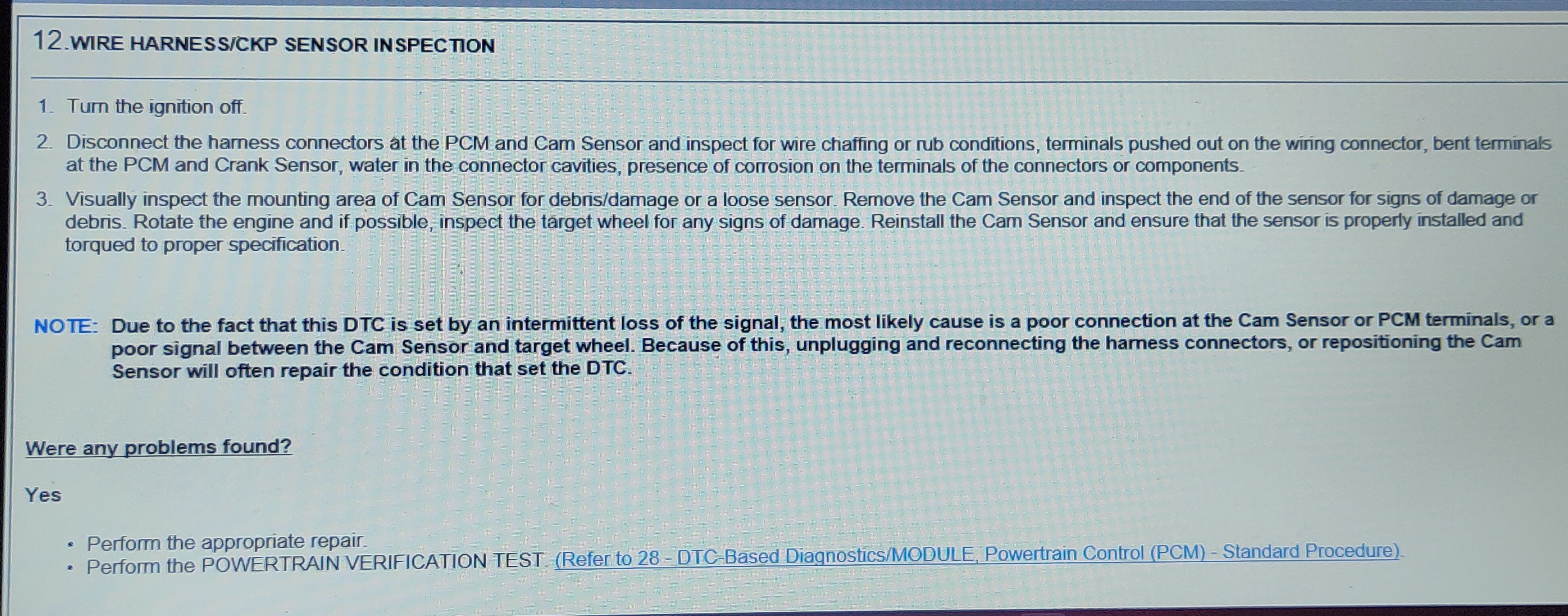

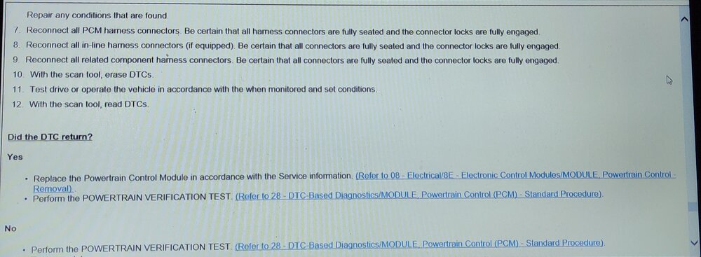

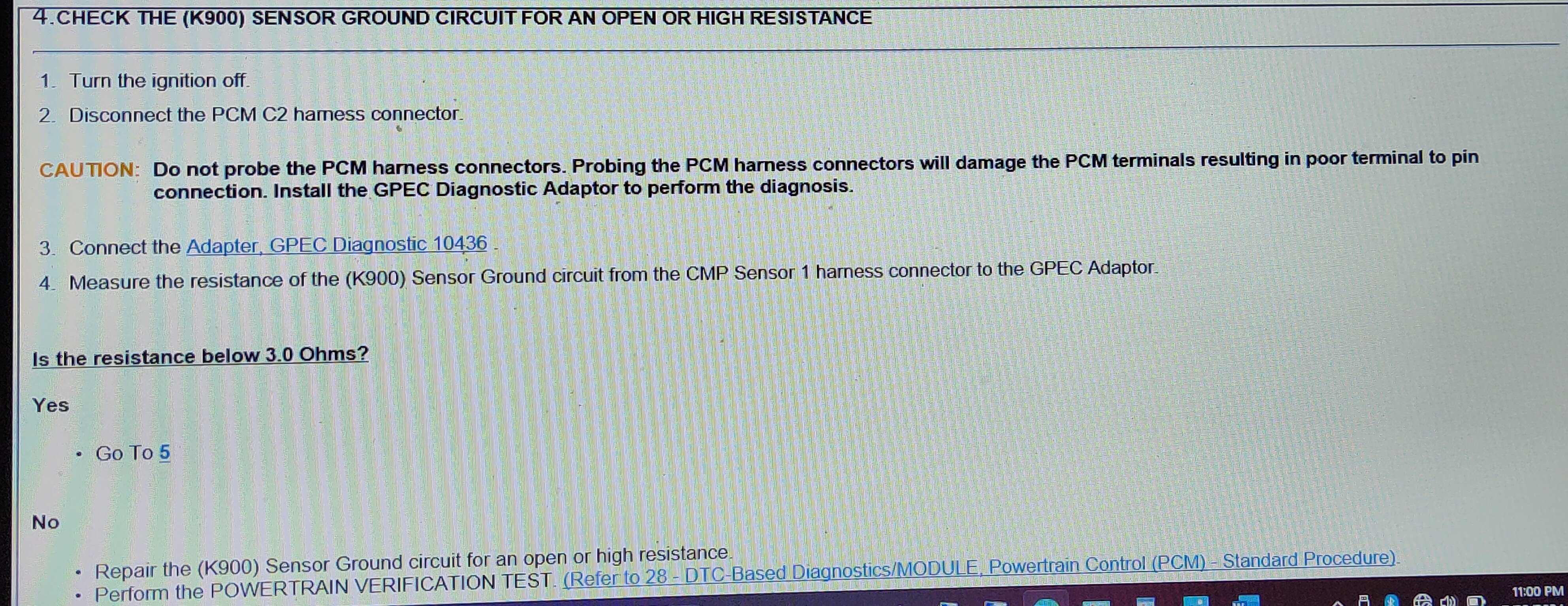

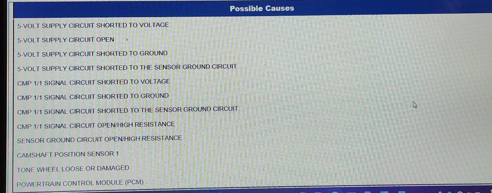

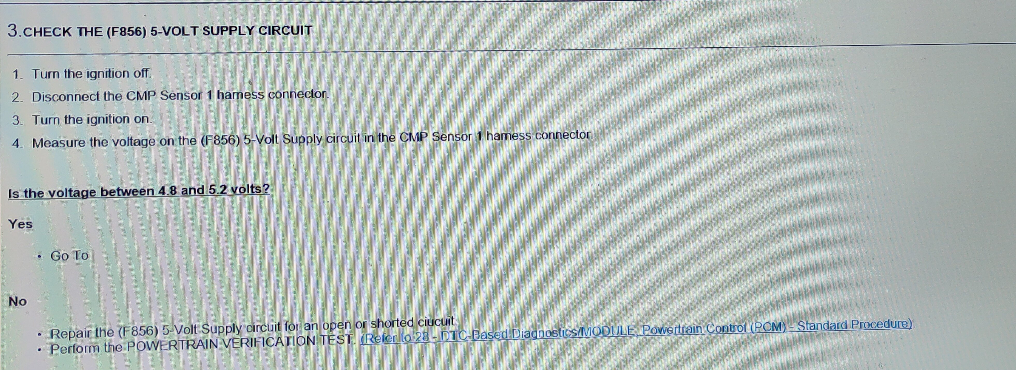

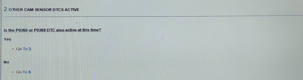

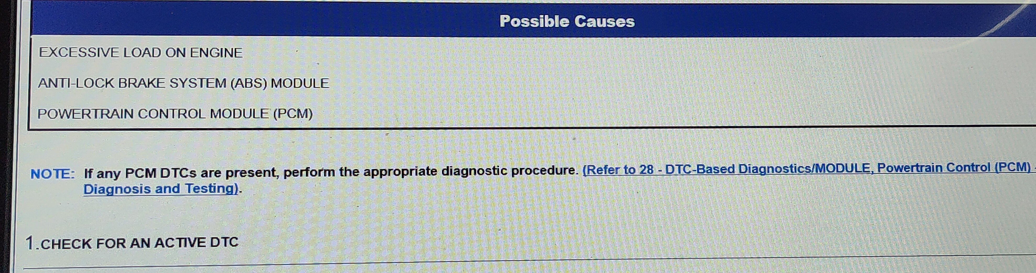

Dean H Posted July 24, 2024 Report Share Posted July 24, 2024 Code C121C-00 Quote Link to comment Share on other sites More sharing options...

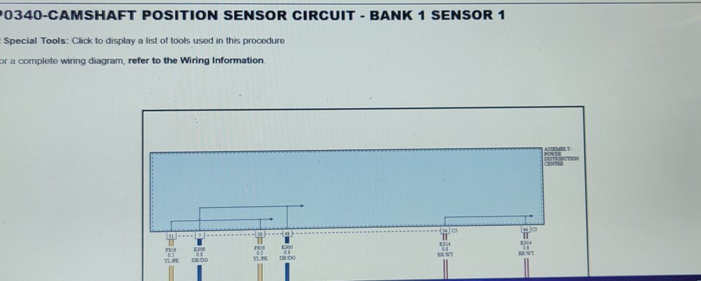

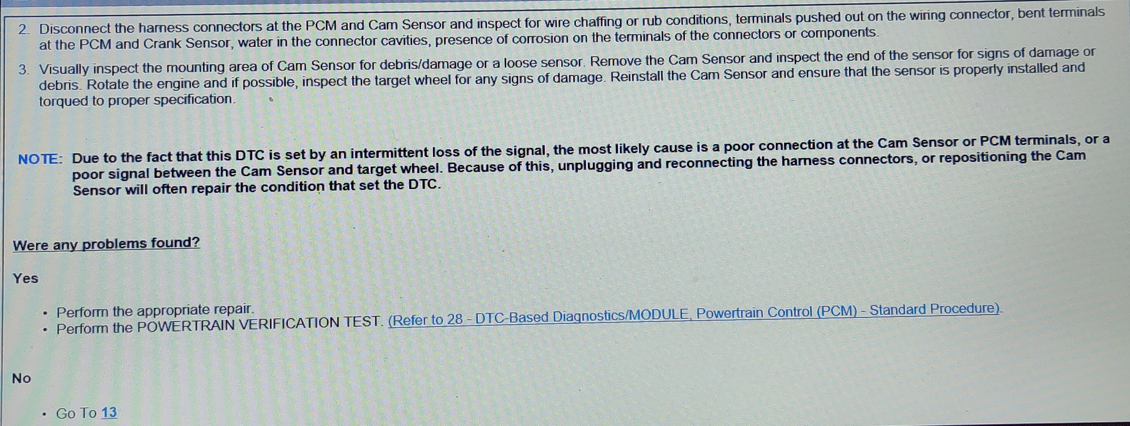

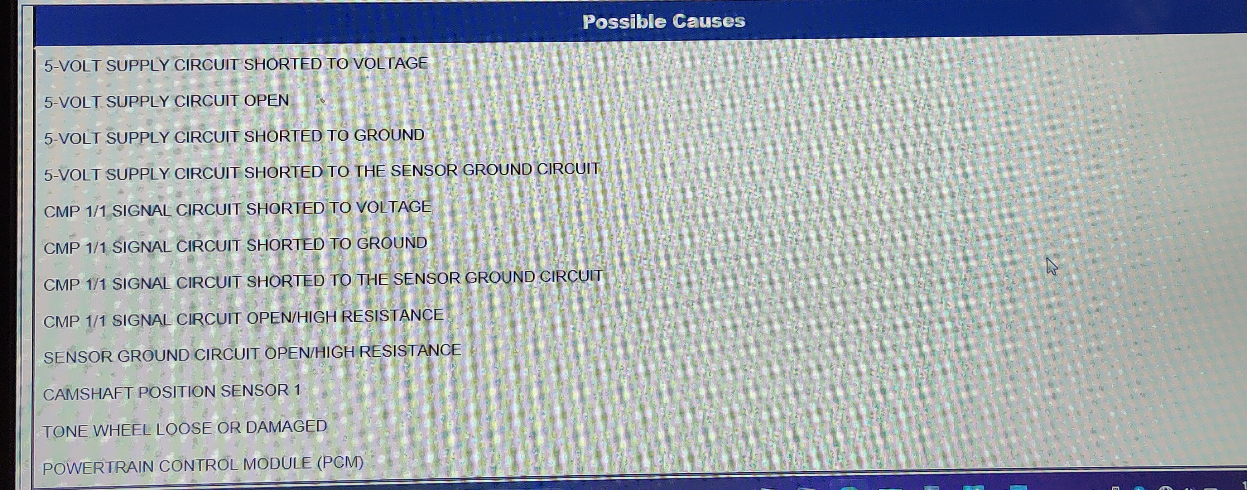

Dean H Posted July 24, 2024 Report Share Posted July 24, 2024 P0340 - Scroll down for the rest. Jess 1 Quote Link to comment Share on other sites More sharing options...

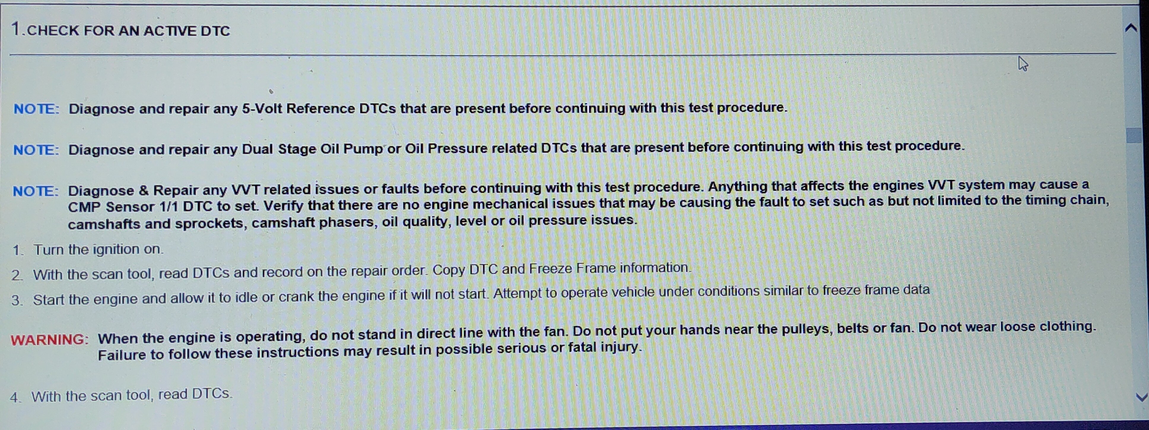

Dean H Posted July 24, 2024 Report Share Posted July 24, 2024 page 2 Quote Link to comment Share on other sites More sharing options...

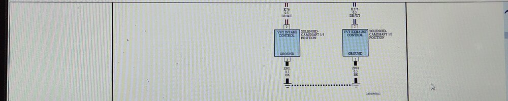

Dean H Posted July 24, 2024 Report Share Posted July 24, 2024 page 3 Quote Link to comment Share on other sites More sharing options...

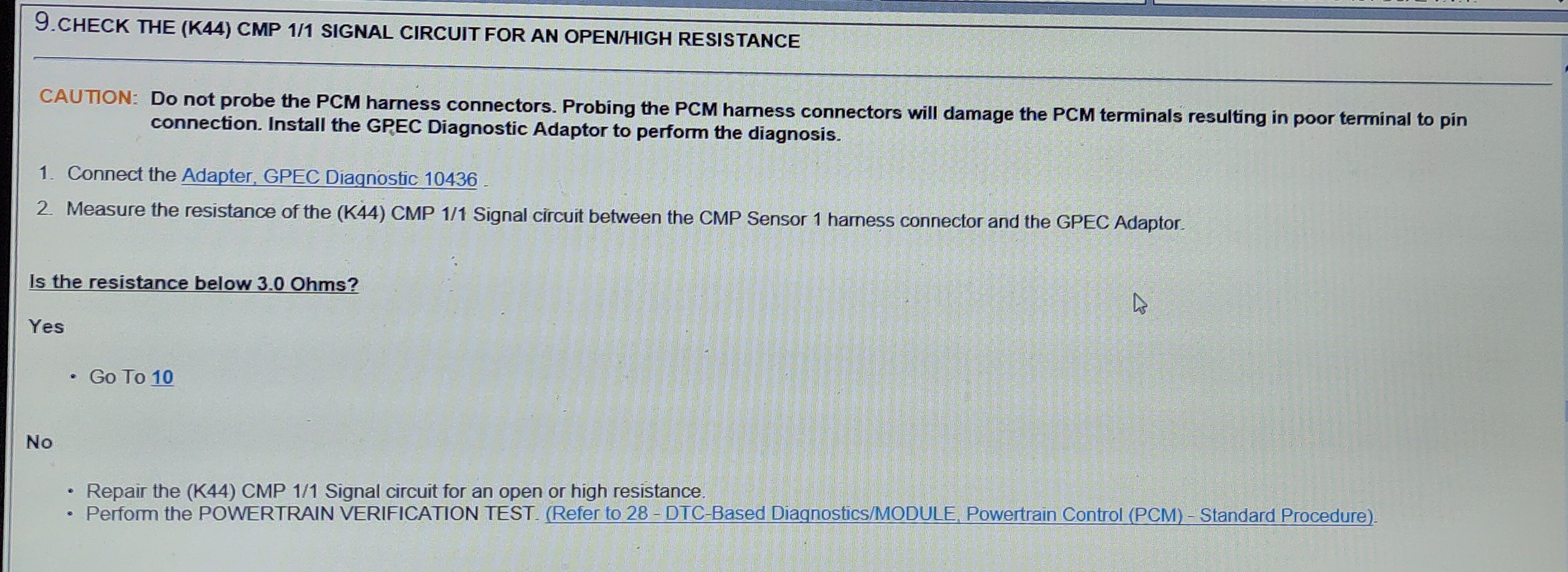

Dean H Posted July 24, 2024 Report Share Posted July 24, 2024 page 4 Quote Link to comment Share on other sites More sharing options...
Dean H Posted July 24, 2024 Report Share Posted July 24, 2024 page 5 Quote Link to comment Share on other sites More sharing options...
Dean H Posted July 24, 2024 Report Share Posted July 24, 2024 page 6 . Last page 5rebel9 and Jess 1 1 Quote Link to comment Share on other sites More sharing options...
5rebel9 Posted July 24, 2024 Report Share Posted July 24, 2024 Thanks for posting these diagnostic charts @Dean H! This should help this member out of their problem nicely! I don't have ready access to such materials, but from my own experience would have followed such instructions anyway. But I could not explain and detail well enough to somebody else what to do. Keep up the great job here on the forum! Quote Link to comment Share on other sites More sharing options...
