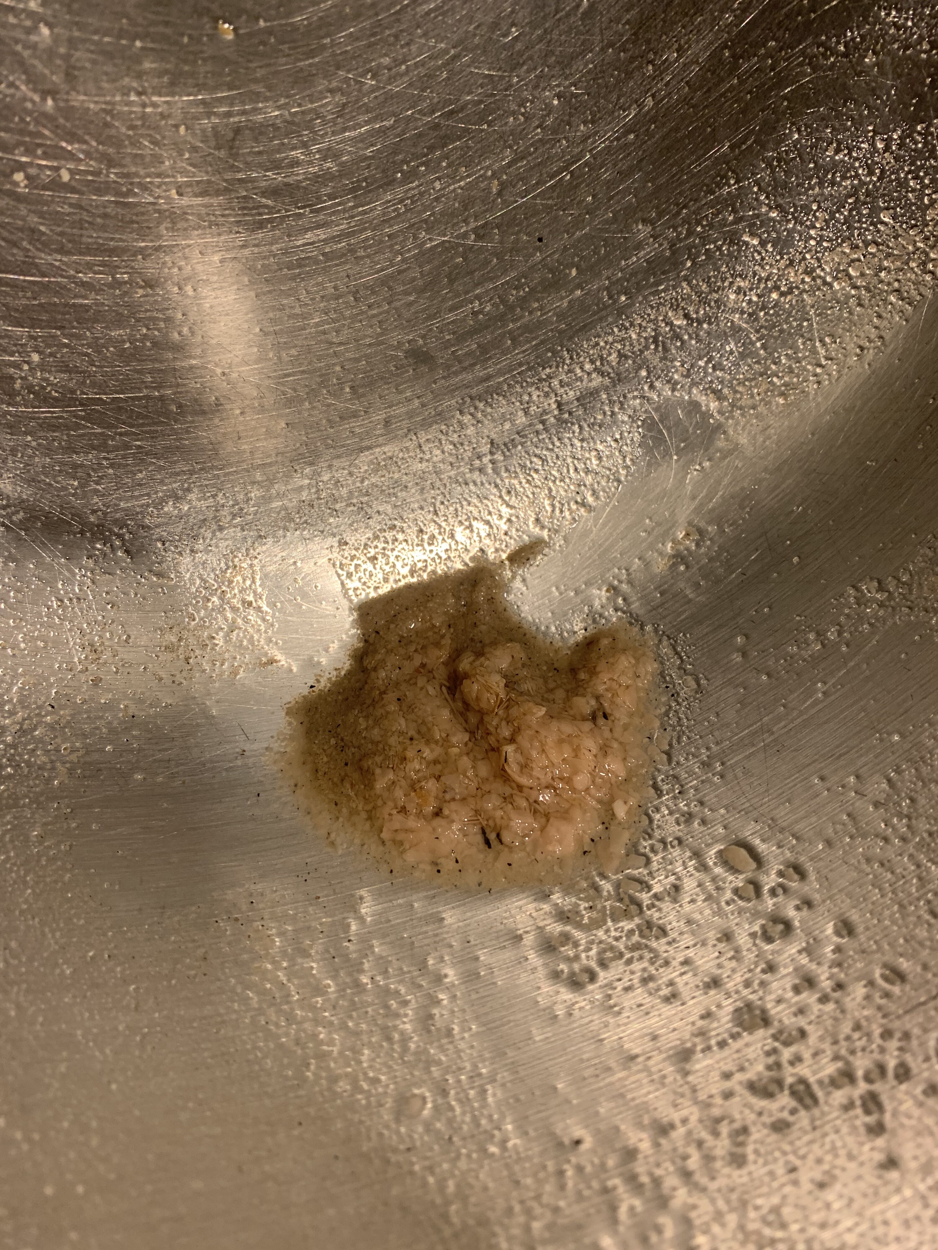

Wilson111 Posted November 28, 2023 Report Share Posted November 28, 2023 Just finished a heater core replacement after no heat on the passenger side. It’s a 2012 r/t, I’ve had it for 3 years. I did four 4 litre jug flushes last week after seeing a bit of sediment at the bottom of the containers. I flushed the old heater core once it was out of the car and got this out if it. If that was in the heater core what’s left in the radiator? Quote Link to comment Share on other sites More sharing options...
Wilson111 Posted November 28, 2023 Author Report Share Posted November 28, 2023 We nearly overheated on a road trip this summer going over a mountain pass, would it be possible the radiator to be partially clogged with this crud? Quote Link to comment Share on other sites More sharing options...
2late4u Posted November 29, 2023 Report Share Posted November 29, 2023 yes it could be possible after all it's a 12 yr old car,,, do a complete flush of the system then add new coolant and I would change out the thermostat as well,,which eng do you have? 3.6 is real easy and make sure you bleed the air out of the system as well. good luck Locosiete 1 Quote Link to comment Share on other sites More sharing options...
Wilson111 Posted November 30, 2023 Author Report Share Posted November 30, 2023 On 2023-11-28 at 8:16 PM, 2late4u said: yes it could be possible after all it's a 12 yr old car,,, do a complete flush of the system then add new coolant and I would change out the thermostat as well,,which eng do you have? 3.6 is real easy and make sure you bleed the air out of the system as well. good luck It’s the 3.6, new thermostat last year and bled the system with the bleeder screw, checked it this morning after getting up to temp to open the thermostat. No more bubbles coming out. Fingers crossed 2late4u and Locosiete 2 Quote Link to comment Share on other sites More sharing options...
