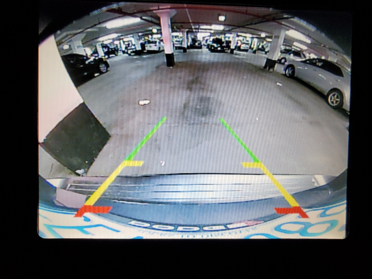

New Camera is installed. 2016 Dodge Journey.
The angle of view is strange and shows license and top corners. Backup lines don't line up.
Is there anything it can be done?
There's no angle adjustment on this.
I purchased it online with seller verification as the correct one. 560541AB.
are you sure this is the right part number as it doesn't bring up the rear camera when i checked it????...it looks like your camera lens is upside down? i would get back in touch with who ever sold this to you, ,,,did you do the install? usually the camera lens comes in a  whole new trim bracket that you install on the deck lid...

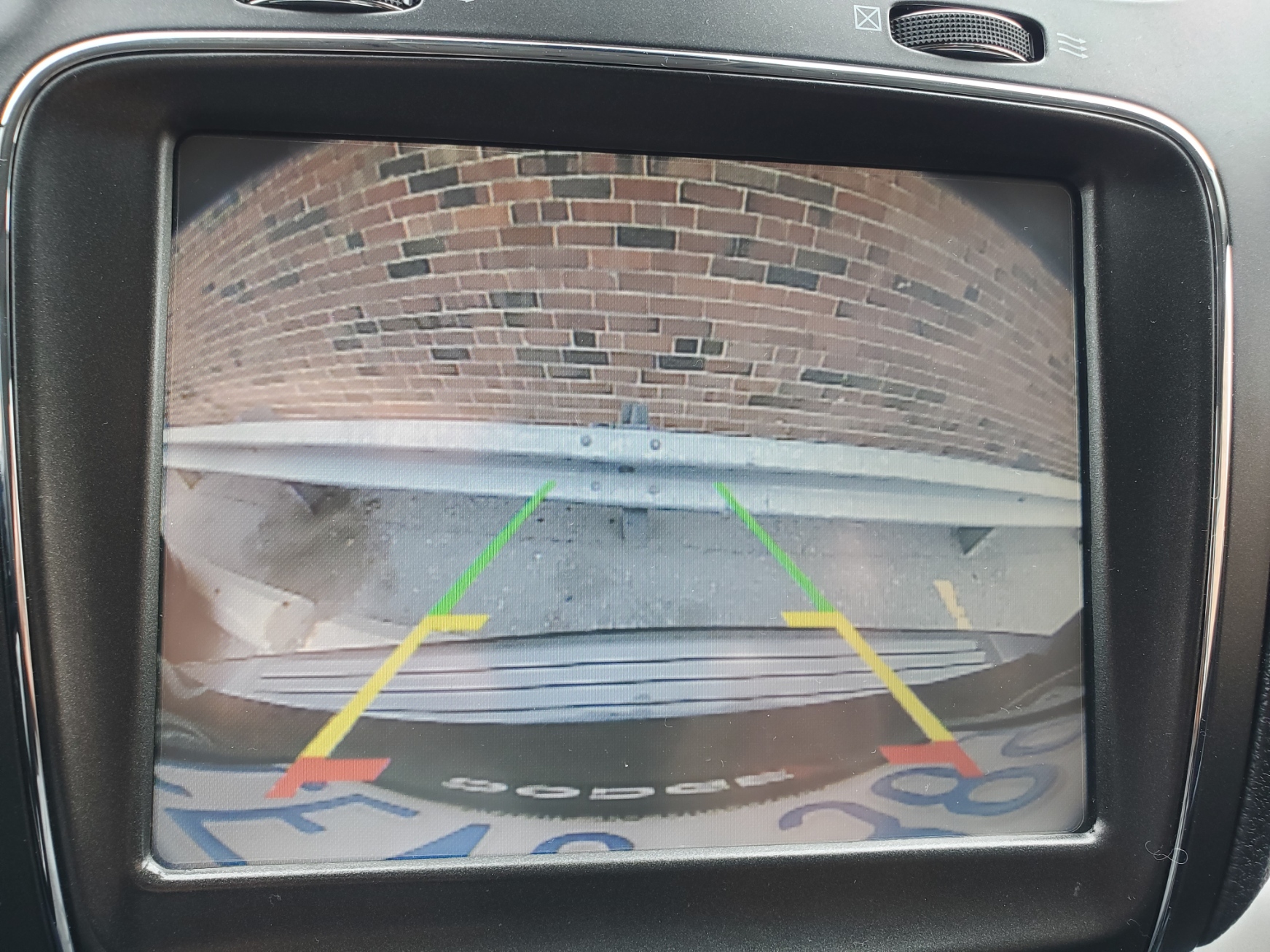

Update on this:
  1. New camera received from different vendor.
  2. Installed and exactly as the first replacement.
  3. Went to Dodge today:
  4. They revised installation, and checked all possible software updates for camera, modules, radio, etc. All up to date.
  5. They installed a new one from their parts - the same.
  6. The interface is not causing any issues on this
  7. I was told that my camera is the correct one, the supplier updated the hardware and that's how it shows.
  8. Nothing can be done. Actually, they told me that unlike what I did, if I bought from them, they wouldn't refund as the image is clear and it's not causing or showing any errors.
  9. The lines are the most annoying part.

looks like the camera lens is mounted upside down (shooting up)  what is that the top of your garage door?
No. That image is with the trunk closed.
At the bottom you have the Bumper lip, pavement, cement marriers. The background is a brick wall, the dark edges are the corners of the camera/plate lights trim.
