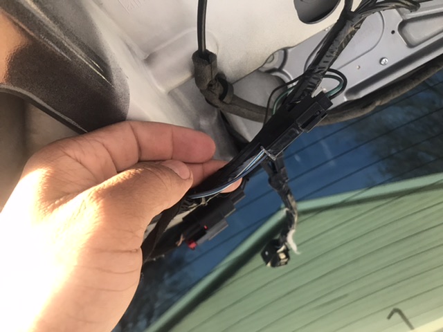

I have a 2013 journey and lucky few to get a oem camera and bezel from the local junkyard for $50. But when I went to install it I did not have the big connections to hook the camera just the small one that hooks to the tailgate. I called around to the dealership to get the harness ordered. But was told that I would have to order the camera in order to get the harness. Do anyone know the part number just for the harness or if I could get a jumper the add in??

So I would still have to buy a new camera kit in order to get the harness? And once I get that harness do I have to completely take the factory wires out or do it just get tied in together? It sucks because there is not one video showing how to do it everyone just she the finished product.

Ok I finally was able to get the camera set up. I was thinking that you could just get a jumper like you can on the charger and challenger. But I had to replace the whole tail gate harness luckily it wasn’t that bad of a job. Plus I couldn’t complain to much since I was able to get it for $30 when the dealership was wanting $150+!
