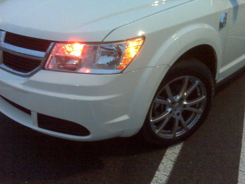

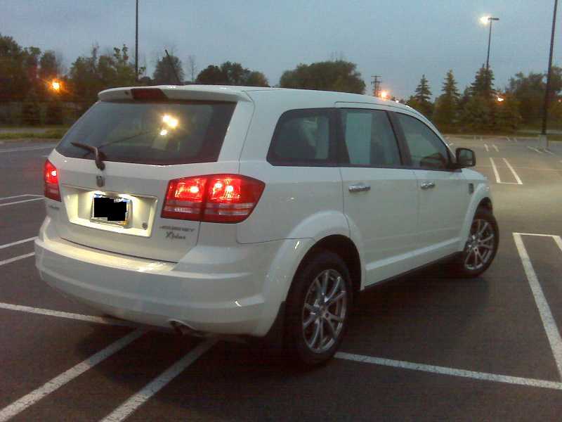

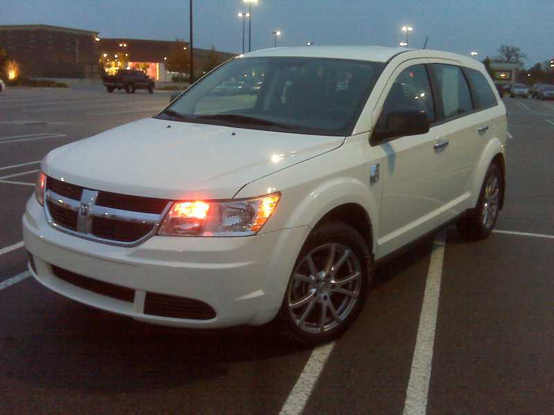

Rims for a Journey are a little hard to find because of the new bolt pattern. In my case, I had to order them myself because no tire/rim stores had anything that would fit. The right offset was the thing I had a hard time finding. These are not chrome, only polished. the good thing about ordering them myself is that no one else has them, yet.
It looks really nice, I like it. What size tires did you go with????
I thought about after market tinting the windows. Will they peel and bubble over time (5 years or more)?
Tire size: 225 60-18
The orginal size was 225 70-16
I thought the ride would change because of the thinner tire, but it didn't. It is still a pretty soft ride. It does handle better in the turns now. It dosen't sway as much now. Oh yeah, I forgot to tell everyone that the offset on those rims are 35. The offset should be 40. The 5mm difference helps in the handling (it help with the sway thing I spoke of). I would not recommend going anything above a 35 offset. If you do you will run the risk of damaging your bearings, etc. When you buy your rims, make sure you ask about the offset. I had a few places ready to sell me rims with a 15, 20, and 25mm offset. They didn't care about the offset, only the bolt pattern. Once I asked about the offset and will it damage the bearings, all of them said "yeah, it will over time". Of course my reaction is, Why are going to sell them to me then?!
Anyway, ask tons of questions. The Journey is so new, a lot of places don't know that much about it.
