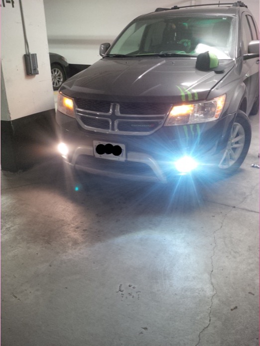

LED fog light bulb on right
OEM fog light bulb on left
30 watt led bulbspost-12497-0-24377700-1452310688_thumb.j

It doesn't reach too much further down the road but it gives me a wider beam than just using low beams. Plus it mixes in a small amount of white/light blue to the yellowish beam pattern of the low beams. I have 60e bulbs where JK said he has 30-35 watt bulbs. So far no one has flashed me because of glare.
