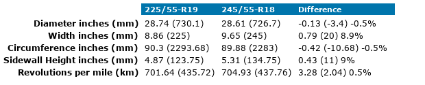

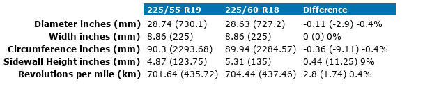

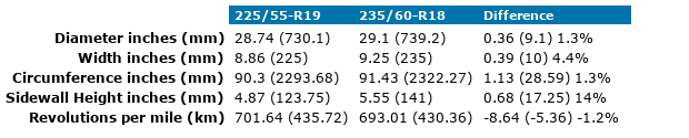

FROGBOX Posted May 9, 2014 Report Share Posted May 9, 2014 (edited) What year is his Journey? If its an older Journey (early 2012 and older), it has the small brakes and the wheels should fit? If it is newer and has bigger brakes, you will have to find some Journey wheels, or go aftermarket. I bought a set of 18" wrangler wheels in the Fall that I wanted to use to mount some snow tires and they didn't fit over the brakes (link to thread). I have the bigger brakes. The offset was too high and the spokes of the rims were hitting the caliper. Journey wheels have a +40 offset. Jeep wheels are +44.5, so they sit further inside by 4.5mm and have a greater chance of rubbing. A smaller offset means they poke out more. As far as tire size goes, you can go wide, but not tall. The Jeep tires are too tall and they will hit the suspension. You need a low profile tire like a 55 or 60 series. The rim width on the Jeep is 7.5" meaning it can handle tire widths between 225 & 265. So for an 18" wheel, these are the 3 sizes that will be closest to the stock size: 225/60-18: 235/60-18: 245/55-18: Edited May 9, 2014 by FROGBOX Lobitz68 1 Quote Link to comment Share on other sites More sharing options...
