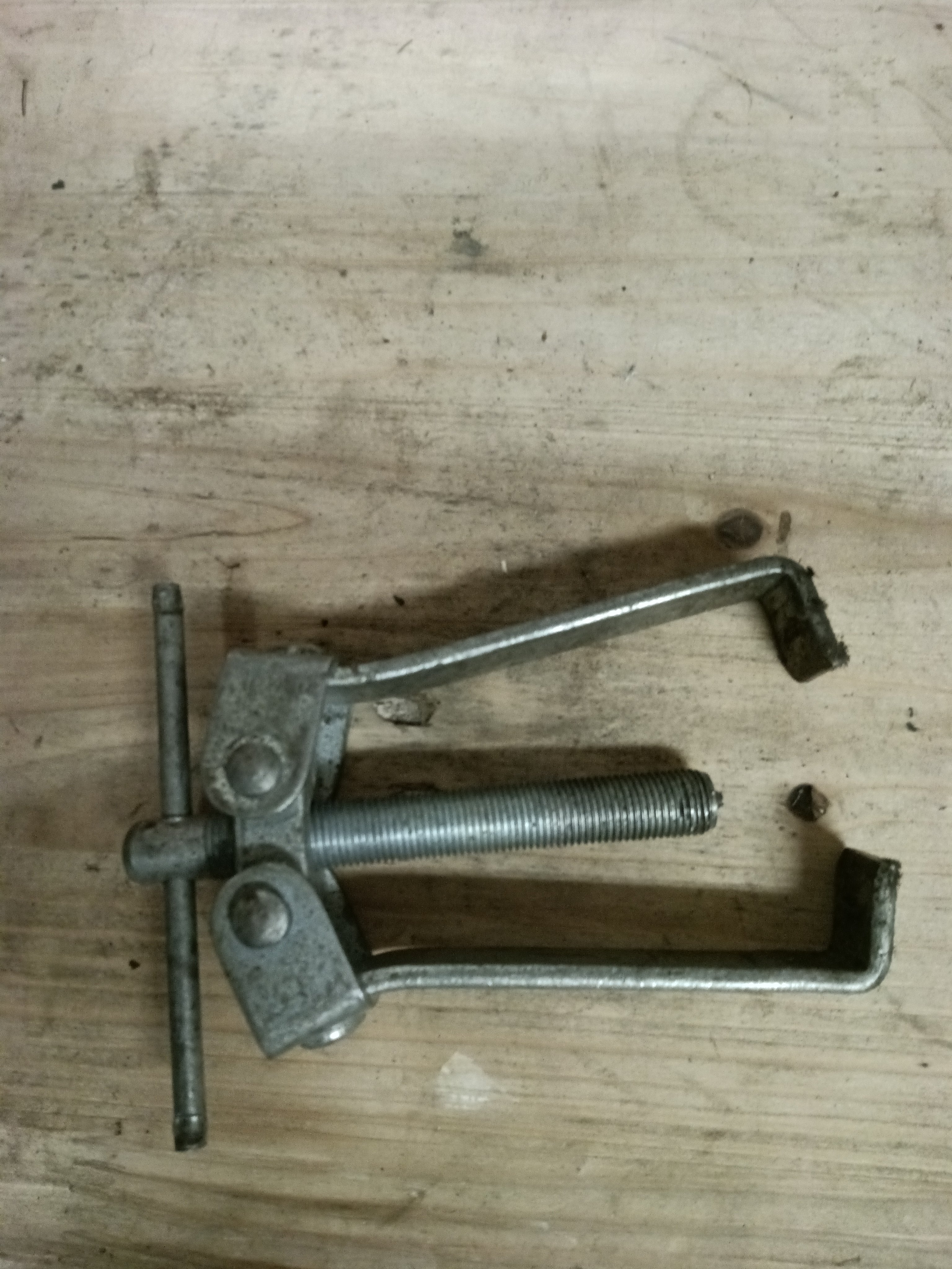

I did two years ago. If never apart the taper fit needs lots of force to separate2026-06-2510_01.347311099780730300620.thumb.jpg.b42ea58d06b29e0770ab393ca4b28f79.jpg. I have a really old steering wheel puller that fit into the tight recess.
Removing without damaging is the hard part. Harbor Freight has some unusual pullers, that are cheap enough for one off use.
Cowling plastic would be cheap from auto recycler if you are replacing broken plastic.
