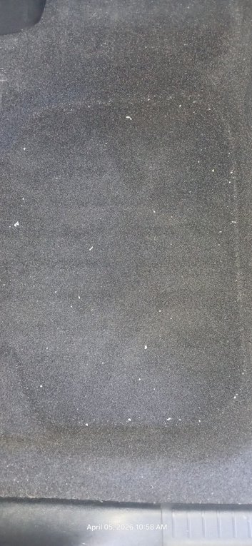

J'sjourney Posted April 5 Author Report Share Posted April 5 2 hours ago, larryl said: If there's a bin it should be visible not covered by carpet The only thing covering it would be a floor mat as the hinge is very visible unless they did away with it in later model years It's metal you should see it on both sides behind the driver and passenger seats It looks like they may have did away with access to the bin (box). See photos. I only took pictures that are behind drivers side. Passenger side is the same way. Carpet and Storage bin (box). Quote Link to comment Share on other sites More sharing options...
John/Horace Posted April 8 Report Share Posted April 8 (edited) Interesting. Looks like access doors on both sides in floor were not installed. Maybe last year of manufacture they just decided to not bother, you must have the 2.4 engine as well, the 3.6 was no longer offered. The 2.4 is still a decent engine. My only concern would be if water happened to leak into the large boxes. There are removeable drain plugs, but they pull out from inside storage box. If you suspect water is trapped, could drill out the visible plug and then reseal it after water is removed. They could probably hold two gallons each side. Shame they blocked them off, handy option really. If you are battling water leak still, maybe check with a regular mechanic. Most people have been able to sort out the water leaks eventually. Edited April 8 by John/Horace Quote Link to comment Share on other sites More sharing options...
J'sjourney Posted April 8 Author Report Share Posted April 8 1 hour ago, John/Horace said: Interesting. Looks like access doors on both sides in floor were not installed. Maybe last year of manufacture they just decided to not bother, you must have the 2.4 engine as well, the 3.6 was no longer offered. The 2.4 is still a decent engine. My only concern would be if water happened to leak into the large boxes. There are removeable drain plugs, but they pull out from inside storage box. If you suspect water is trapped, could drill out the visible plug and then reseal it after water is removed. They could probably hold two gallons each side. Shame they blocked them off, handy option really. If you are battling water leak still, maybe check with a regular mechanic. Most people have been able to sort out the water leaks eventually. Thanks for your reply. I saw those black plugs. I did a search for 2019 Journey User Guide and compared it with the 2020 guide. It looks like 2019 was the last year that had access to the storage bins. I was thinking of having the shop that was trying to find the leak remove the carpet and see if the access doors are or did they just seal them up. Even do what you said, " drill out the visible plug and then reseal it after water is removed". Not sure if I want to spend more money on this. Quote Link to comment Share on other sites More sharing options...

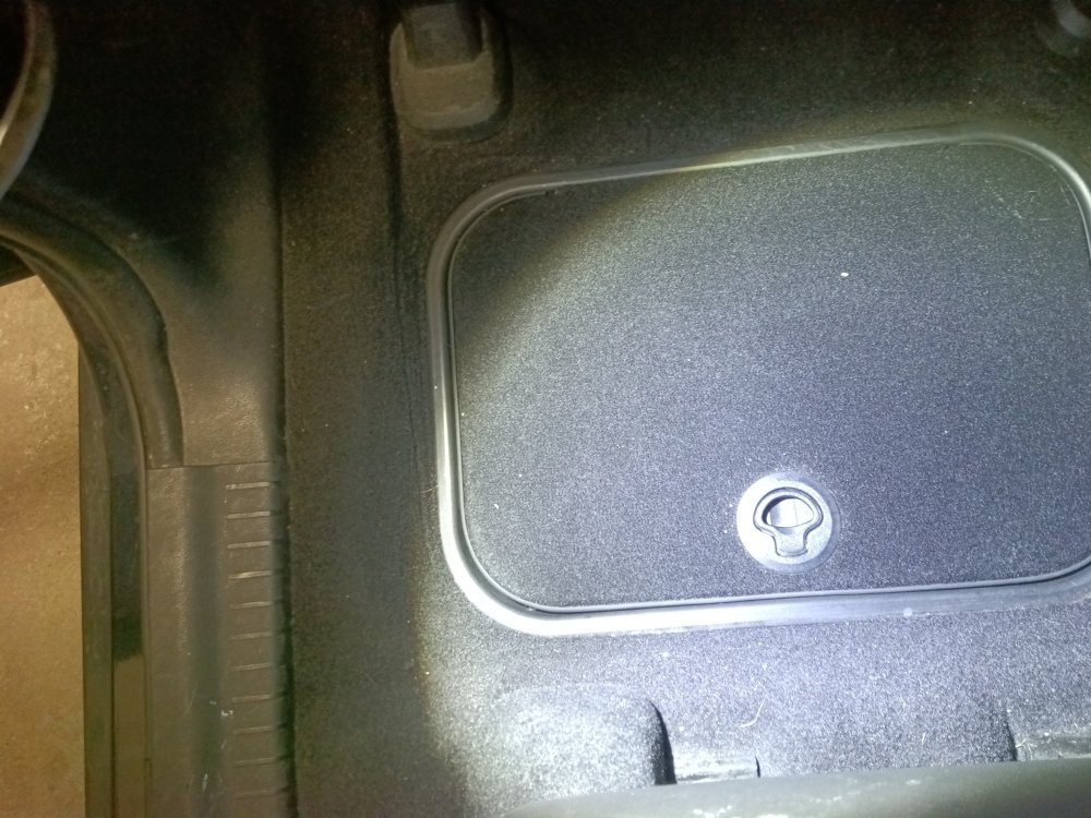

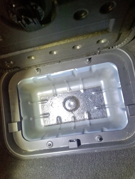

John/Horace Posted April 9 Report Share Posted April 9 This what the floor doors look like. Quote Link to comment Share on other sites More sharing options...
John/Horace Posted April 9 Report Share Posted April 9 (edited) The leak is not likely tied to the storage bins. I just realized they are completely isolated from the side channels that run beneath the door. The main cause of front cabin floor leaks. I'm sure the dealers are very familiar with this leak and know exactly how to fix it. The question is can you guilt them into fixing their assembly flaw at a reasonable price. Not a great time to be trying to switch vehicles; prices sky high everywhere. Companies taking advantage, shame. It may be only plugged drainage holes in front subframe. Cleared out with a 1/4" drill bit. One young guy on this site fixed his leak in an hour by himself, not even a mechanic. Had a bit of luck too. Edited April 9 by John/Horace Quote Link to comment Share on other sites More sharing options...
