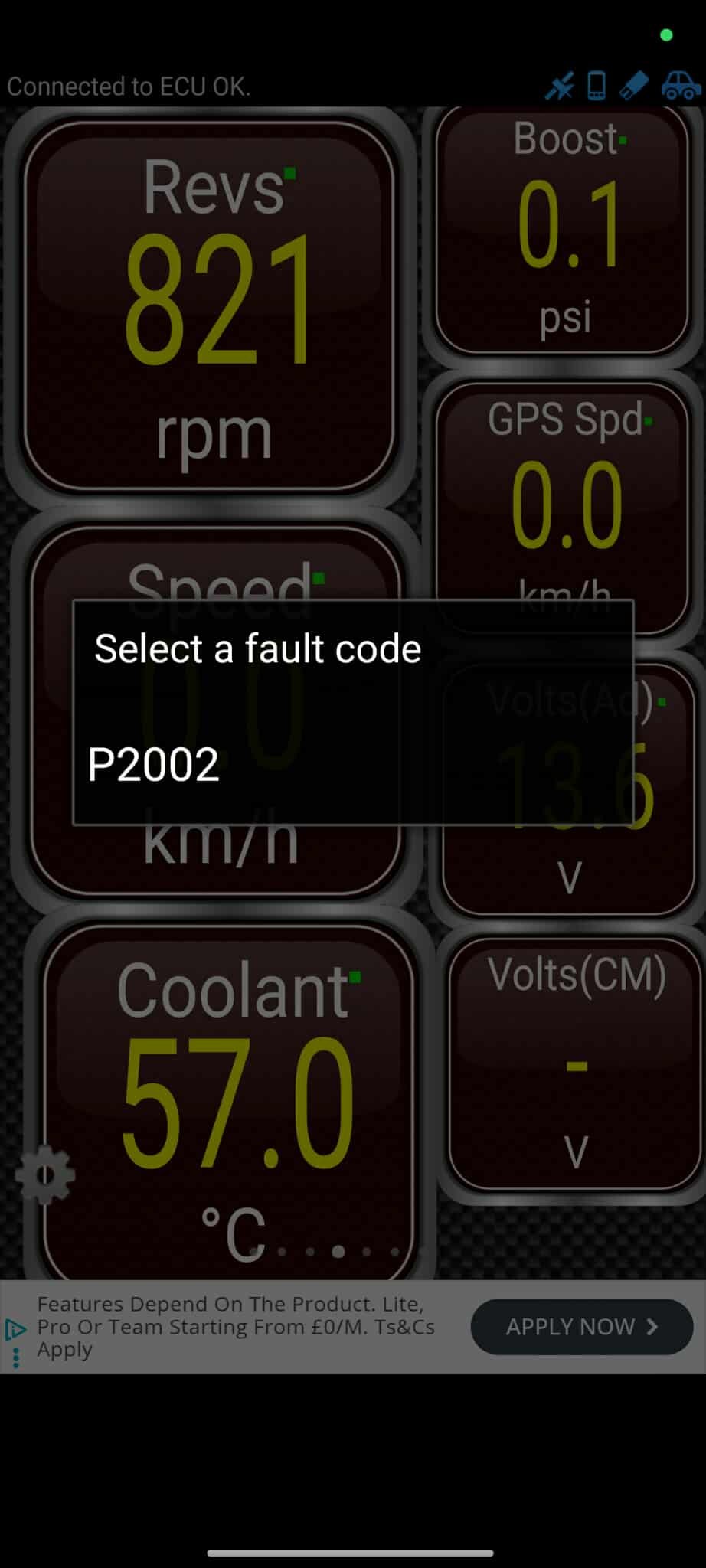

I’m having an ongoing issue with the DPF in my Dodge (Volkswagen 2.0 CRD engine, 167k miles), and I’m hoping someone can point me in the right direction.
For the past few months I’ve been struggling with error P2002 (DPF Efficiency Below Threshold).
First, a mechanic friend cleaned the DPF without removing it — that only helped for a few weeks.
Then I paid for a full mechanical DPF removal and cleaning. It wasn’t cheap, but again the fix only lasted about 4 weeks while driving mostly in town.
Two days ago I took the car on a longer trip and after about 200 km the P2002 error came back, as if the DPF was clogged again.
I’m wondering:
  • How is it possible that after a full mechanical cleaning the problem returns so quickly?
  • Could something else be causing this, like a faulty differential pressure sensor, EGR issues, turbo problems, or incorrect regeneration?
  • What are my options now — another cleaning, regeneration, replacing some sensors, full DPF replacement?
  • Has anyone experienced something similar with the VW 2.0 CRD engine and found the real cause?
Any suggestions would be greatly appreciated — I’ve already spent quite a bit and don’t want to keep cleaning the DPF if something else is actually causing the issue.
Thanks in advance!
