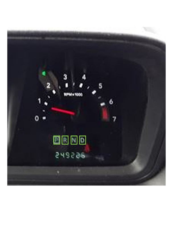

I was having a problem for about 2 years, where all the gears on the dashboard were selected/lit and the car would not start (no crank, no click, car had full power everywhere). It was an intermittent problem and would happen about every two months. If the car sat for a few days, out of the blue, it would work/start again.

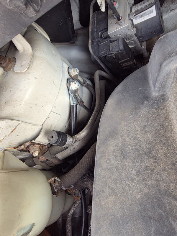

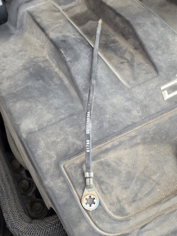

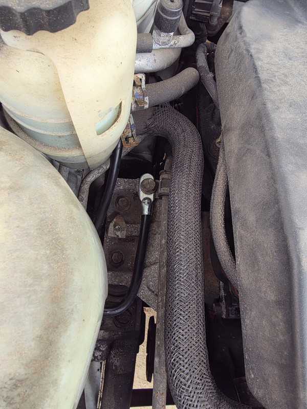

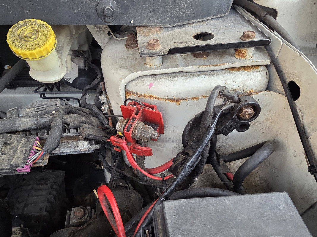

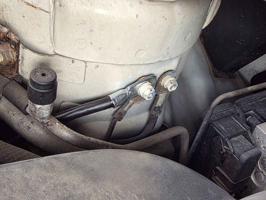

Short answer: I had a broken ground on the passenger side of the car I had to repair. After that, the car started right up!  (All the pictures are below)

I started looking around the engine and noticed a broken cable on the passenger side. It was corroded badly already (which would explain why the car would work on and off). Once I replaced it, I unhooked the red power cable to the TIPM to reset it (for about 10 seconds), and the car started up with no issues!
I am posting this because there was NO solution on the internet about this! People were starting to think it was the range selector, but that did not explain the car working on and off (it drove fine, when it worked). I re-grounded the car (the driver side) like some people have said, but that was not enough. Look around for broken/corroded wires and re-ground the passenger side too. (Running a ground from the driver's side to the passenger side did NOT work for me!)
