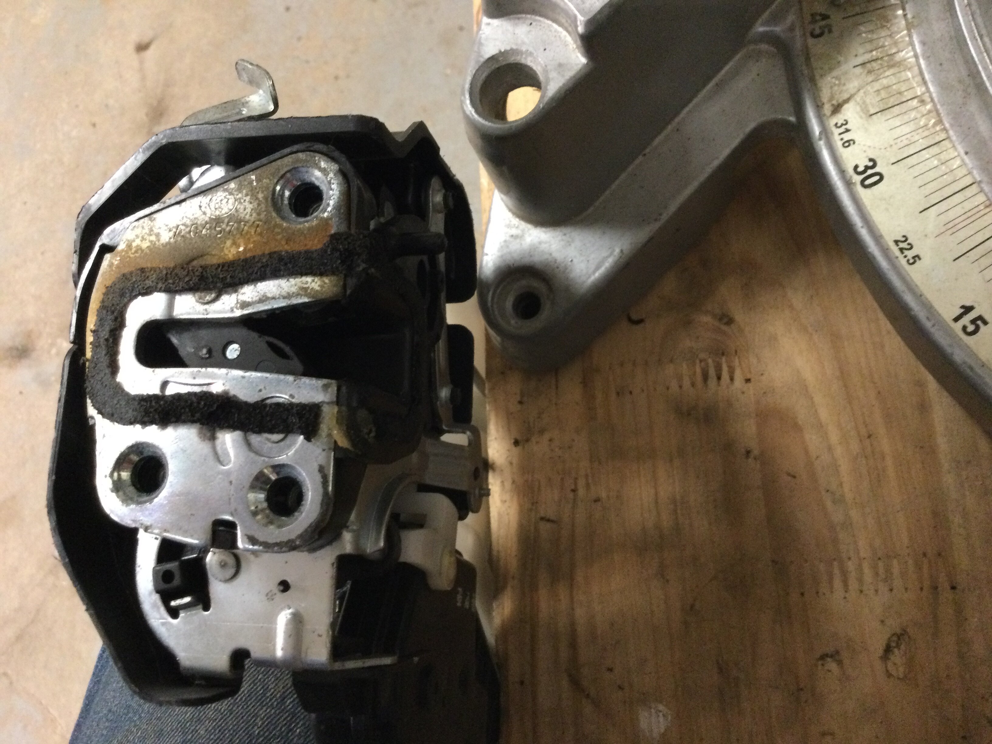

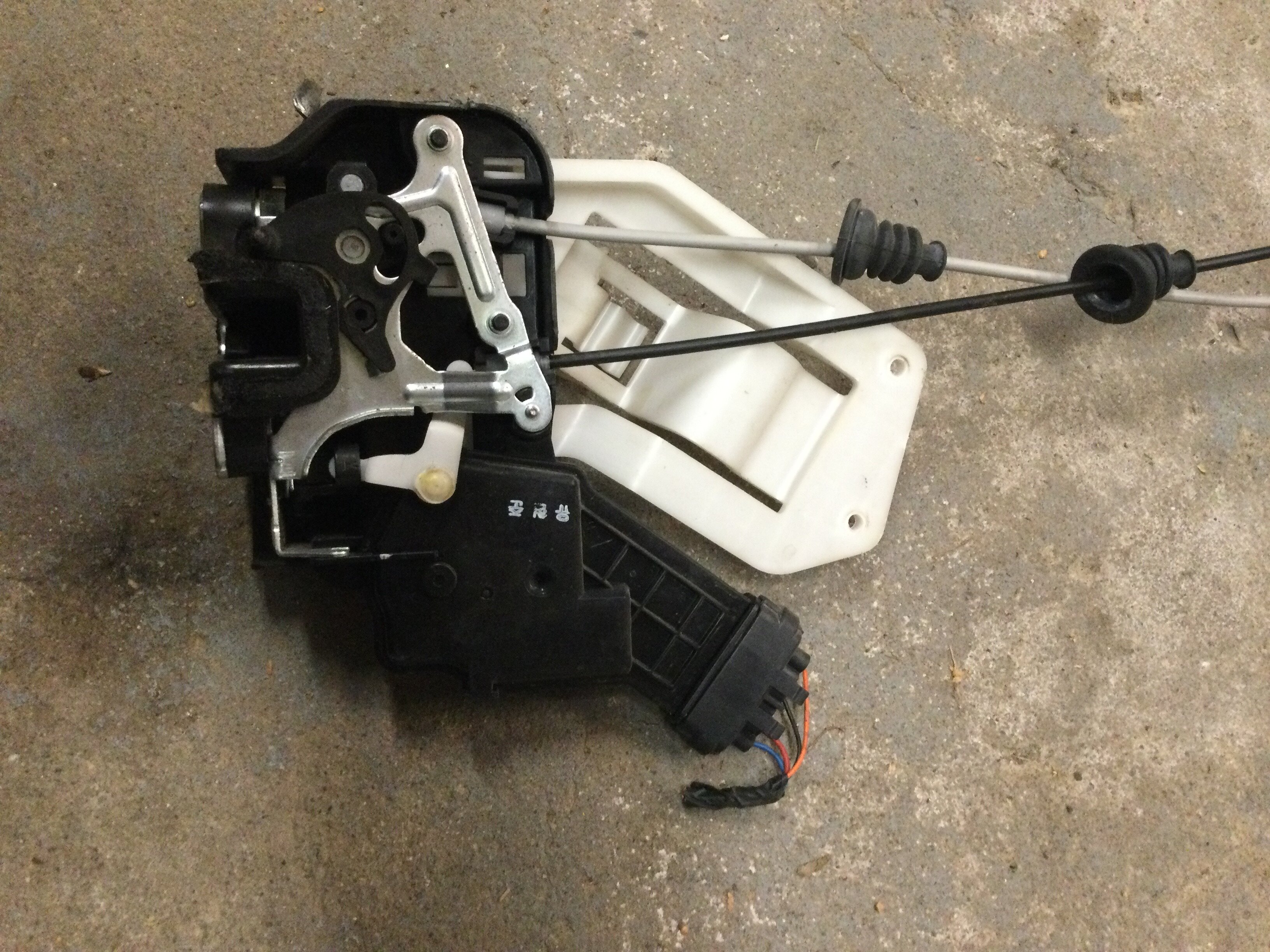

John/Horace Posted Wednesday at 01:21 AM Report Share Posted Wednesday at 01:21 AM Try lubing up the door latch mechanism. Cycling lock with door open, lock and then lift handle to unlock. There are springs and a few other pivot joints that can stick or not cycle in sequence. Solenoid moving isn’t the only thing occurring when door actually locks. Even cables like mentioned are part of assembly. Here is a pic of a door latch assembly off my daughters Kia rondo. A little finicky to change. Quote Link to comment Share on other sites More sharing options...
