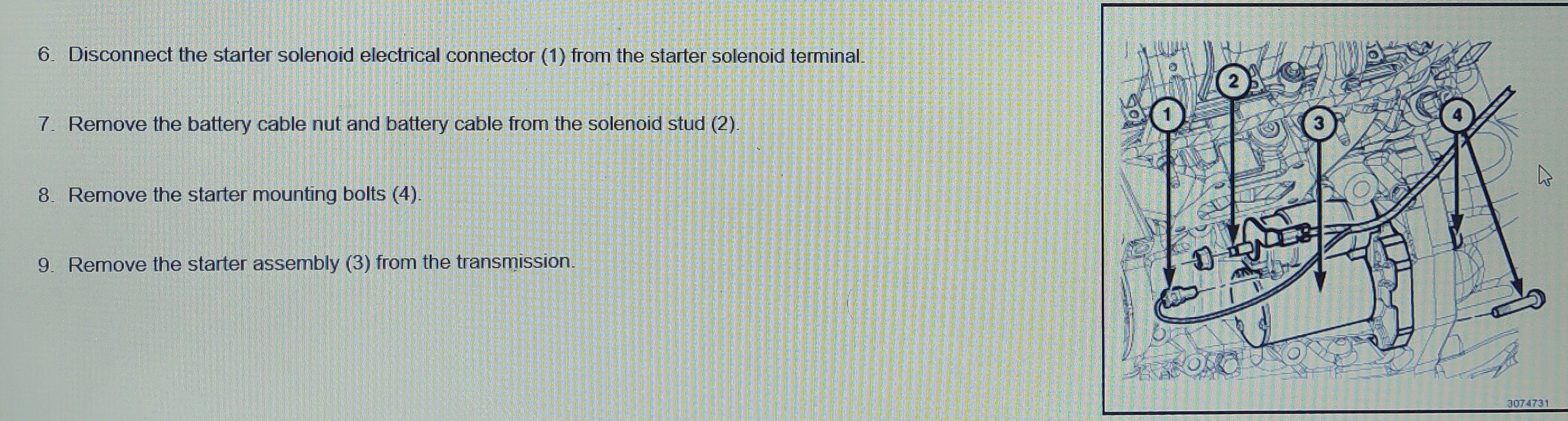

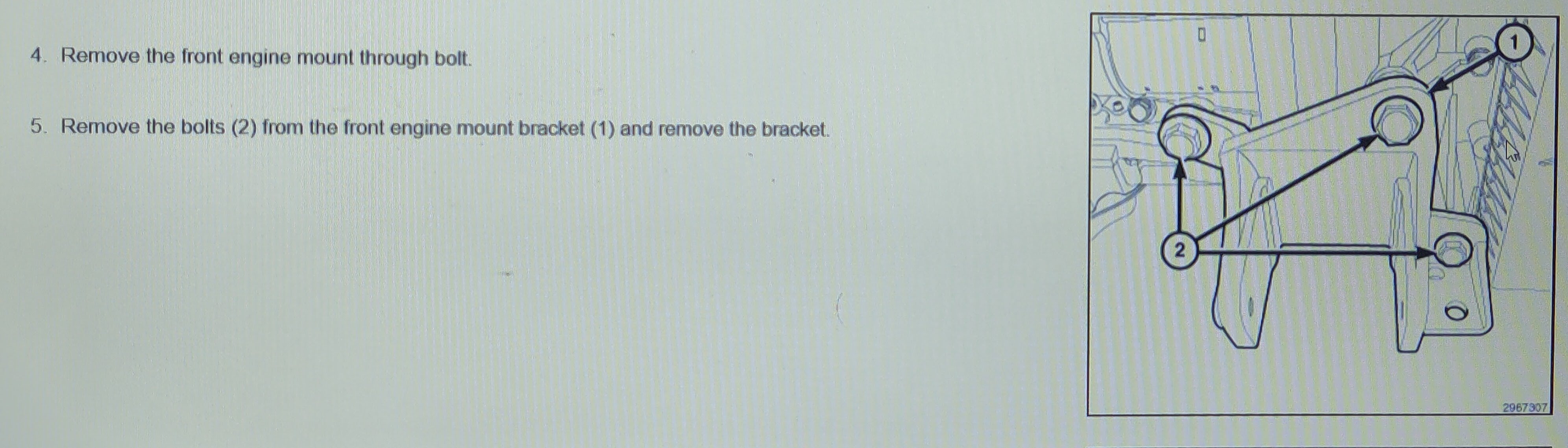

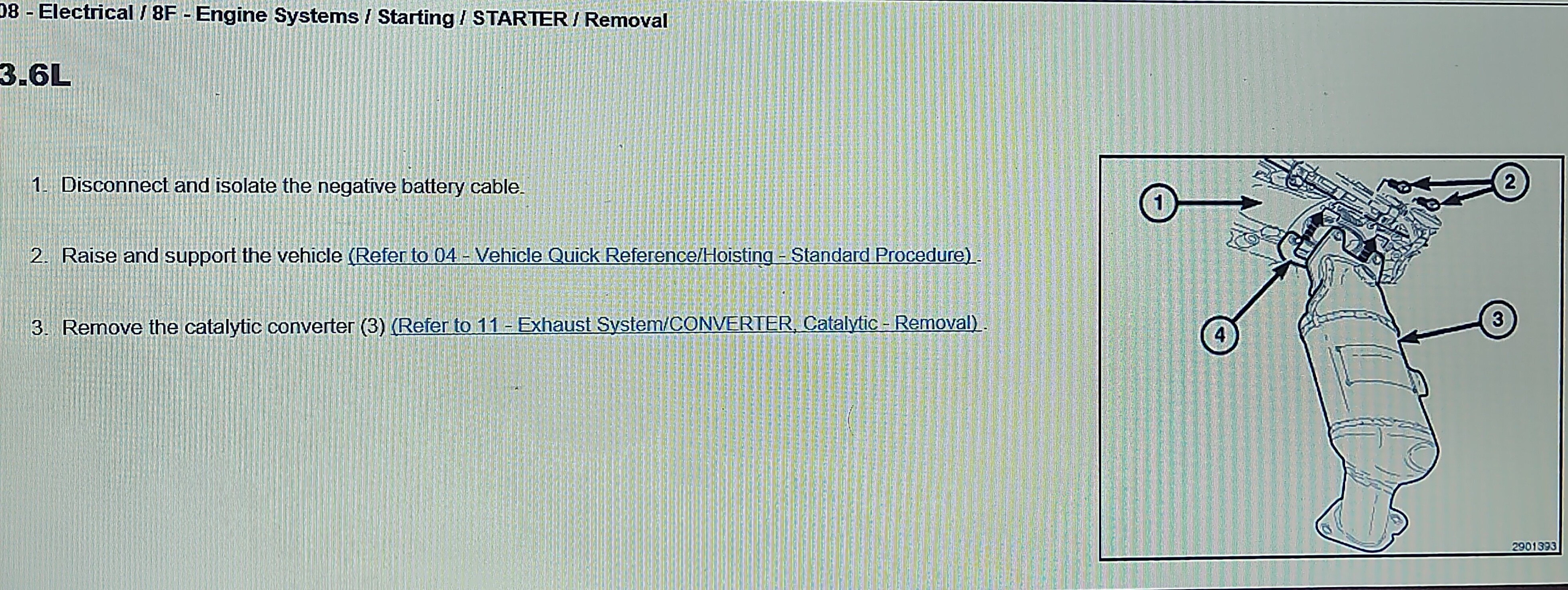

Dean H Posted January 7, 2025 Report Share Posted January 7, 2025 2016 DJ Service CD. Read my post after this one. Quote Link to comment Share on other sites More sharing options...

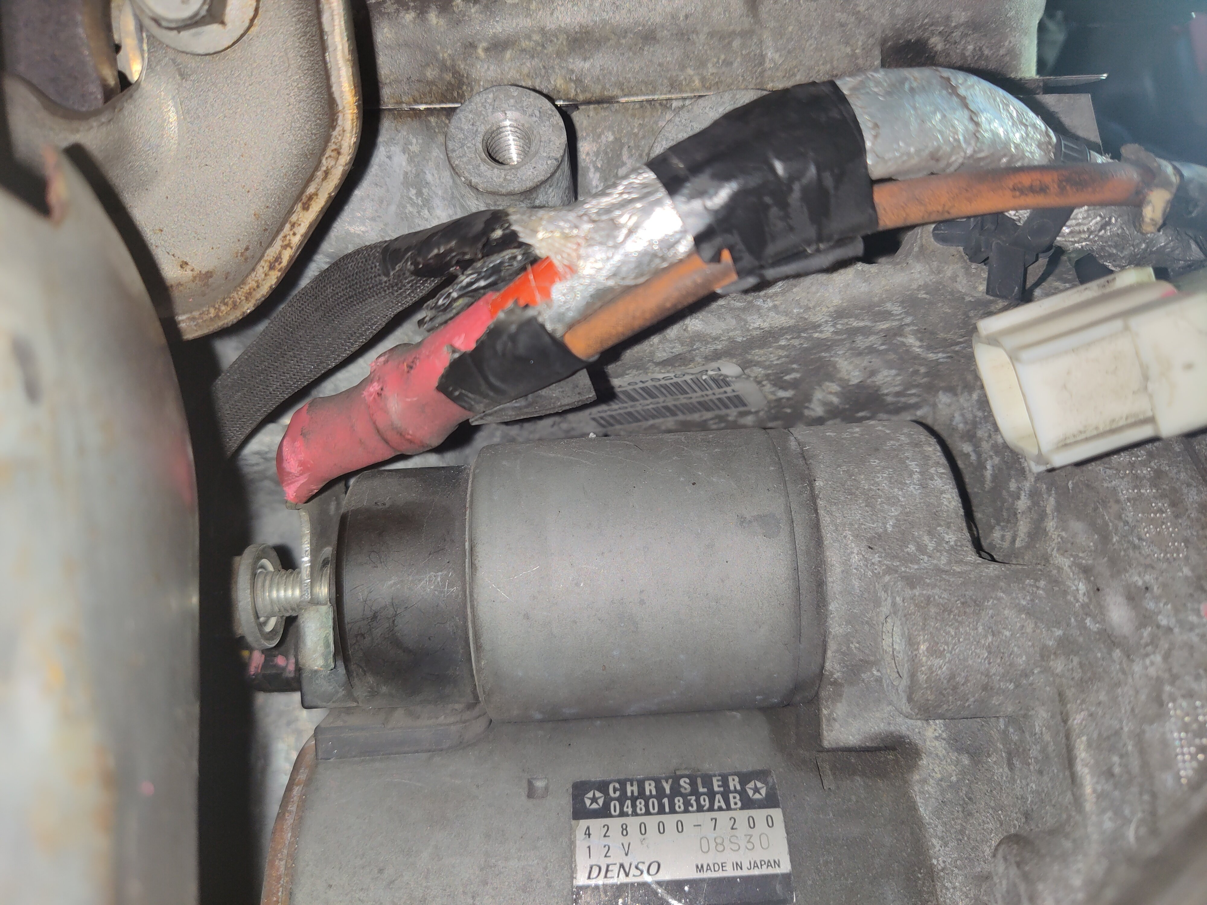

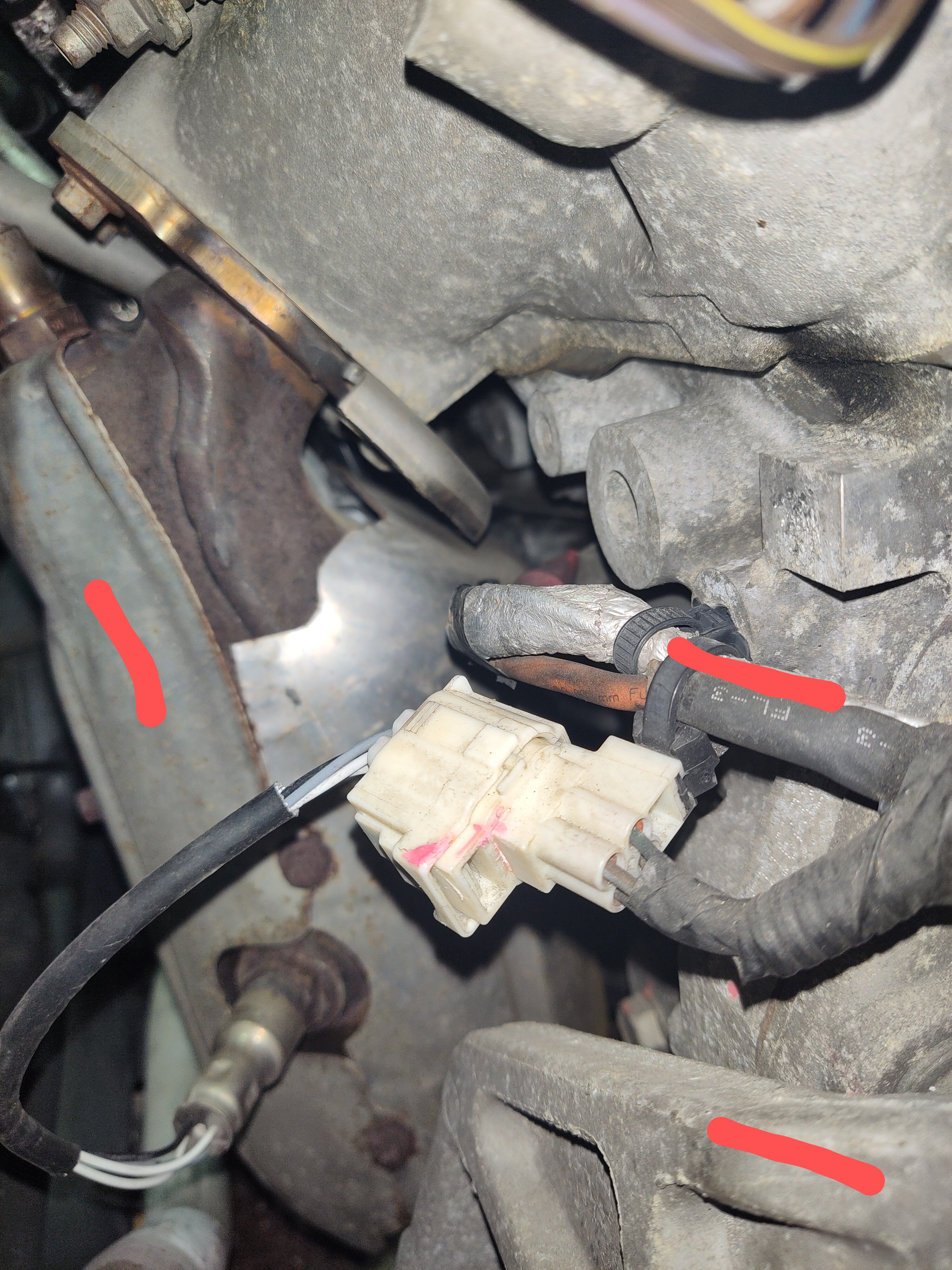

Dean H Posted January 7, 2025 Report Share Posted January 7, 2025 To replace the starter on a 3.6L. Everything you remove comes out from the top. The only thing you disconnect under the car is the catalytic converter flange bolts. Remove the front catalytic converter. Remove the motor mount bracket bolted the the engine. Located in front of the starter. The 2016 DJ service CD. Doesn't mention you have to support the engine before removing the motor mount bracket. You might have to remove the air filter box and air intake that goes up over the radiator. In this picture, I marked the starter cable, catalytic converter and the motor mount bracket. Quote Link to comment Share on other sites More sharing options...
