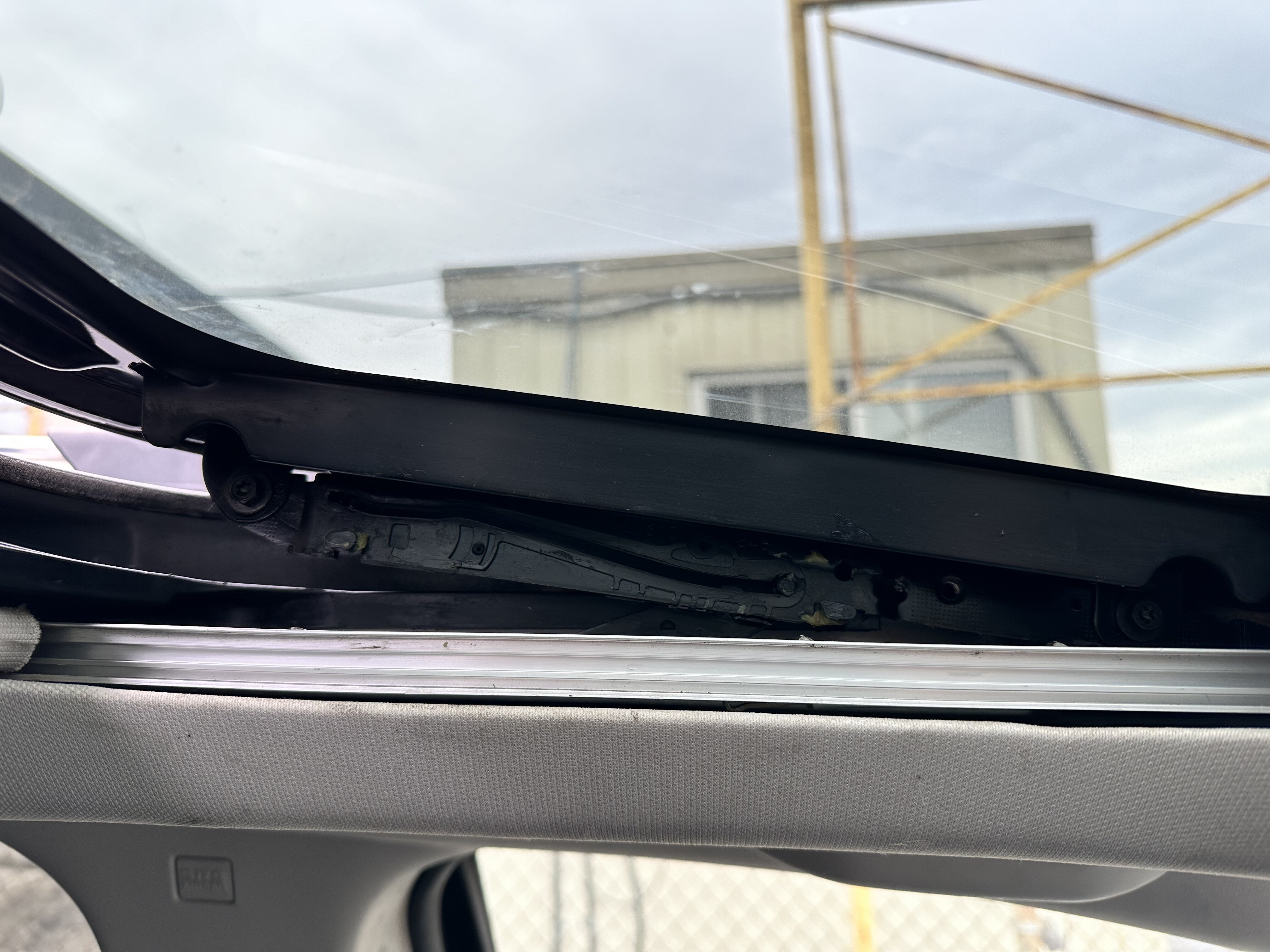

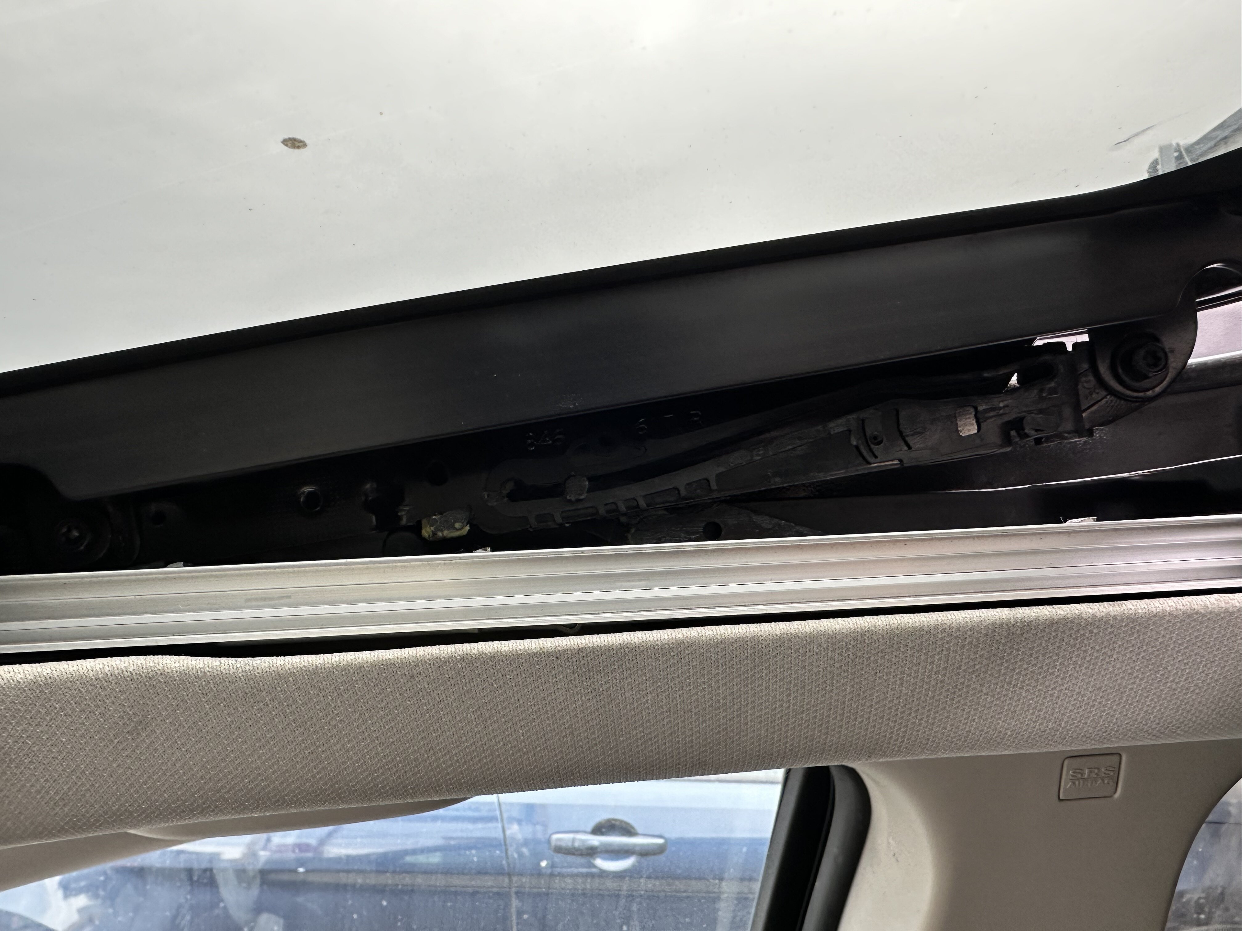

tdottrucker Posted April 23 Author Report Share Posted April 23 (edited) Update: I was able to figure out that this is the drain channel, I need to order a new one. But I found a more bigger problem that is causing a slight leak. My sunroof appears to no longer be calibrated and refuses to open. It opens in Vent mode no issue, and closes no issue. But trying to open, only the passenger side corner drops, I'll hear a quick series of taps that mimic a machine gun sound, then the sunroof stops and waits for you to close it. I can tell the driver side rear corner does not drop like the passenger side does and I believe it has something to do with the black clips that run along the guide. I am posting two photos of the sunroof in Vent mode. You will notice the clip on the driver side is all the way to the front of the guide where it looks like it shouldn't be as it pulled the sunroof a bit forward on the driver side, (little plastic circle) where as the one on the passenger side is not all the way at the front (in the proper position). What would be my best way to correct this issue? Edited April 23 by tdottrucker Quote Link to comment Share on other sites More sharing options...
