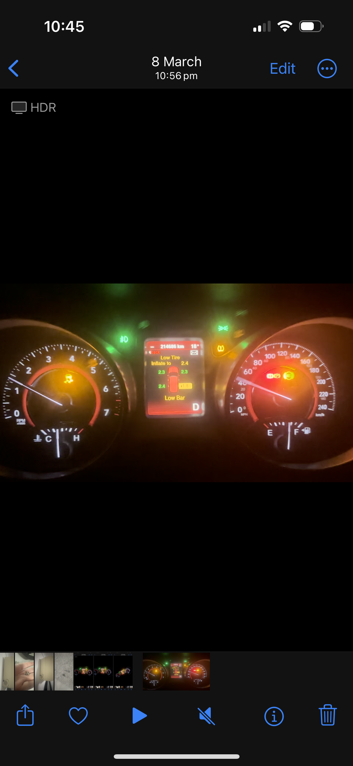

Kiara t Posted March 19, 2024 Report Share Posted March 19, 2024 Hi ! I have had my aircon fading in and out for about a month, I notice the lights dimmed at the same time my aircon would fade. Went to get this checked was told battery or alternator. new battery nope same issue, one week past now the stereo is going on and off, two days go by now the car turns off and dash board lit up like Christmas tree and the speedo is dropping (not the speed ) Turns car back on, all normal again days go by happens again, book in alternator. Now two days later it’s still happening, AND. Now my car alarm has gone off 6 times today ?HELP BEFORE I GO BROKE Quote Link to comment Share on other sites More sharing options...
larryl Posted March 19, 2024 Report Share Posted March 19, 2024 Could be a bad ground strap 2late4u 1 Quote Link to comment Share on other sites More sharing options...

Dean H Posted March 20, 2024 Report Share Posted March 20, 2024 I agree Larry. The Journey needs better ground cables from the chassis to engine block. First check and clean your stock battery ground system. Tighten all connections. These cable up grades will work. Battery, I went 2 gauge cable from battery chassis stud to engine block. Passenger chassis ground stud to engine block. 6 gauge cable. I would start here doing this. Dean Quote Link to comment Share on other sites More sharing options...
