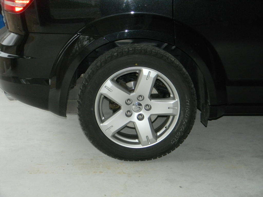

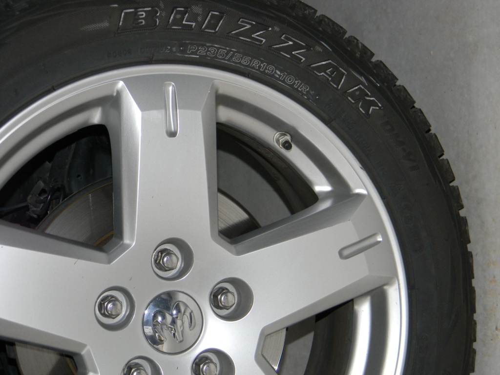

Winter tires are available for 19" stock rims
I have just put on a set (4x) of Bridgestone Blizzak's winters in a 'plus 1' size.
size is P235/55R-19 Blizzak DM-V1.
They fit fine. Even the spedo is not off by much.
They clear the front strut plate that the coil spring rests on by @ 3/8" (10mm).
Attached are 2x pictures of the tires on the vehicle (2010' R/T AWD).

So they fit without any problems? No rubbing?
No rubbing at all. and... I've put over 3000km on them so far.
Gone over some rough roads at speeds above what you should, and, they are not hitting anywhere.
