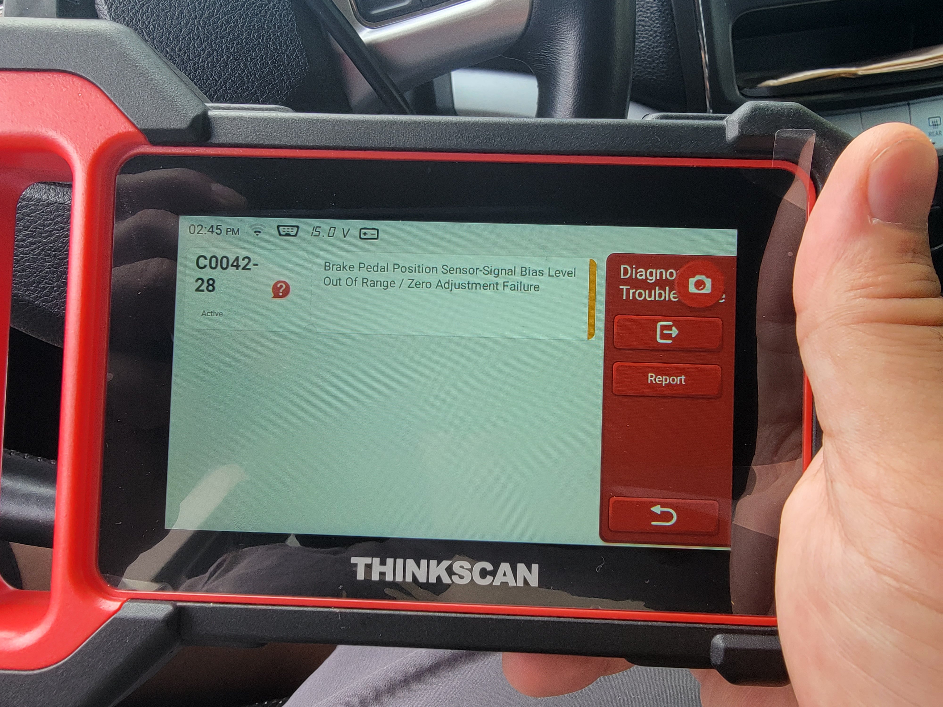

C0042-28
Jfirlotte1
 @therealjoethebro  Whenever the brake pedal position sensor is removed and reinstalled or replaced with a new unit, it is necessary for the Antilock Brake System (ABS) module to calibrate the reinstalled or the new sensor. Follow the programming steps outlined in the diagnostic scan tool for the “ABS Initialize” routine under “Miscellaneous Functions” for the “ABS Module” menu item as appropriate.
