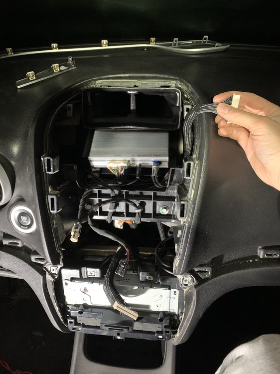

Lastly, I attached a pic I took of the module installed in the spot behind the UConnect display that you had pointed out. Maybe this is helpful to someone else planning to take up the challenge.
Oh, and one more very basic question: how did you manage to attach the lower part of the A/C unit to the console again with the two metal clips? Somehow, they keep falling out for me.

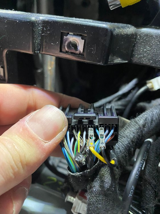

They need a lot of improvements... manual is one. After a lot of chat with them, told the I gave up on trying to connect to the original microphone.
On the spot they sent this picture.. I told them they should provide clear instructions.

I asked ENG-Custom about where the two plugs when too. The manual is NOT clear. Which plug is that? The one that is in the back of the stereo? Where you able to get the backup camera to work in CarPlay or do you have two switch to Uconnect. Mine does not automatically switch between CarPlay to Uconnect. They do have a two year warranty, no offer to exchange? Maybe firmware will fix the problem ?‍♂️

That plug is in the back of the radio.

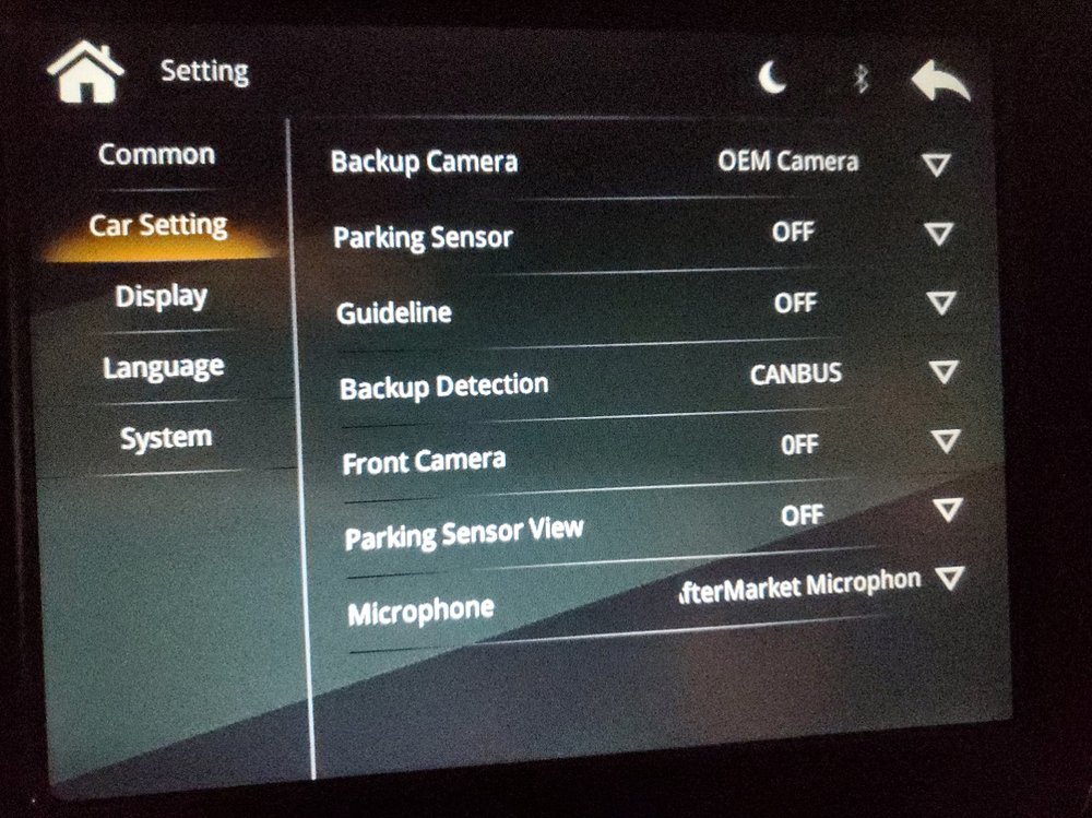

My camera shoes always on screen. Make sure your settings are like the picture for the camera.

That dude from ENG-Custom is a funny guy! He sent me the exact same picture when I was inquiring about the backup camera as mine won’t activate during reverse either.
I hooked these two cables up to the cable string that goes in the bottom right of the radio unit (see highlight on attached pic!) but it still won’t work! He will send me a software update within the next days he said including a video with instructions. I will keep you posted and will share the video when I get it.
As for your sound issues, @Jim B n Texas: Have you disconnected the UConnect Bluetooth and connected to the one of the ENG-Custom module?
This is crucial to have sound coming out of CarPlay!
