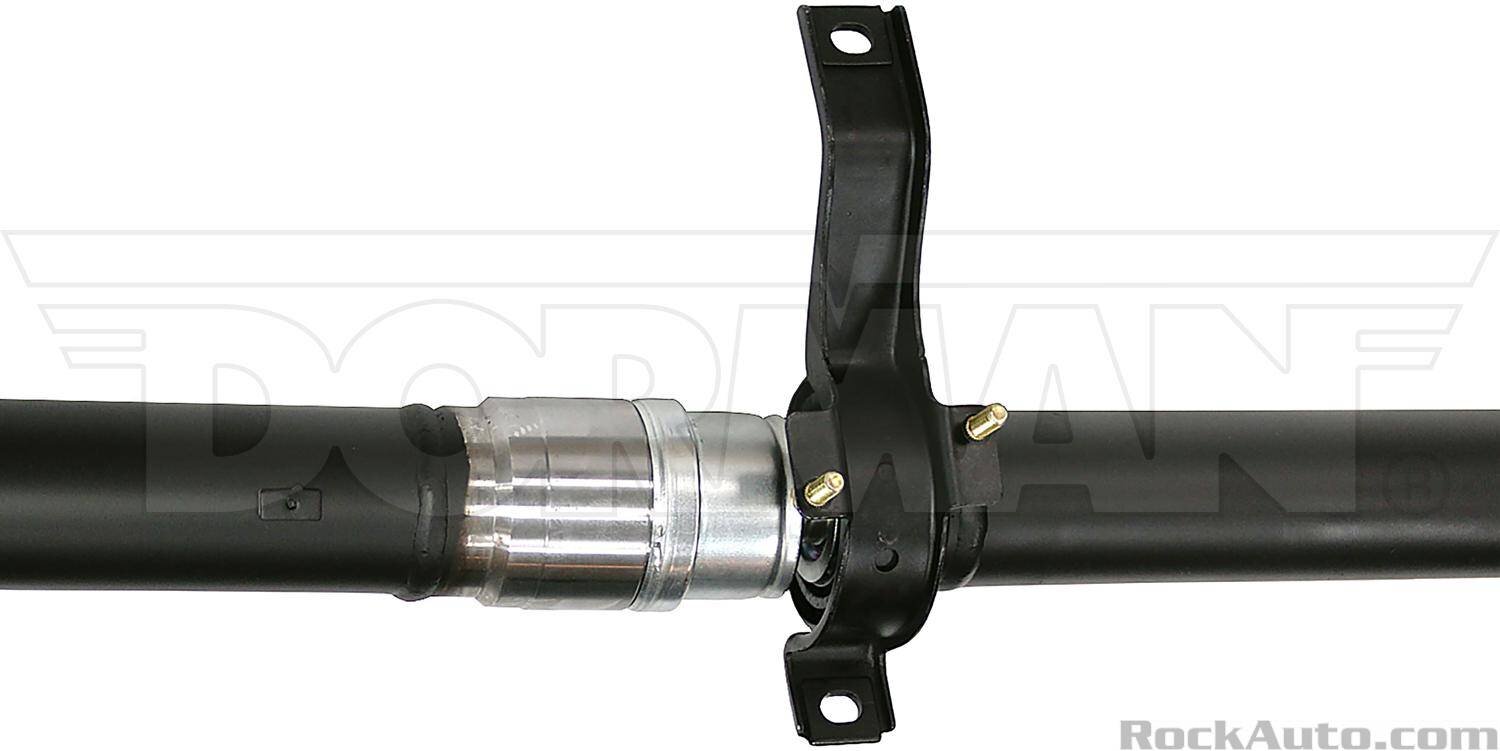

John/Horace Posted December 13, 2024 Report Share Posted December 13, 2024 There is no listing for a hangar bearing part on places like Rockauto, biggest on line site. Most drive shafts have to be bought as a full unit now. Rubber Flex coupling is available only. There are a few aftermarket shafts made. Used unit from auto wrecker is an option. New oem is very expensive and out of stock shown on Mopar Canada etc. https://www.rockauto.com/en/catalog/dodge,2014,journey,3.6l+v6,3300354,drivetrain,drive+shaft,2308 Quote Link to comment Share on other sites More sharing options...

John/Horace Posted December 22, 2024 Report Share Posted December 22, 2024 Curious where you got carrier bearing and support. Original poster didn't follow up. The Cordone shaft listed on Rocka is a reman shaft. So somebody is doing it somewhere. I was able to rebuild shafts on jeeps I had years ago, but beefier designed u joints and easily changed. Quote Link to comment Share on other sites More sharing options...
