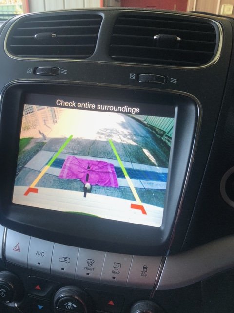

Hi All,
long time since I have posted here (apologises) . Well last week my reversing camera decided to invert the image or just show lots of black lines. So after checking out youtube decided to replace it myself. The boot lid cover is a bit of a pain to get off, just go slow there are about 12 clips that need to be popped off the body.
I ordered this camera from ebay Australia(may be cheaper in USA)
https://www.ebay.com.au/itm/195518343909
and now my camera looks like this
Happy day.

:)           Please report back if this soles your problem mine was covered under my ext, warranty and they said it was the camera causing the problem like you are describing, i didnt think the camera would case the problem but it did fix my
