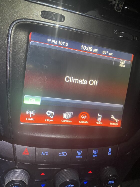

Spifficult Posted September 14, 2022 Report Share Posted September 14, 2022 I have a 2019 journey that I've had barely a year. Most of the summer it was fine, but the past few weeks the climate control will turn on by itself. A lot of the times, I push OFF and it comes right back on. I believe I have the manual dual zone. Today it was 66°, not humid, and it did it about 8 times in a row. Only while driving,not while parked or sitting still. Of course the manufacturer warranty ended last month. Quote Link to comment Share on other sites More sharing options...

Spifficult Posted September 14, 2022 Author Report Share Posted September 14, 2022 7 hours ago, CBD said: Do you have controls for the rear vents in the head liner? If so, you have to make sure that is off as well. If that is on it will keep turning the front controls on. Shortly after I posted this my car made me a liar. I was sitting in the parking lot with my car running and it turned itself on. Shut the back off with the back headliner control and still did it again. I'll see what happens on my next drive that's longer than 5 minutes. Quote Link to comment Share on other sites More sharing options...
