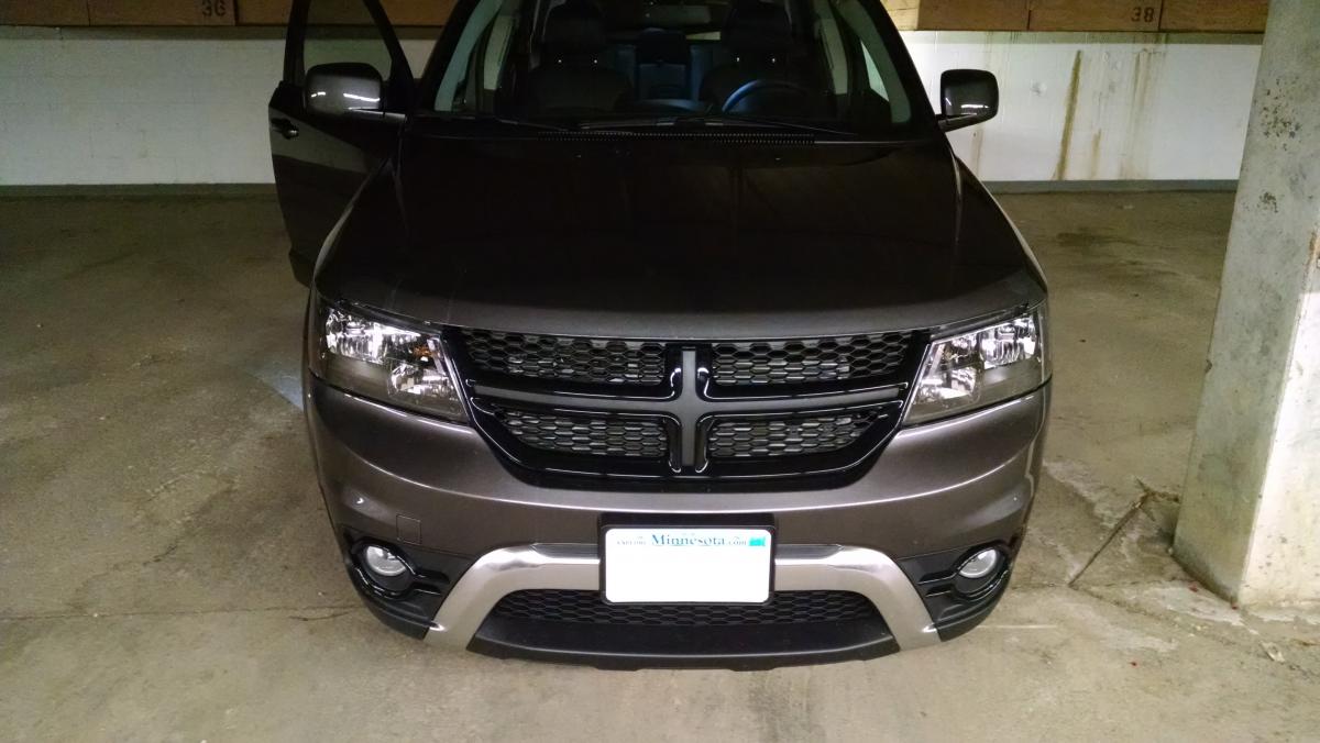

I have a 2015, I removed the emblem to see what it would look like. It really only took about 5 minutes to remove. If you loosen the grille by removing the black rivets on the top of the grill in the engine bay you can pull the grille forward enough to slide your arm down. The badge itself has 2 prongs that stick out the back. There are washer like parts that all you need to do is twist counterclockwise about half a turn and the badge will slide right off. If you plan to keep it off you could easily cut off the small molded plastic pieces to completely eliminate the brackets. I attached a picture with the badge removed but with the brackets still in place. From a distance you can't even see the little brackets.
post-10704-0-62064100-1431034174_thumb.j
They stick out like sore thumbs... I couldn't handle it personally. I suppose cutting it off is an option, but I chose to just black mine out as your never sure what the finish will be after cutting plastic. It is the only badge on my DJ, so I can deal with it.
