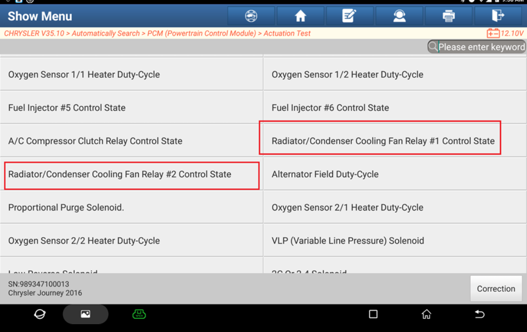

Dean H Posted July 14, 2025 Report Share Posted July 14, 2025 (edited) My 16 DJ 3.6. Temperatures - Degrees Fahrenheit- outside air - 75 Coolant - 198 oil - 172 transmission - 132 Max AC on high. --------------- I would get your Journey scanned with a bi-directional code scanner. Even if you have no lights lit up on the dash. List everything you find. Using that bi-directional scanner you can activate and test the radiator cooling fan. High and low speeds. As shown below. Edited July 14, 2025 by Dean H Quote Link to comment Share on other sites More sharing options...
