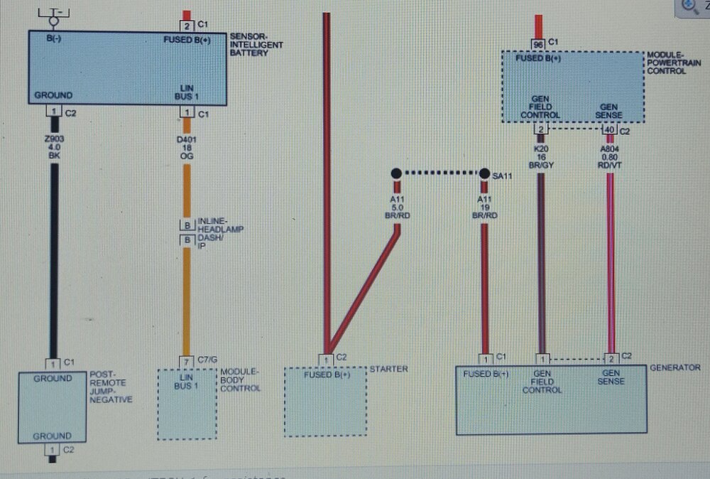

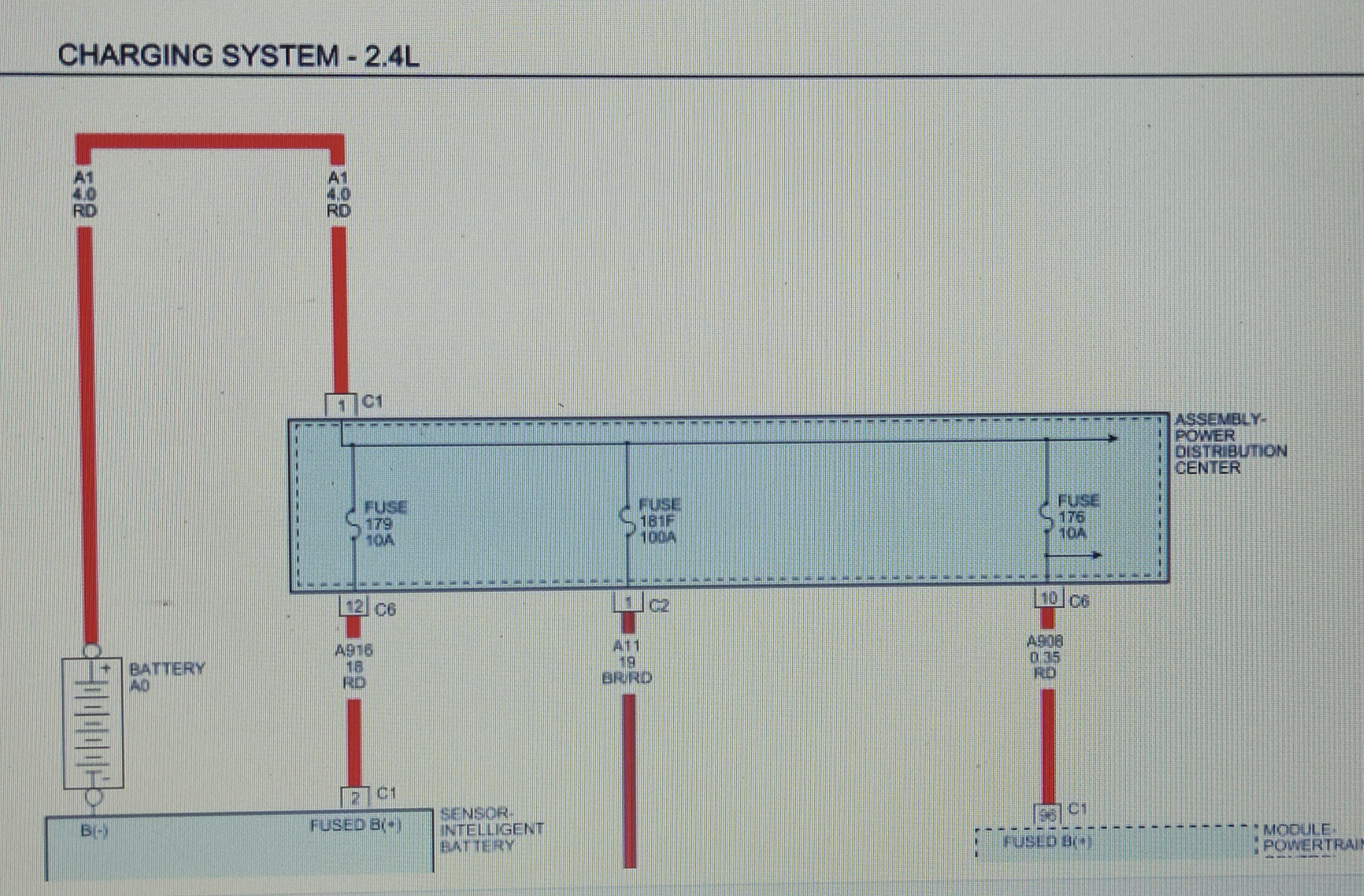

Yogitech1 Posted April 16, 2025 Report Share Posted April 16, 2025 New alternator, after a month it quit charging. I took the alt out and had it tested, it tested good. I have a Dodge Journey SE 2.4 L. Does anyone have the schematics for the charging system so I trace this POS out and find the problem? Quote Link to comment Share on other sites More sharing options...
Dean H Posted April 16, 2025 Report Share Posted April 16, 2025 (edited) 2016 2.4 L. Here is a post, I made with Dodge service information. Read the entire thread. https://www.dodgejourneyforum.com/topic/18296-charging-system-101-with-diagrams/ Edited April 16, 2025 by Dean H Quote Link to comment Share on other sites More sharing options...
Yogitech1 Posted April 17, 2025 Author Report Share Posted April 17, 2025 4 hours ago, Dean H said: 2016 2.4 L. Here is a post, I made with Dodge service information. Read the entire thread. https://www.dodgejourneyforum.com/topic/18296-charging-system-101-with-diagrams/ All the wires are good so I tweaked the connectors to the ECM. Now the ignition won't recognize my key fob although it works fine on the locks. Quote Link to comment Share on other sites More sharing options...
