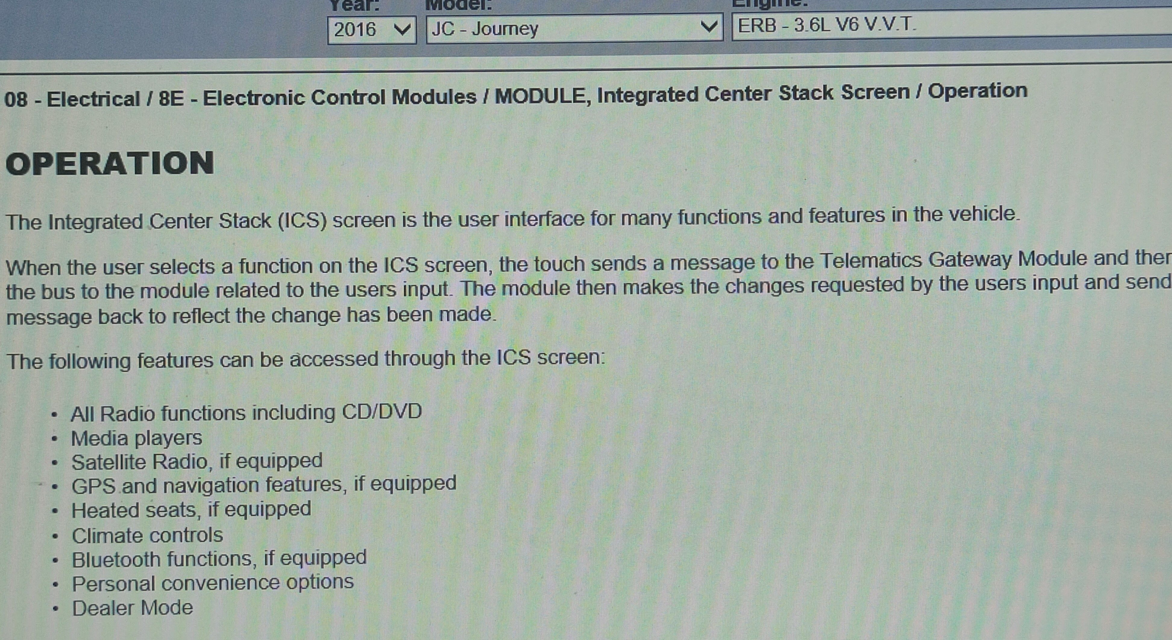

Dean H Posted June 2, 2025 Report Share Posted June 2, 2025 (edited) TGW module information - Touch screen - Edited June 2, 2025 by Dean H Quote Link to comment Share on other sites More sharing options...
COsxt Posted June 2, 2025 Author Report Share Posted June 2, 2025 Thanks for the diagrams. It’s weird that some sites/ places label the radio unit as the telematics gateway module. There is an actual telematics gateway module located somewhat behind/ under the steering wheel. But I’ve also read that that module is responsible for Bluetooth communications more or less. I’d think I can rule out the radio unit as I tried a replacement and had the same exact issues. I’m leaning towards the touch screen/ ICS. Quote Link to comment Share on other sites More sharing options...
