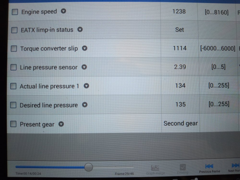

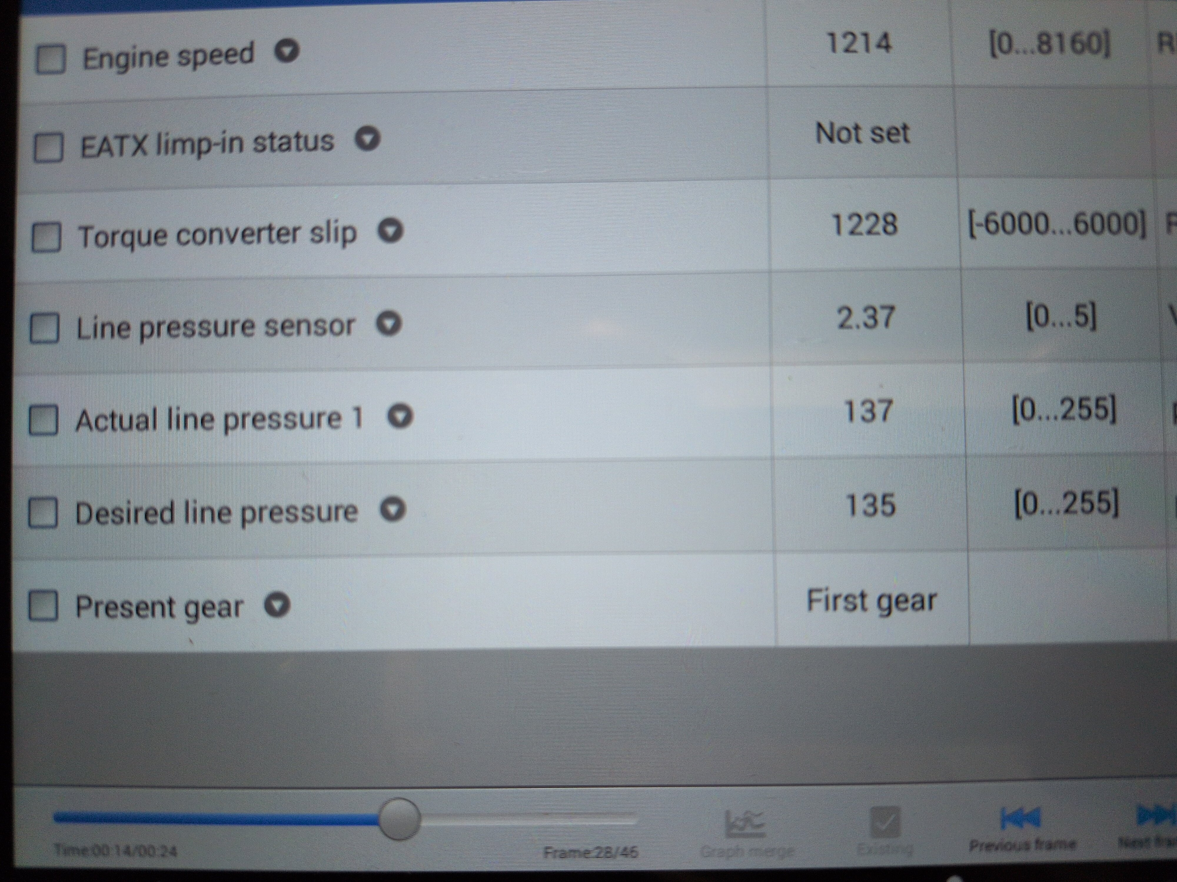

P0845
Lee Craftsmen
2014, 2.4L, 41TES. New torque converter, master rebuild kit, New 2-4 piston assemble, New solenoid pack. Cleared vlp counts all. Fails quicklearn. Shifts into all gears with good pressures and voltage at idle. Goes into limp mode when I brake torque it in any forward gear or just drive it. Pressures and voltages do not drop. So I bought a rebuilt valve body with all the sonnex updates. Did not fix the issue. Any ideas?
Thanks, Lee
