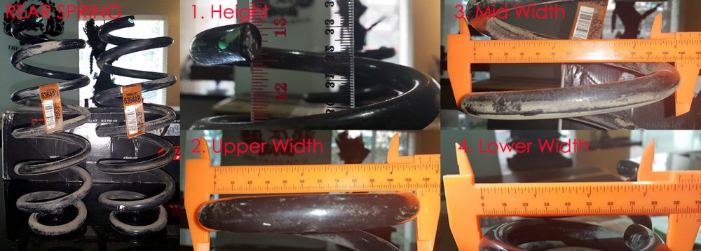

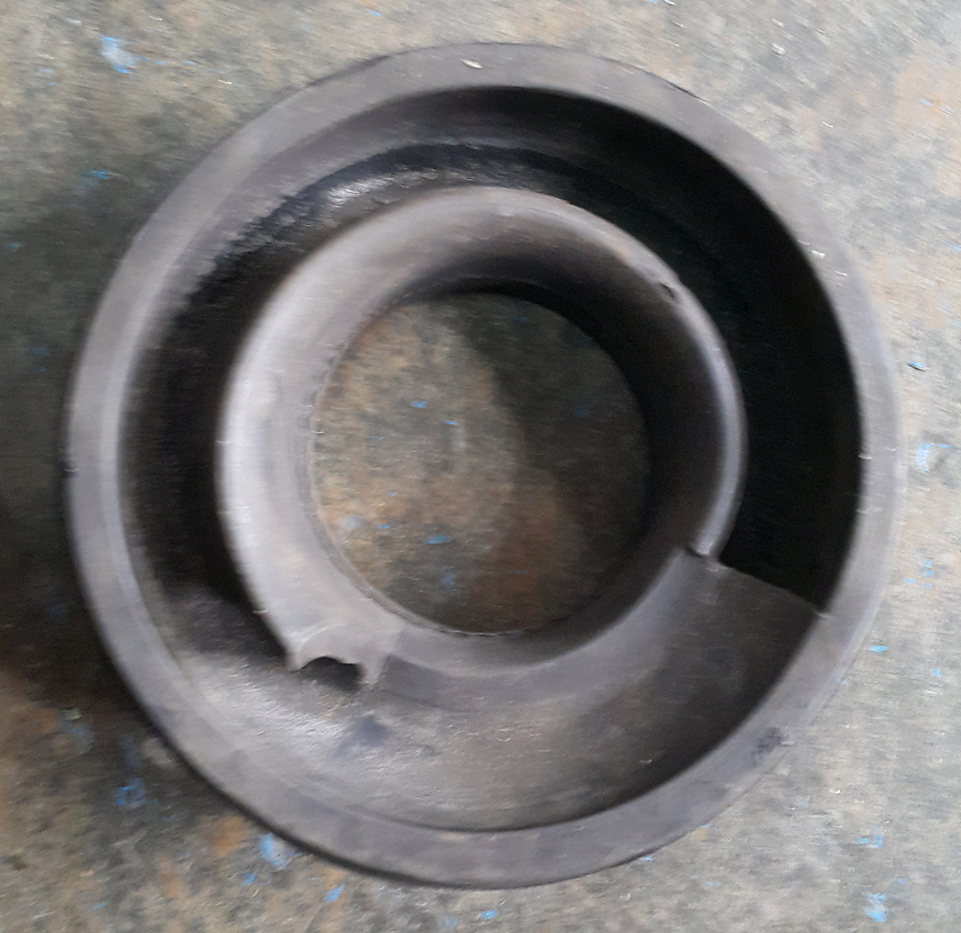

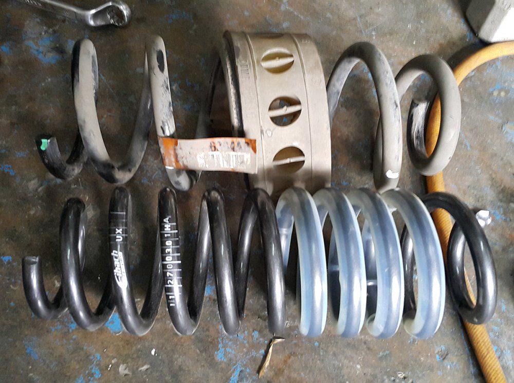

I came across these springs at my local wheel shop. It is the Eibach Pro Kit for 2008-2011 CRD DJs.
Had told the owner of the mix info regarding the fitmen issues. But he suggested to try it and if does not fit then am not obliged to pay them.
Anyone in this forum that had ever tried those kit? My DJ is a 2014 SXT 2.4 FWD.

Hi guys.. this is the update.

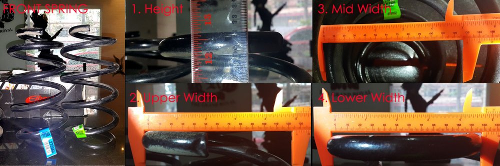

Firstly the front springs fit nicely without any issues. Not sure if I could recommend this for the 3.5/3.6L engine as logically it is heavier.

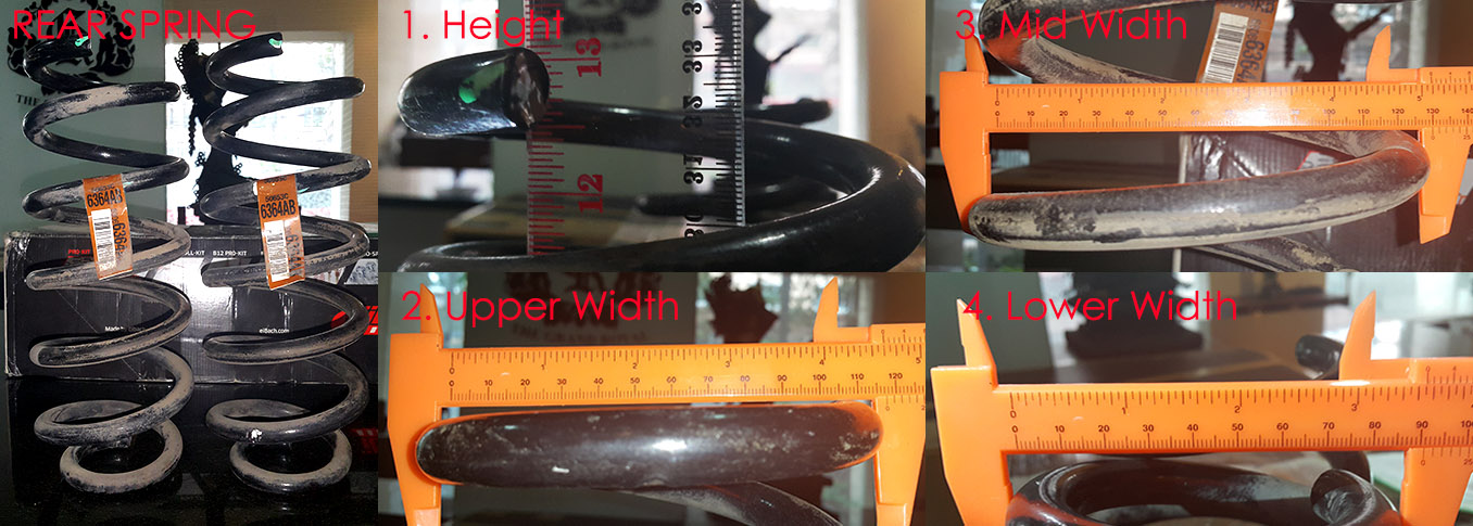

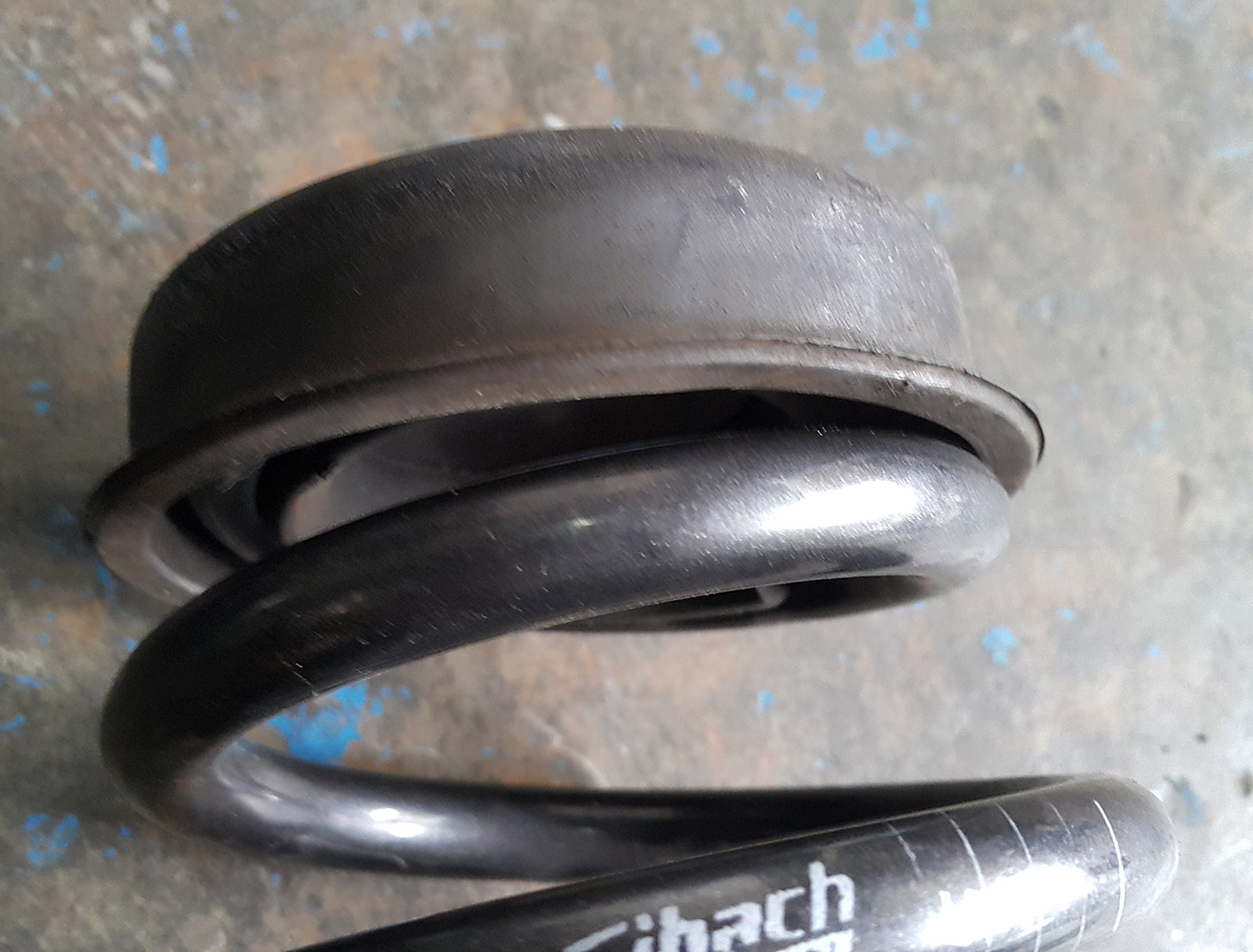

The problem comes with the rear springs where the upper end of the original springs are slightly larger in diameter. The lower end fits but not the upper end. Due to the size differences, the upper end of the Eibach could not fit into the original spring seat/boot (not sure if the term is correct). Again, am not sure if the rear suspension are the same and applies to other DJ model. Wondering whom had tried H&R kits and face similar problem?
The store owner told me there are two ways to fix the above. First by finding a spring seat/boot to fit into the upper strut mount (which I think is non existence) or to modify the upper end of the Eibach to fit. It was a call that I had to gamble. Since the diameter gap was minimal I did the latter and that, thankfully, did the job! What boggles me is why Eibach didn't just revise their design to fit the 2011+ models?!?
In any case, I haven't had enough time to test it. But base on initial impression, it handles well when stopping and acceleration. Yes it is on a stiffer side yet absorb bumps and uneven surfaces quite nicely. I think this matter is subjective to only my opinion and may differ and debatable to others. The looks is also perfect!
