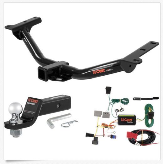

I am also curious what PN BrianS used and if it is a 4 PIN or 7 PIN. My dealer says I can only use the 7 PIN connector on mine even though I DO NOT plan on towing anything that heavy to warrant a 7 PIN. IN either case the CURT hitch and wiring harness has been ordered and on its way (all under $200)...not too worried about the hitch itself, just the wiring working out correctly.

So I installed my Curt hitch and am going to install the Curt wiring harness tomorrow, unless I can confirmation and a hold of the correct harness to plug into the pre-installed wire.
After install I started measuring the hitch height and it is 13". With the 2" drop on the ball mount it seems like it is going to be sitting pretty low. I am curious what the height of other DJ owner's hitch? Has anyone out there measured and/or had any issues? I am used to my hitch being in the 17" area (height off the ground). Am I overthinking it? Anyway, picture attached...I like the look, hope the performance is as good.
Yea it's low, I flipped my 2" drop around so it would raise it 2" instead.

just measured mine on my 2014 crossroad with the curt hitch.... 13 inches. i use mine for a carrier basket for my wife's 3 wheel scooter it does drag a bit on a steep entrance or exit so i just angle off when i see one of them no big problem tho. just go with the curt wiring, a lot less problems then OEM that is  what i will do if i ever need the lights....
